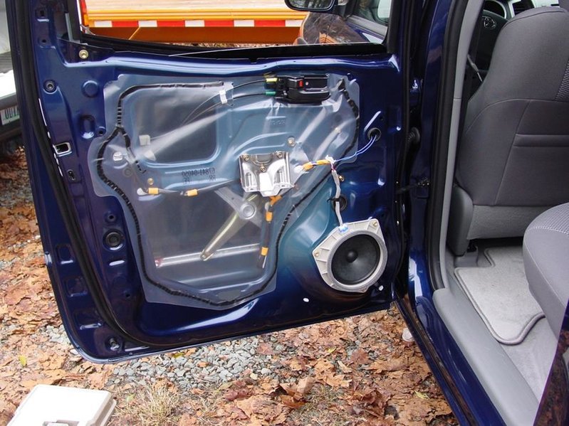

    Here's a pic of how the rear door will look like once the panel is removed.
    I plan on doing this project myself in order to save money and I will take some pics and post them in this thread for future reference.
