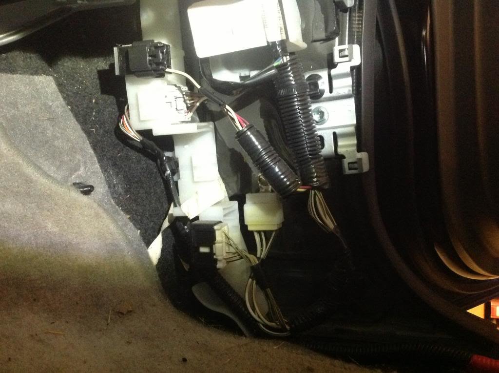

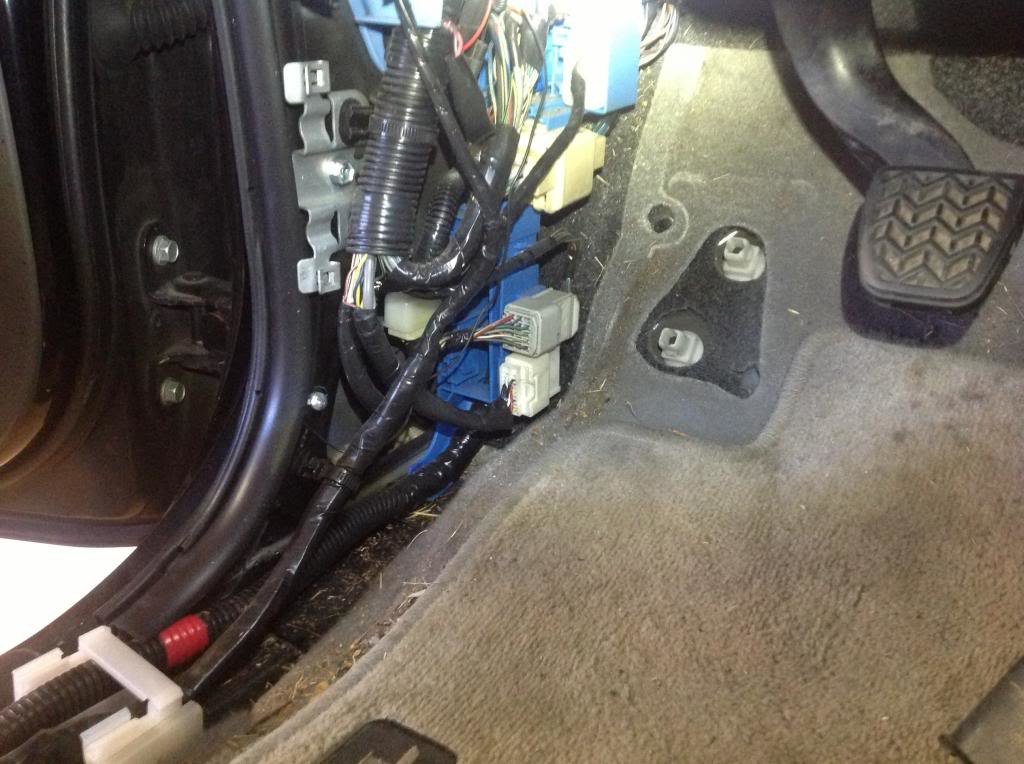

    This thread has bee very helpful. I did my base 2007 4x4 yesterday and found some differences. When I pulled the radio to add the speaker wires, I noticed they were already installed! So then, the hunt for the loose ends began, thought I would share what I found.
    On the drivers side, the wires are yellow and black (black positive based on the information from the OP) and they terminate in the bottom of the white plug shown near the bottom behind the drivers kick panel. The speaker wires are slightly larger in diameter than the other wires in the connector.
    The passenger side wires are red and yellow (red positive) and the terminate behind the passenger kick panel. They are the only two wires in the black comnector seen near the top left of this photo.
    This forum has been very helpful to me over the past year so I figured I should join and post what I found.
