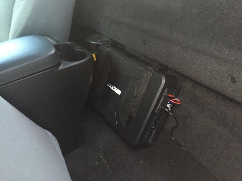

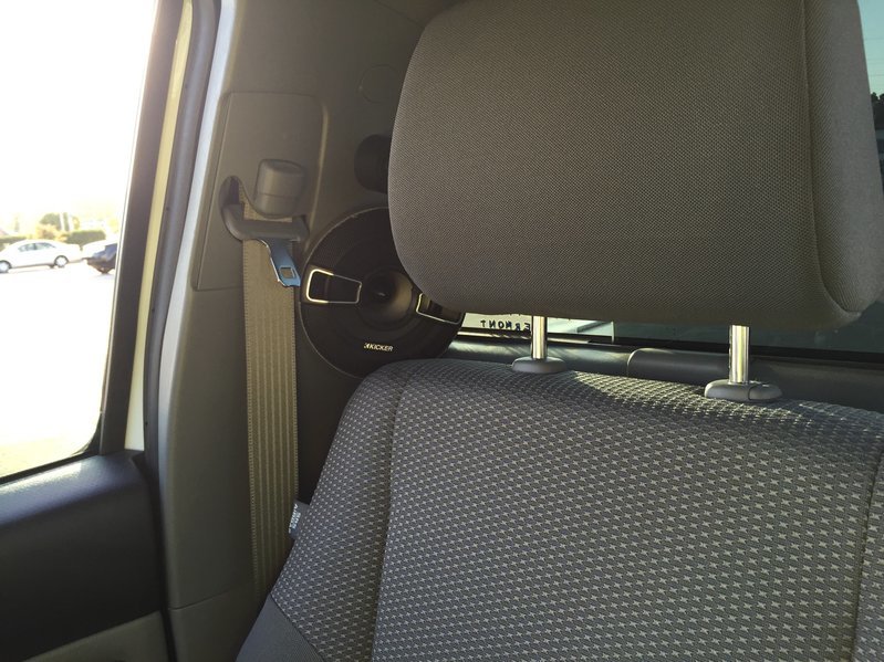

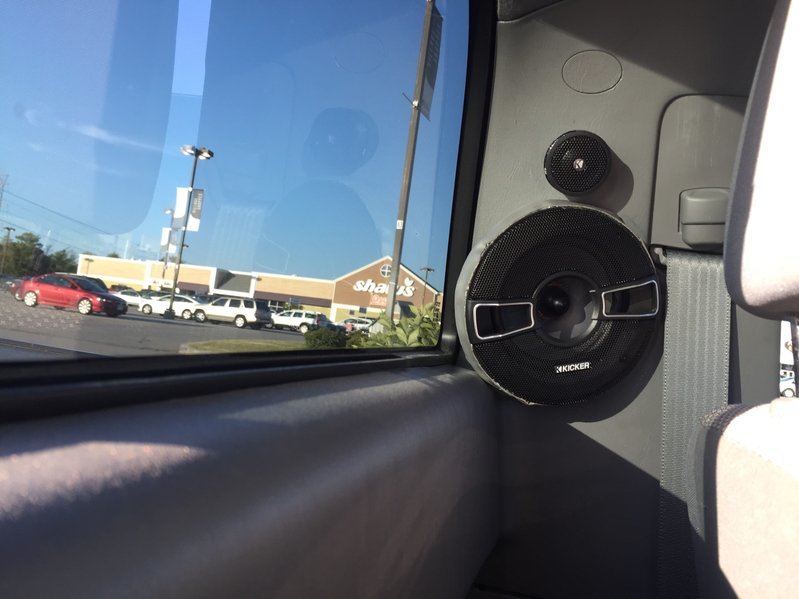

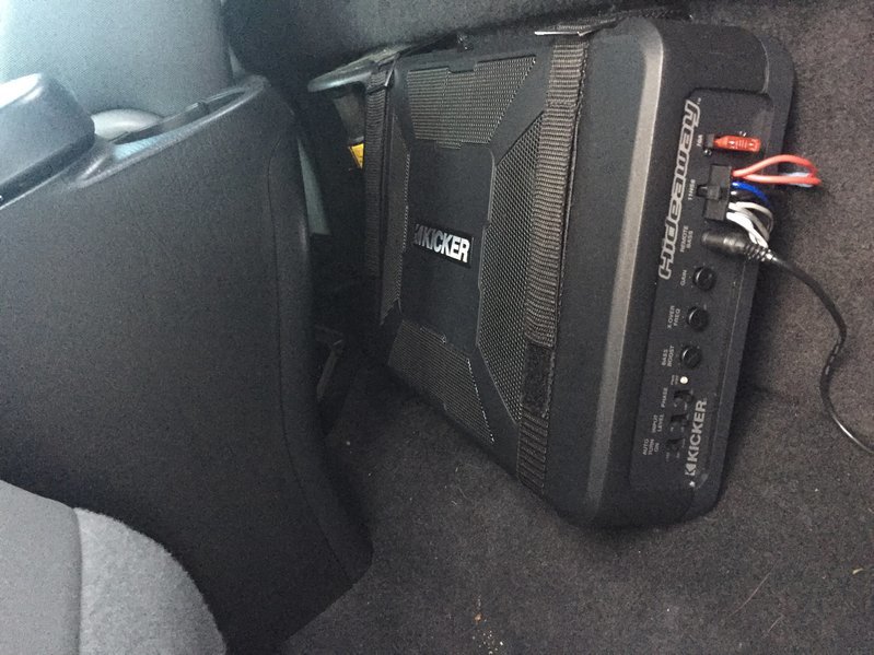

    Just added a kicker hideaway sub and it sounds awesome. The sub is a self powered one and its the best I ever had. I put 5 and a quarter speakers mounted in the rear. I highly recommend this sub!!

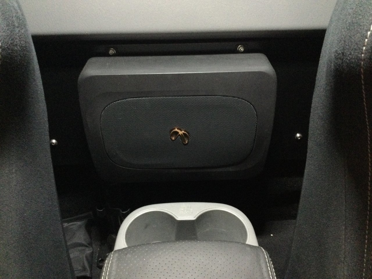

    Hmmm… Why rear speakers⁉️ How about just one❓

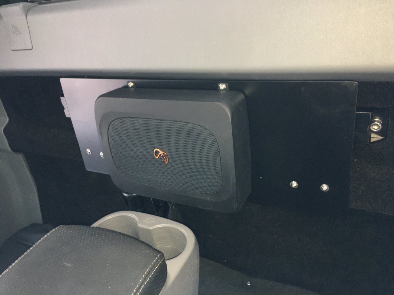

    Believe it or not the .250 wall 6061 aluminum plate & 1x2” rectangular bar was stitch welded by a friend and are powdered coated in flat black. It’s attached with 4 6mm & 2 10mm rib nuts in the back of the cab. I was going to install 2 more 10mm rib nuts but it’s solid as a rock. So the little Infinity 8” self powered sub kicks! My installer had to turn the sub way down as it overpowered the door separates!
