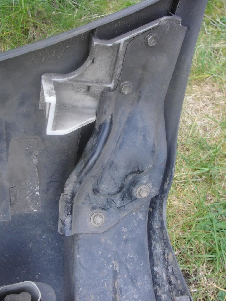

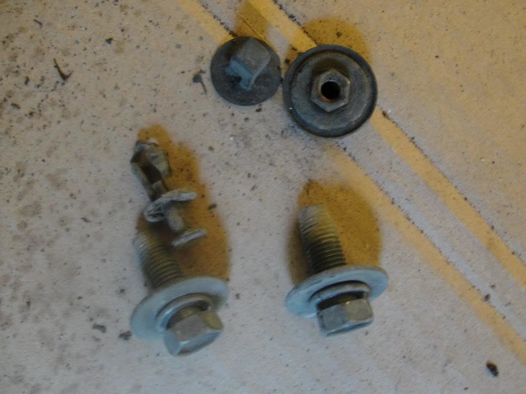

    There are four clips/bolts on each side
    This is what is taken off of each side

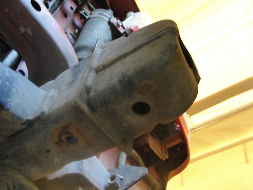

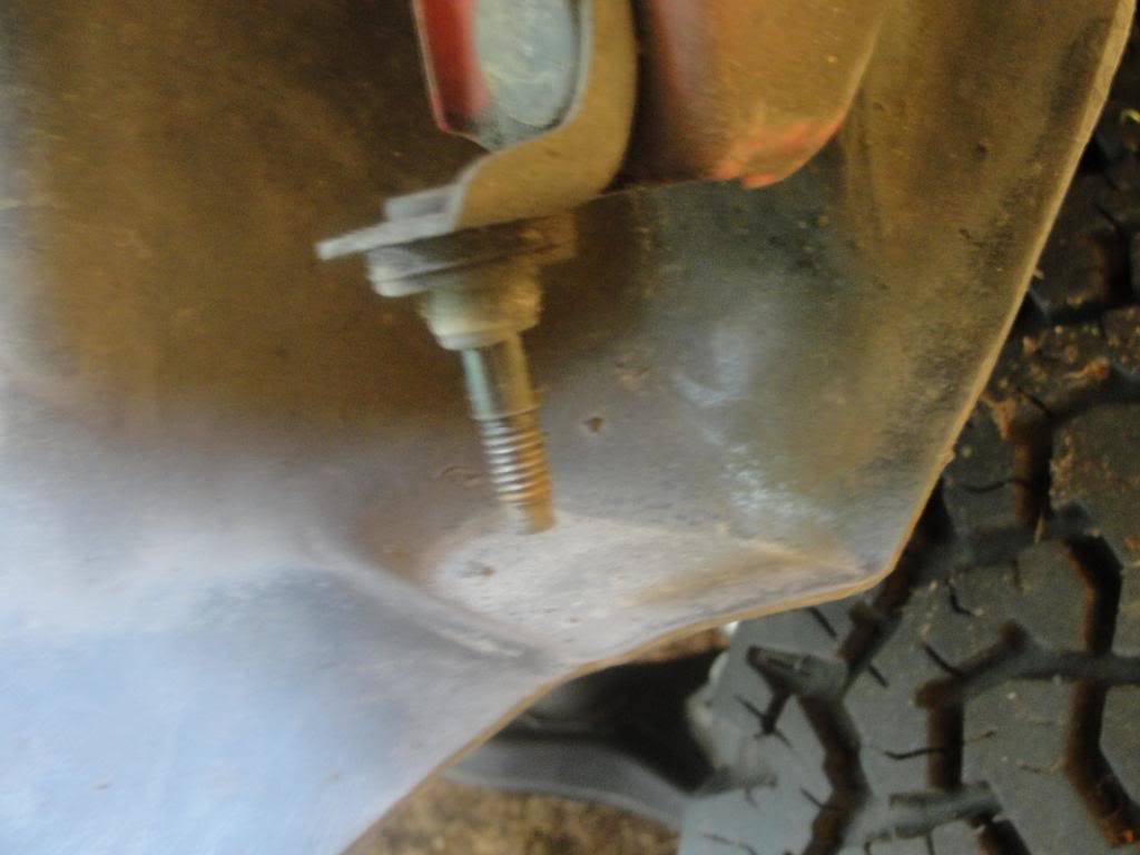

    In front of the tire pull out the clip directly in front, you have to reach up on the back side and twist it out, this will allow you to access to a 10mm nut/washer combo you have to pull
    (no picture of this but next step will let you figure it out, if you can just pull the splash guard enough to take off the 10mm bolt in next step then you can skip this step)
    Remove the 10mm nut/washer, this points straight up and down, its on the outside edge of the bumper
    Next underneath the bumper there are 2 clips that you need to pull out with a flat head screw driver, they point straight to the ground and are holding the bumper extenders in place
    Then the easy part, remove the 14mm bolts, 2 on each side attached to the frame.
    Then just jiggle it off.

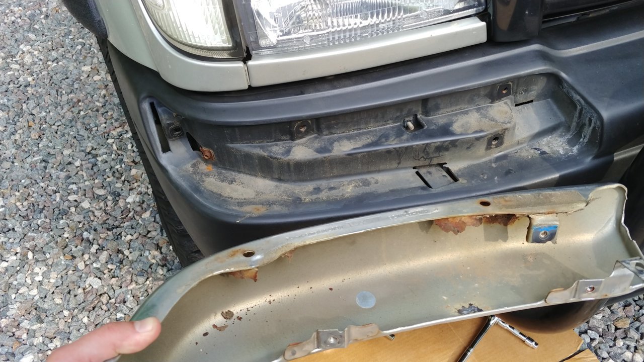

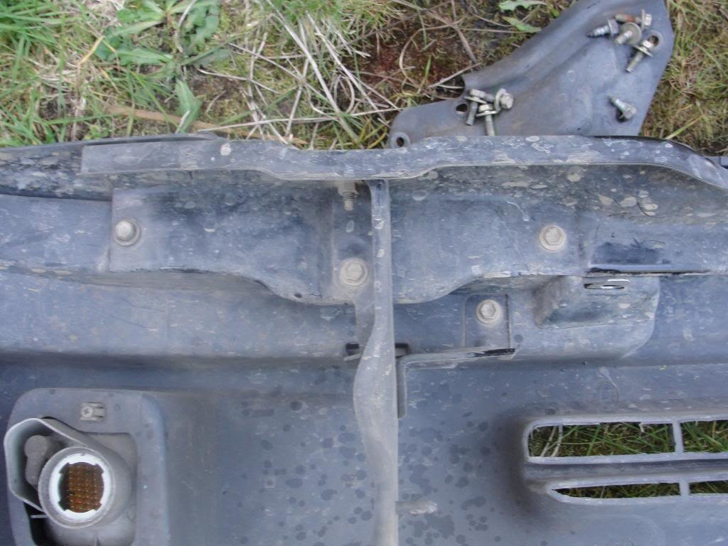

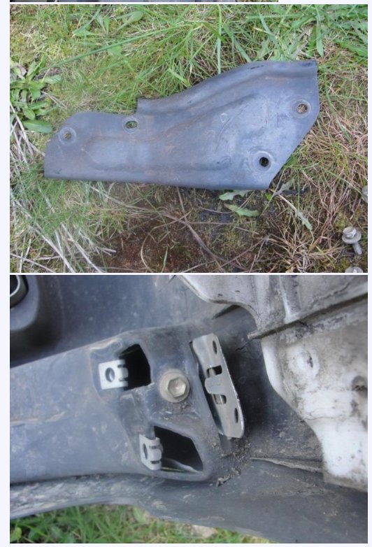

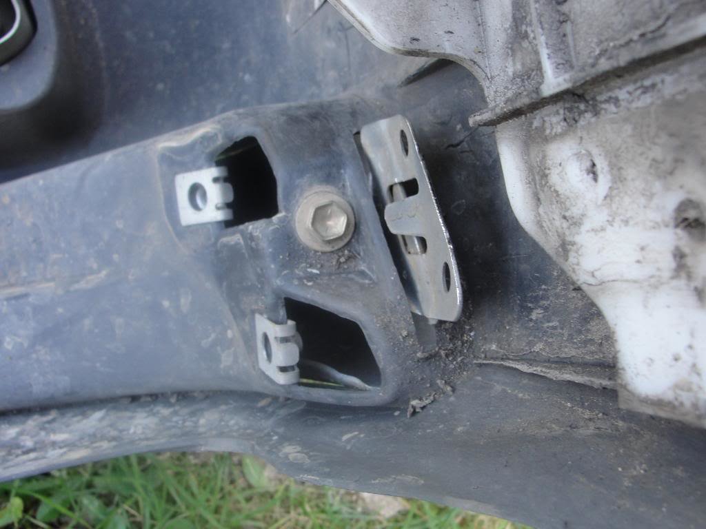

    Bumper end cover removal

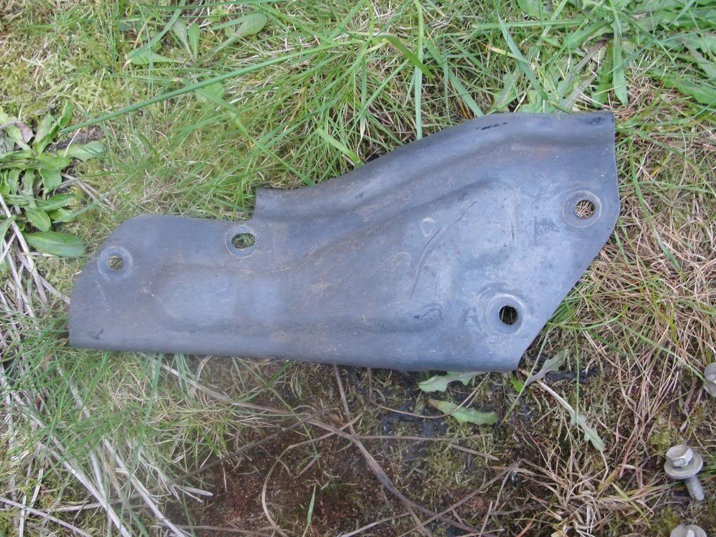

    With the bumper off now there are a few 10mm bolts/screws to remove, there is a metal guard on the outside held on by 3 of them, once you get the guard off there will be a 10mm bolt that actually attaches to the bumper end piece
    This frees the "big side"
    Now on the other end you need to take off the three 10mm bolts
    After this, press in the "tabs" on the bumper end and it should just fall out with a little effort

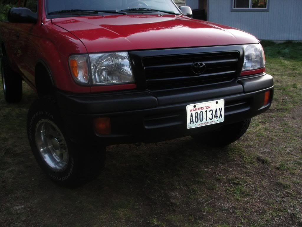

    Here is some more pictures, for paint i used Krylon black with clearcoats for the grille (which i need to paint because i missed a spot) and i used Duplicolor bed spray for the bumper ends (couldnt get the krylon to stick well to the chrome)

    Before and after of front end
