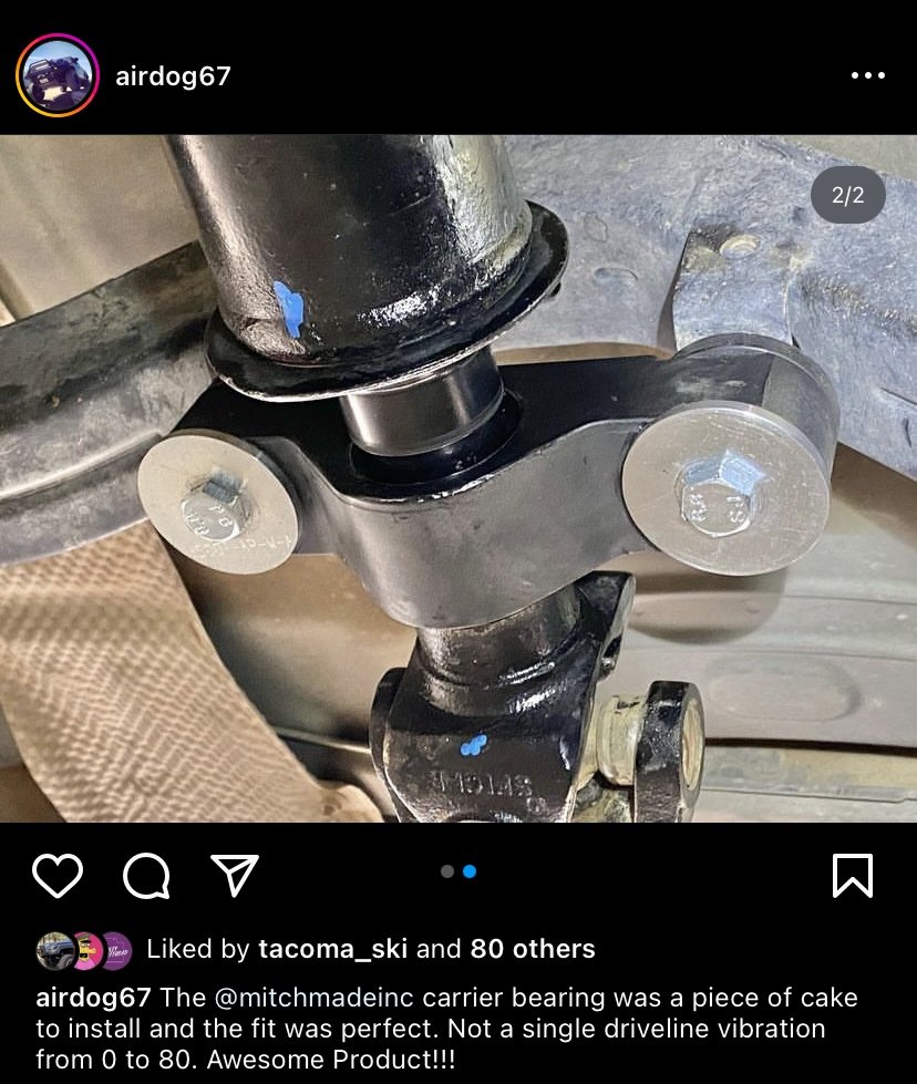

    Had a shop press on IEDLS bearing for cheap.
    Angle can be changed. I picked up pre cut metal tubes from a hardware store and longer bolts, with rough measurements taken to mimic previous angle I had with OE worn support and lift drop spacers from ARB if I recall correctly
    so far nothing has broken but have not gone in to re measure angle. I hear there’s a phone app that can do that
    there’s a new metal one I saw on Instagram that costs more but guy claims it’s only for 2wd
    I did not know 2wd was different. I thought the only difference is addition of a front half prop shaft.
    but then again a 6spd manual RA60F with transfer case probably extends longer than a RWD with 5spd auto among other possible differences on the truck including but not limited to short vs long bed etc

    I had vibes and all my research said that a 3* shim would correct the issue. It did not. But then again, my angles have changed for a variety of reasons....winch dropped the front, extra leaf raised the rear, etc. It doesn't vibrate when I have a load, but annoyingly vibrates around 5 mph. I need to get one of those Harbor Freight angle meters (or whatever they are called) as the phone app is "meh." The buttons on the side of my phone prevented it from laying flat on either side, so I never felt like I was getting accurate measures (granted the angle would be the same on both sides, so should come out in the wash). Also, rounded edges of the phone prevented it from getting good readings on the trans and rear 3rd.

  11. Jan 10, 2023 at 6:17 AM
    #191
    CowboyTaco
    CowboyTaco $20 is $20
    Aug 19, 2010
    #41928
    6,797
    North Georgia
    11 TRD Sport
    Seems like that would put extra stress on the u-joints.
