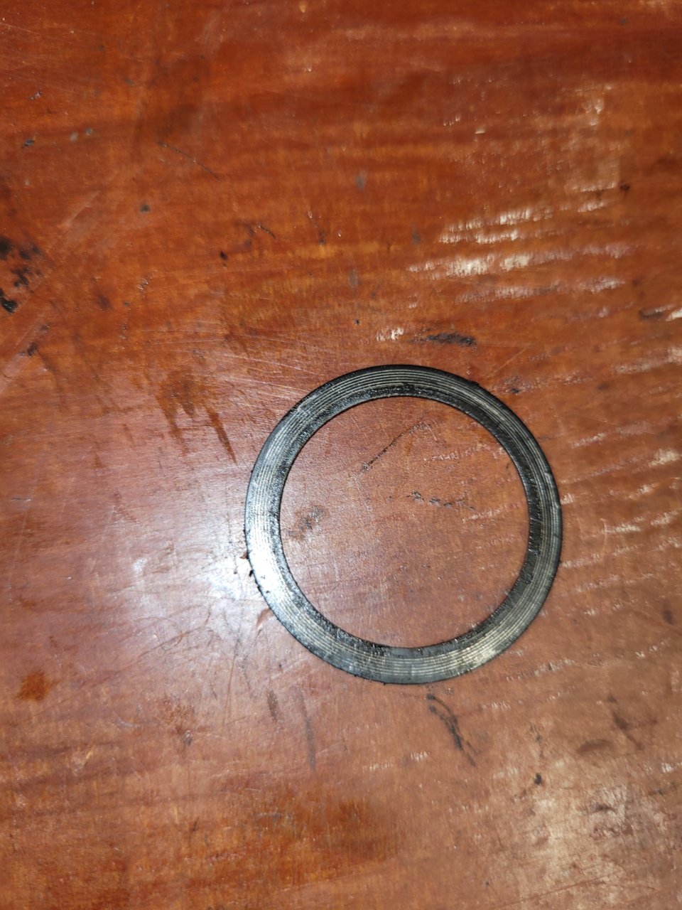

    I just finished my carrier bearing replacement and found this on the floor not sure if it came off the drive shaft or not. Anybody seen one of these while changing carrier bearing?

    Looks like an old dust shield - which in the 4x4 carrier bearings. (That is the only difference between the 2wd and 4wd versions.)

    Go back through this thread, somewhere I should have a post talking about that. I've tried to warn people to be on the lookout for it haha
    It's some sort of spacer / shim / washer thing. It's super hard and goes up against the face of the bearing. The grease causes it to stick to the old one being taken off
    I ended up taking mine all back apart a 2nd time to reinstall that. But I can guarantee you most people don't even notice it's missing and I've never heard of any side effects from not having it.

    I ended up saving it I shouldn't need it. I put a oem 2wd on because I ordered wrong one didn't want to pay re stocking fees and such. So if I remember I'll put it back on the next time I change carrier bearing. Thanks guys
