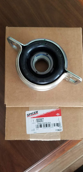

    Is that the Spicer? If not, what kind is it?
    Regardless, you need to contact the seller and tell them you received a defective part (assuming that is relatively newly installed).
    Here's what I just bought. You'll want the same part number if you are 4x4

    Bought an SKF bearing and SKF u-joint.

    I'm not familiar with SKF. I definitely think you need to contact the seller about a return or replacement. maybe see if you can pay the difference to get the spicer. The one I posted a pic of above even says TOYOTA and the part number for the 4wd version printed on the rubber (same as others have stated). I think I paid around $67 shipped. Same seller on Amazon and Ebay was $1 cheaper on Ebay.

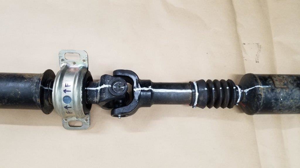

    The OP doesn't mention where to put the jaws of the puller when removing the center yoke (guessing that's what it is called.... the part you have to remove to access the center support bearing). I didn't want to mar the inside of that piece with the puller, but couldn't get it to grip anything else well enough to be useful.
    I ended up wrapping the ends with several layers of electrical tape and it seemed to do pretty good. Once I got as far as the puller would pull, I was then able to grab behind and pull that piece off.
    I don't think anyone can emphasize enough how important it is to mark everything. Especially that center piece as you remove it. Getting everything lined up properly is crucial!
    My last bit of advice. Use 2 different color paint pens. I used yellow to mark everything on thr side where the grease fitting went and orange on another side. This again helped keep everything lined up and aided tremendously during reassembly.

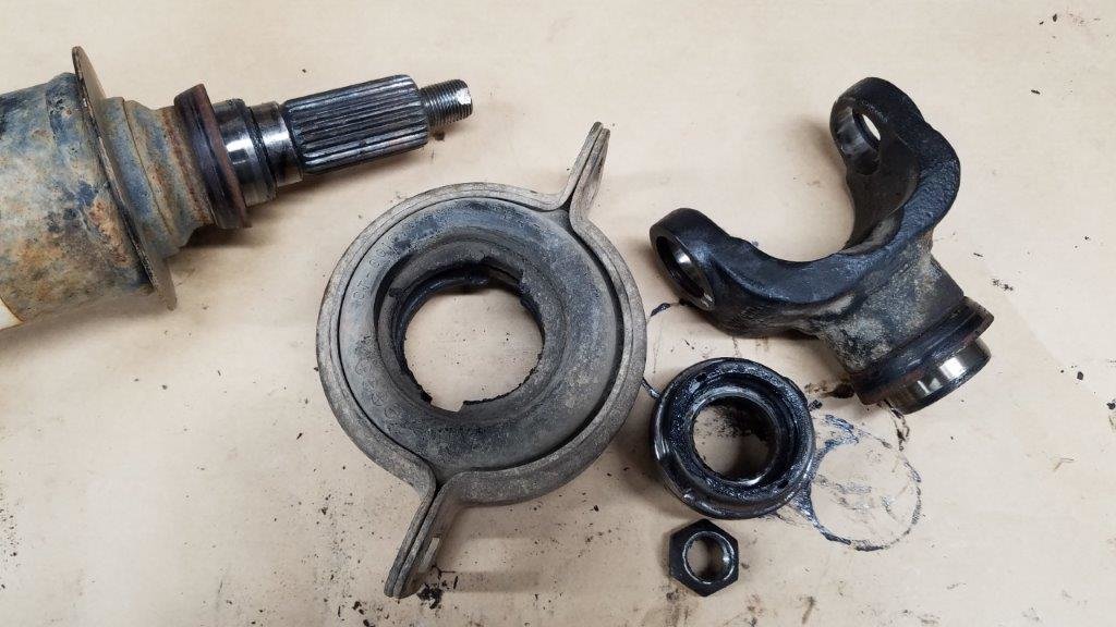

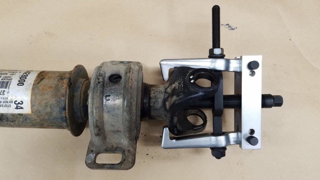

    I bought a new nut; it was ~90 cents. The reason you're supposed to replace it is because it is peened into place as a locking mechanism. I will post some puller pics in a bit

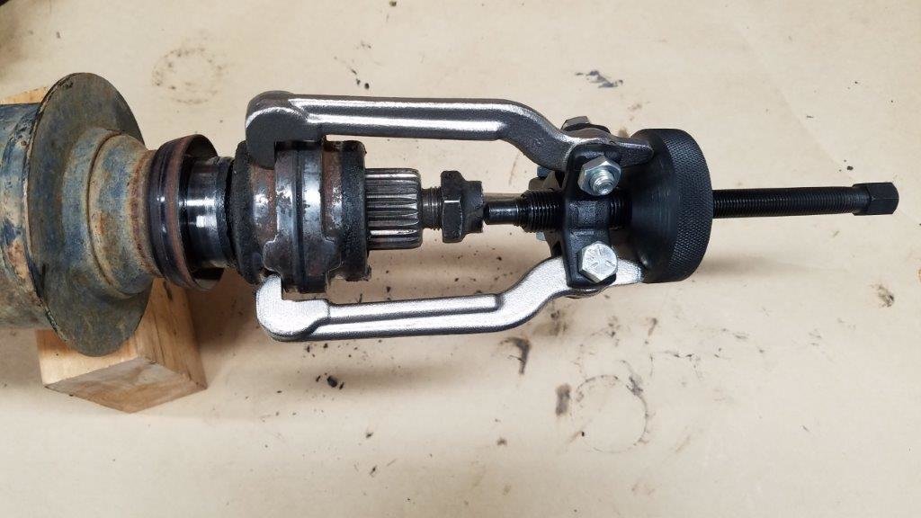

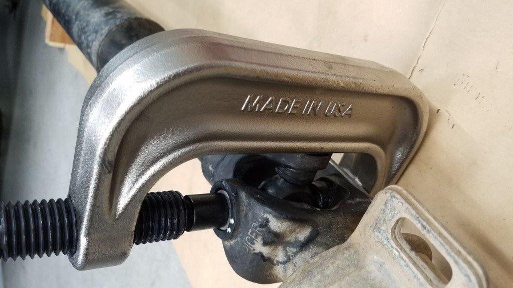

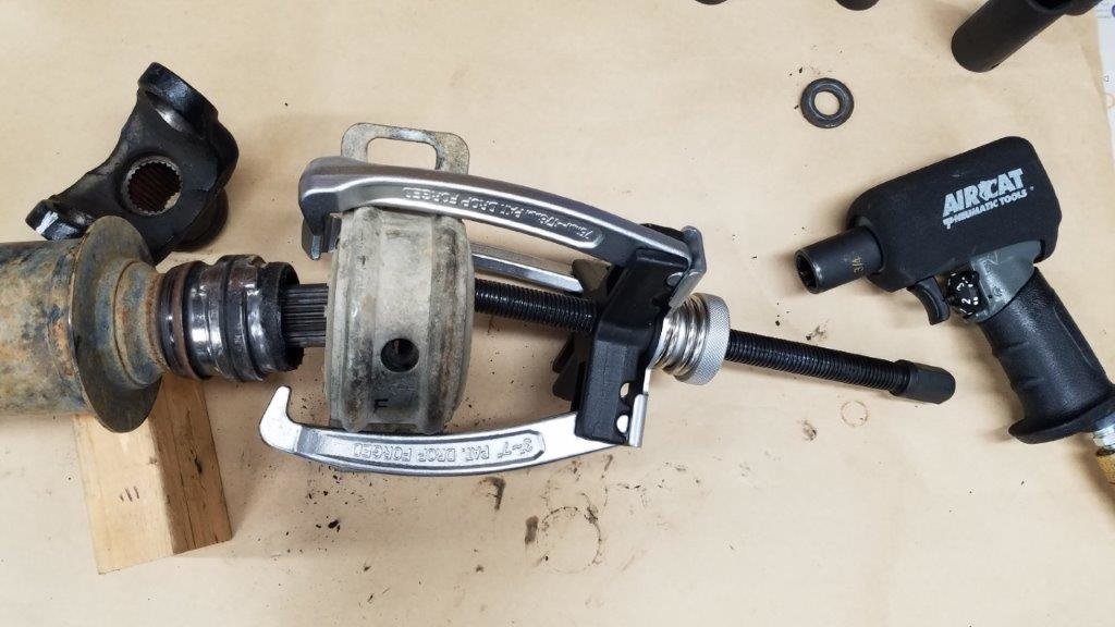

    Ball joint press (I primarily use it for u-joints):
    Pullers:
    Edit: in this picture you can see the flat on the end of the threaded portion. This is what you deform the nut against to lock it in place.
    Edit:
    Back together. I reused the clamps. It's not difficult to reuse them, just be careful when removing them. I could not find any locally but Napa said they can order them. You only need to remove the larger clamp.
    As said, mark everything with a paint marker. It is not that difficult to get it lined up, just support the ears on a few small pieces of 2X4 and you'll know when it's aligned.

    How did you keep them from sliding outward when pulling? I tried it like this when I did it and could never get them to grip on anything.
  13. Aug 12, 2019 at 5:11 AM
    #73
    Steve_P
    Steve_P Well-Known Member
    Sep 16, 2009
    #22854
    751
    TN
    09 Tacoma SR5 4WD 4cyl
    It's a "special" puller. Notice the screw that goes thru the jaws. You tighten two nuts and it keeps the jaws from moving. It's an OTC.
    Edit: I think it's this one, but I have both sets like it that they make. The other one is a larger spread.
    https://www.tooltopia.com/otc-tools...MIxIfY_af94wIVg47ICh2XmAfuEAQYASABEgKZG_D_BwE

    Wish I'd have known that existed. I ended up wrapping the puller fingers in electrical tape to soften them and went through the holes for the u-joint. It worked, but there was some praying involved.

    @Steve_P That is a nice puller! I rented one from AutoZone that didnt stay put. Resorted to a BFH. Thanks for the nut info. Did you get it from Toyota or Hardware store?

    The nut PN is 90080-17083- it's a special design to allow you to deform it. Oh, I paid $1.10 for it (I ordered some other stuff online) but it'll probably cost $2 at a local dealer. I also put some blue Loctite on it.
    I tried a few whacks with a brass mallet on the yoke but that didn't work so I got out the puller. The pullers that lock the jaws are really handy- the one pulling the bearing also locks the jaws with the cone- cone gets tightened by hand. Good pullers are expensive, and I don't use them that often, but they're huge time savers and sometimes there is just no other way.

    Wow wish I knew about that puller! Had a hell of a time trying to use a regular one

    Ha, yeah, that's what I was thinking as I was using it- how would I get the jaws to grip if I didn't have this? There is no flat surface on the rear of the yoke and the sloped shape makes the jaws open. If you don't have a puller like this you could use a large bearing splitter with a large two jaw puller.
