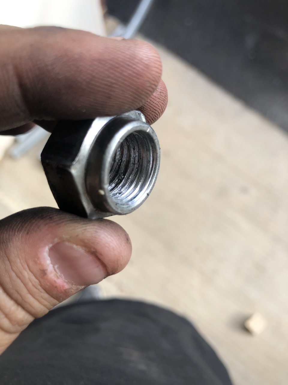

    Yep, did that. Tried to match on a metric die; M14x1.5 or M14x2.0...nada. Maybe it an M16x??
    The DS is Spicer, nut comes off using an M24 socket. The nut is deformed from OEM install (stake nut #90080-17083), it should thread on for first half inch or so...nada. I'm going to source a new nut at the dealer tomorrow; hopefully it works; if not the will drop the DS off at an auto machine shop.

    You need to “point” the first two or three threads completely. It takes a while but it will work

    Anybody knows the part number of the non-reusable nut (The one that holds the yolk. PIC#5)
  8. Oct 18, 2019 at 6:59 AM
    #88
    fatfurious2
    Jun 28, 2014
    #132884
    49,908
    David
    Ashburn, VA
    2010 TRD OR Access Cab
    The one that i cross threaded?
    SR-71A likes this.
  9. Oct 18, 2019 at 7:10 AM

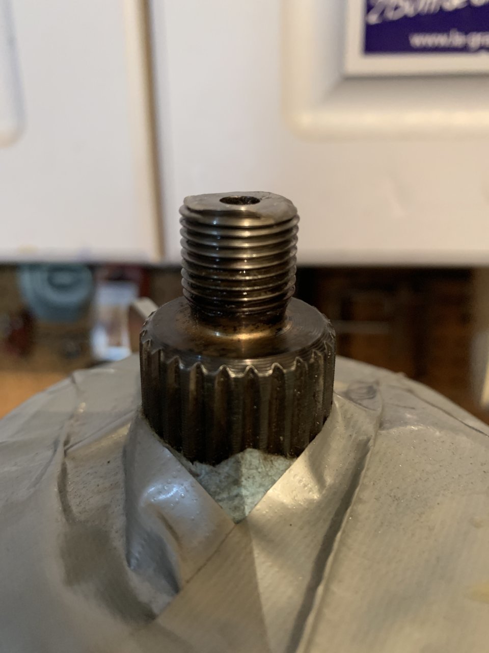

    Help. @Steve_P , @jmanscotch , @CowboyTaco I took the driveshaft out yesterday and it got late, so I’ll continue today.
    I removed the center bearing and this piece was there but since it was getting Dark and I couldn’t see if it’s part of the driveshaft or part of the old bearing.
