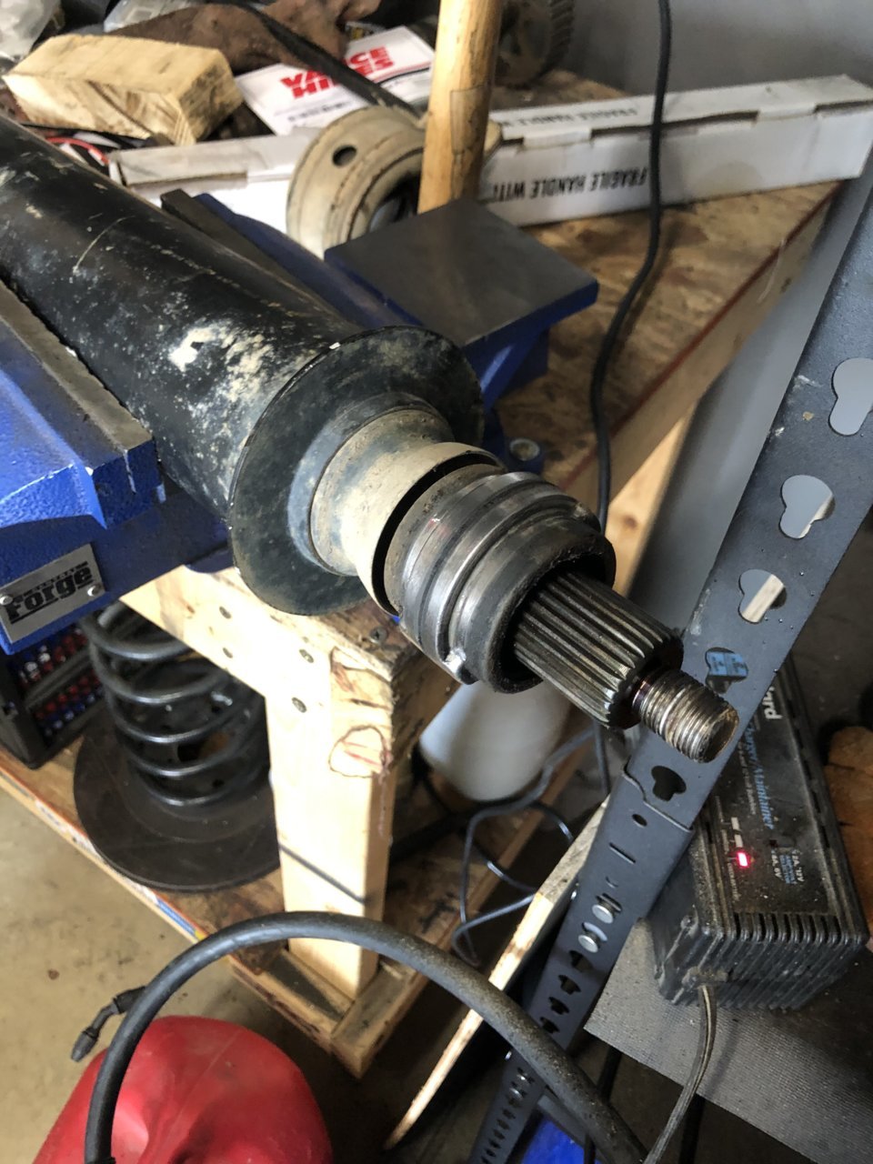

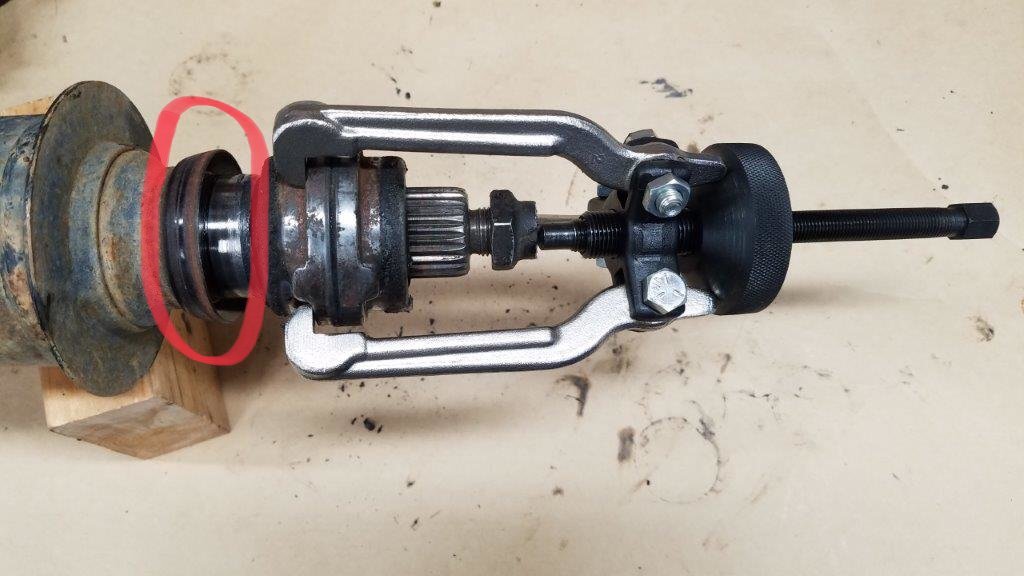

    You got the old bearing off. That's all that you need to remove.
    I found it easiest to set the new bearing by attaching the front half of the driveshaft to the x-fer case and tightening to the first spec (IIRC 136 lb-ft), then backing the nut back off with the impact, then tightening back down to the final torque spec (IIRC 51 lb-ft). Then remove the front half of the driveshaft and reassemble the unit to put it back in as a whole.
    There is a wonderful thread on the sticky section of the 2nd gen forum that lists all the torque specs.
