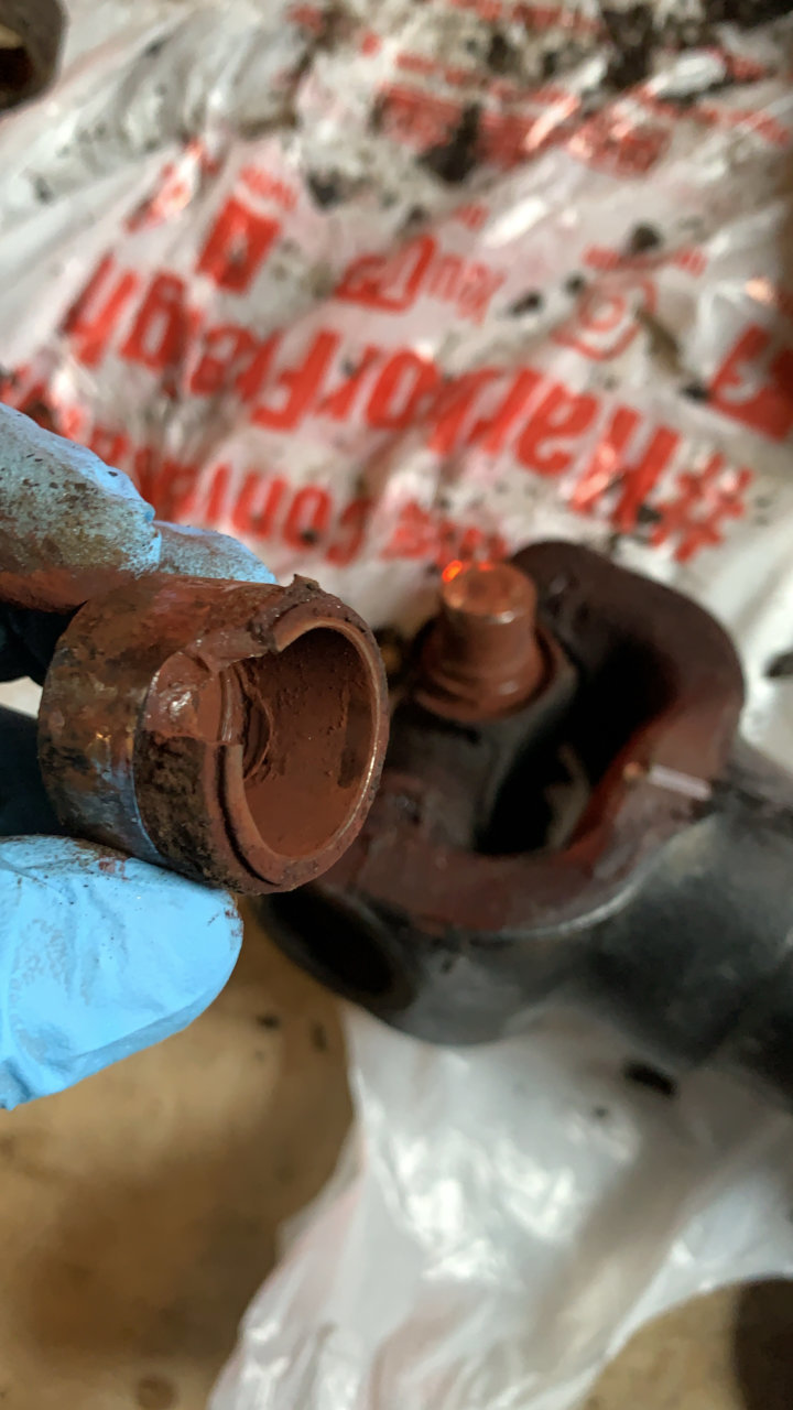

    While searching around I also cane across this video that helped too. Turned out to be about a 4hr job. The local dealer wanted $850
    https://youtube.com/watch?v=IF9--WmZOYo
    I had a lot of play in the CB but now I think the 30/55mph shakes were caused by this little guy.

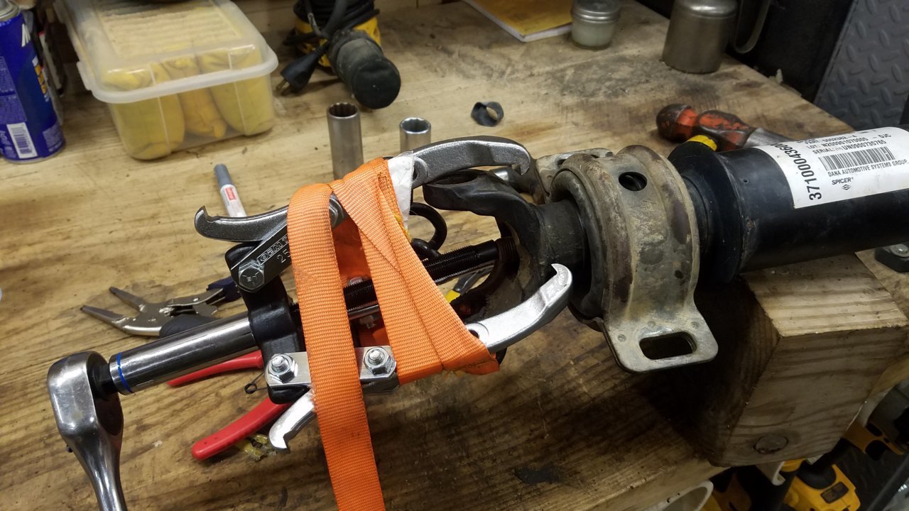

    Thought this may help some people, I wrapped the 3 jaw puller with a ratchet strap in order to pull the yoke off. Came off without a single problem!20200210_130036.jpg
