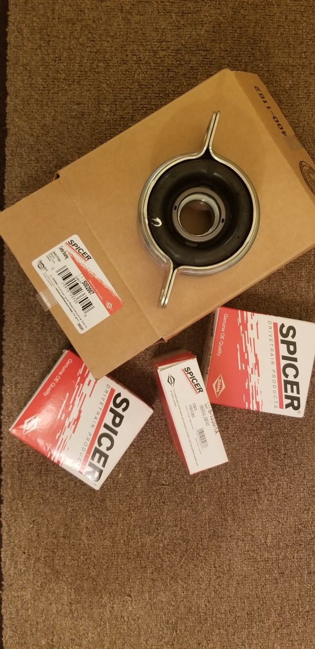

    Driveshafts are rather large, cumbersome, and heavy things so I can't say this was my favorite job.
    I did all three u joints (Spicer greasable joints from rock auto), and the carrier bearing (also Spicer and also from rock auto). This has mostly (almost entirely) cured my vibrations. I can't say it rides like a Cadillac now but I can say it rides like a ten year old Tacoma. Anyone not specifically feeling for vibes probably wouldn't notice or remark anything at all.
    I plan on trying out some tire balancing beads to see if they can get me to fully perfect, but I see mixed reviews on those so we'll see. If they don't work I'm honestly content with what I have now.
    My thoughts on the repairs:
    Get some kind of press, I used the free loaner ball joint tool from my flaps (friendly local auto parts store). This is far easier than using my bench vice or hammers (and easier on the parts).
    Do all the joints on the rear shaft and carrier bearing at the same time, might as well with the driveshaft out anyway
    I started by just replacing only the carrier bearing and while doing so discovered one of the u joints was bad and ended up having to order the u joints and basically do things twice, which was really dumb on my part.
    I reused the magic single use only nut... Twice. The first time I just re-peened it. The second time I used a screw driver to un-peen it over and used red lock tight on the final torque down plus re-peening it. I am perfectly okay with that but ymmv. If I had read this thread before ordering the parts I probably would have ordered the magic nut when I ordered the other parts but I'm not too broken up over it.
    The first time when replacing only the carrier bearing I used one from the flaps and the Spicer one is far superior in quality and ease of installation, I recommend it. It was a bit cheaper shipped than the one from the flaps too.
    Best to all!
