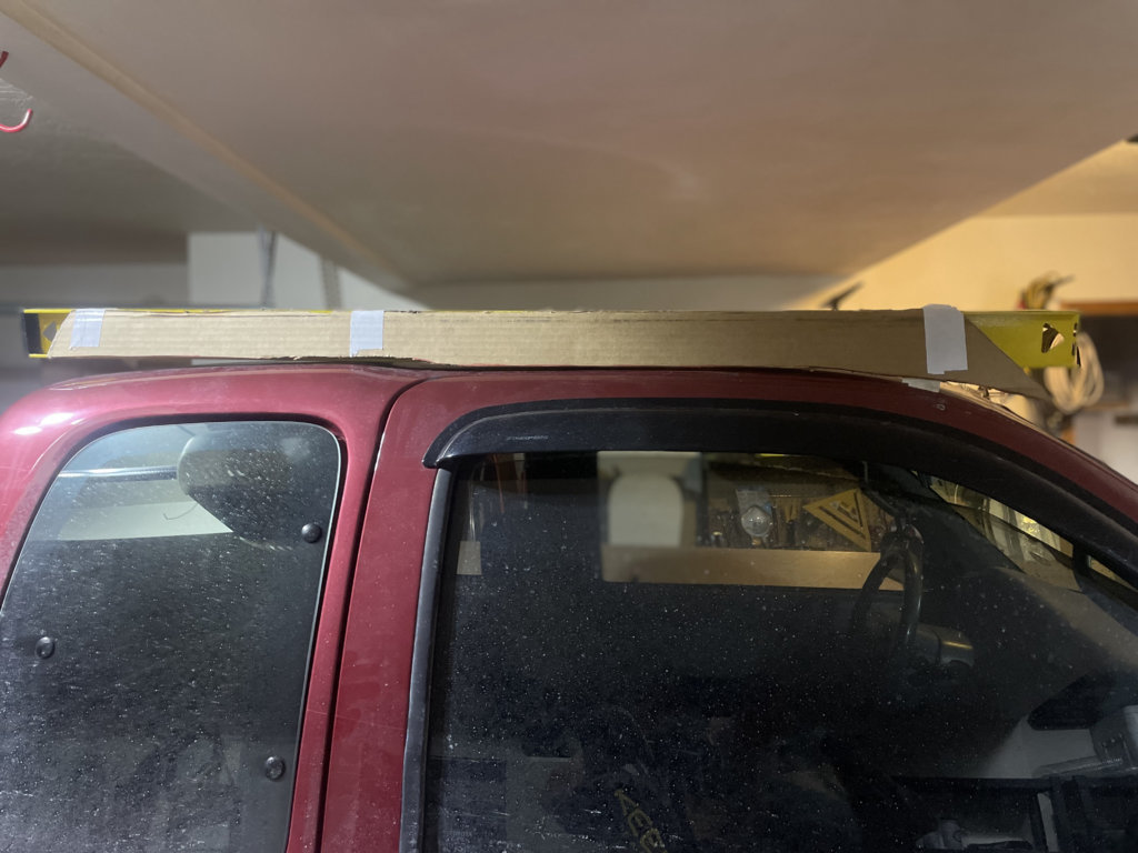

    I modeled the side rails out of cardboard to get the roof line right, the hardest part was where the roof bulges out over the rear window.

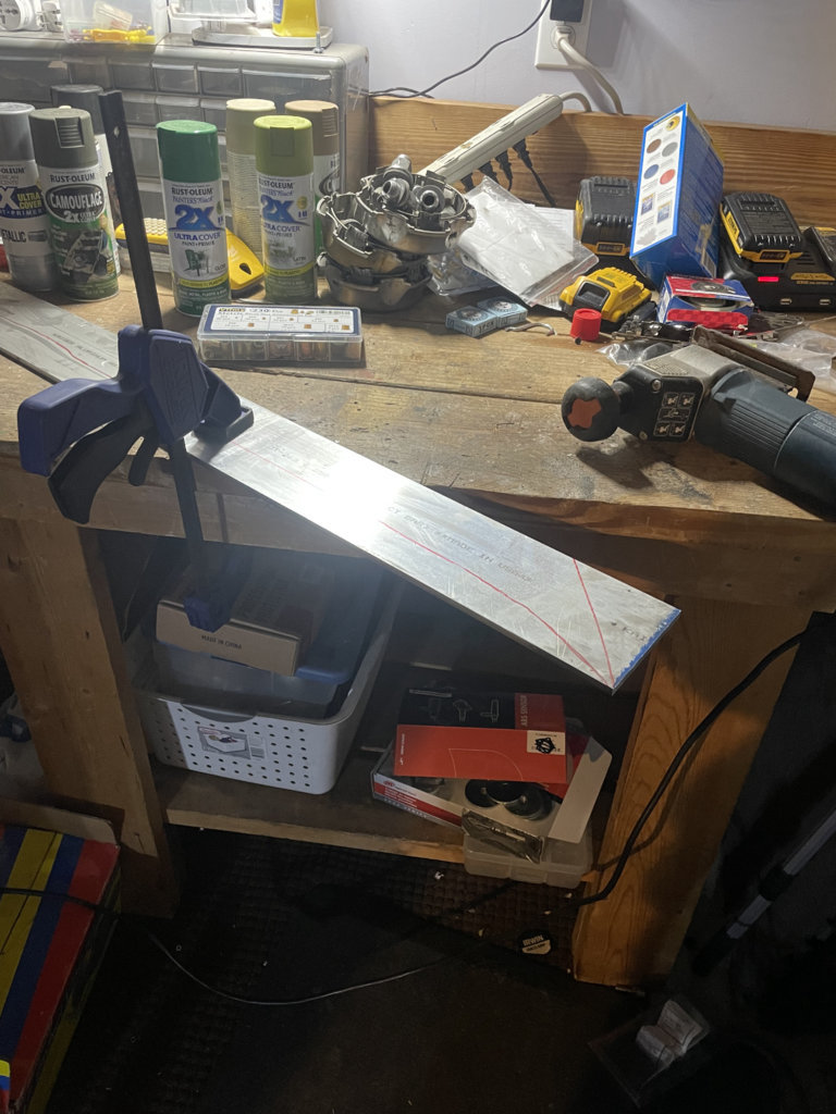

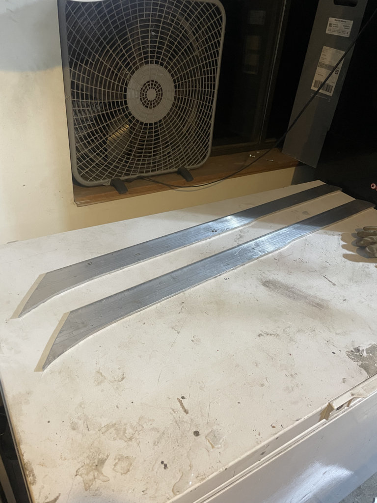

    Next, I traced the carboard model onto the aluminum and cut it out with a jigsaw.

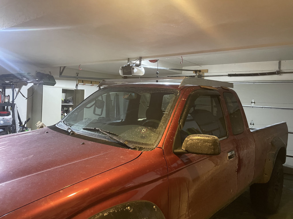

    I used 4 cross bars, once I got the front and back bars drilled and bolted on I set the rack on the roof to mark where to put the brackets.
    I used m8 rivnuts to bolt the rack to the roof, I would definitely recommend plusnuts over rivnuts. They were a massive pain to install and have the threads pointing straight.

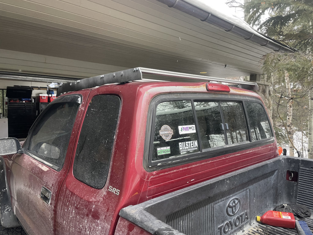

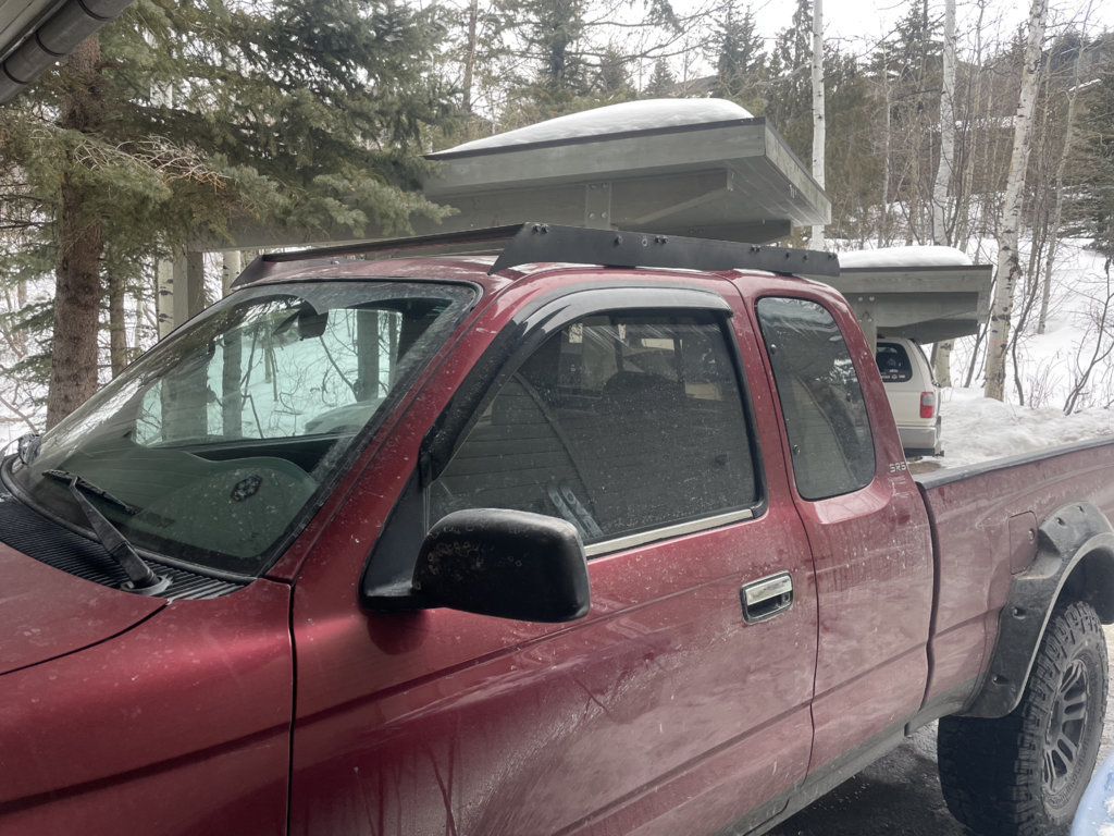

    This was the final result with one coat of bedliner, I haven't put a wind deflector on the front as I am planning to put some lights on the front.
