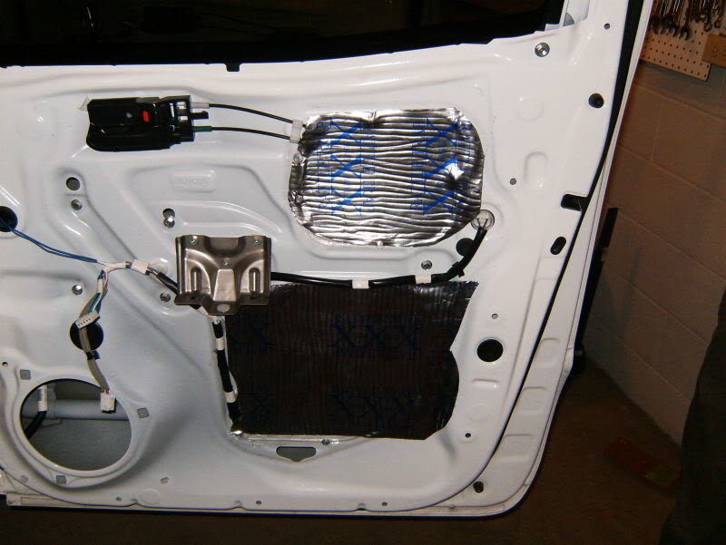

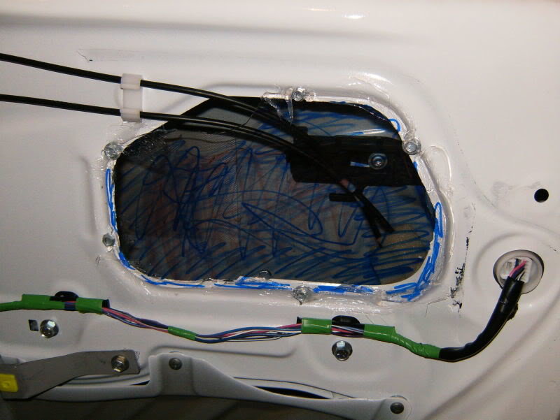

    The next step is to seal your door panels. For this you will need some sort of material. ABS plastic is usually the material of choice here, but because i had set aside a weekend to do my install and forgot to order it i picked up some 1/4 lexan (the unbreakable kind). Lexan is very easy to use because you can have a buddy hold it over the opening in the door and you can just trace out the piece you'll need to cut. Over each door opening (or hole) there is about a 1/8" -1/4" gap that is recessed into the door, you want your piece to fit the outside of this gap as best as possible.
    There are a couple different materials you can use for this step such as:
    -ABS plastic
    -1/4" MDF (just make sure you seal it with plasti-dip or line-x or something that won't let the moisture in)
    -Sheet metal flashing (which i personally don't prefer beause of metal on metal , but a lot of people do like to use this)
    -I have also seen people use the realtor signs (the kind that are a thick plastic board with a hollow like inside)
    -Perforated metal (which is also easy to trace and cut because you can see through the holes in it)

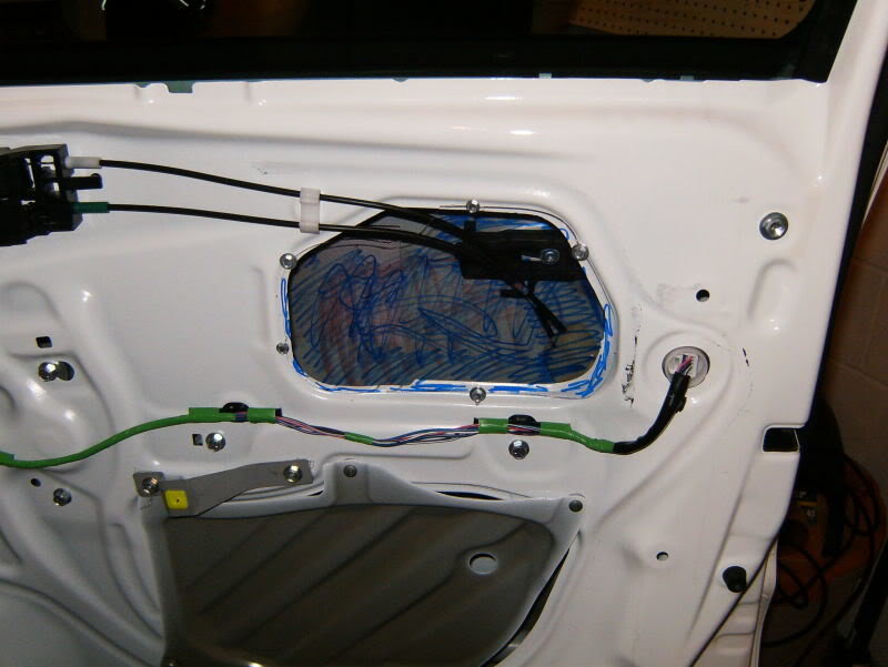

    Once you have the material of choice cut out, place a bead of silicone around the hole your about the seal and place the material to cover the hole. next use some tiny sheet metal screws to hold the piece of lexan (or other material) in place so that it will not move. Then hit it again with some silicone to seal the hole.
    here is the silicone i used:
    Note: I have colored the lexan with a sharpie so you can see it better.

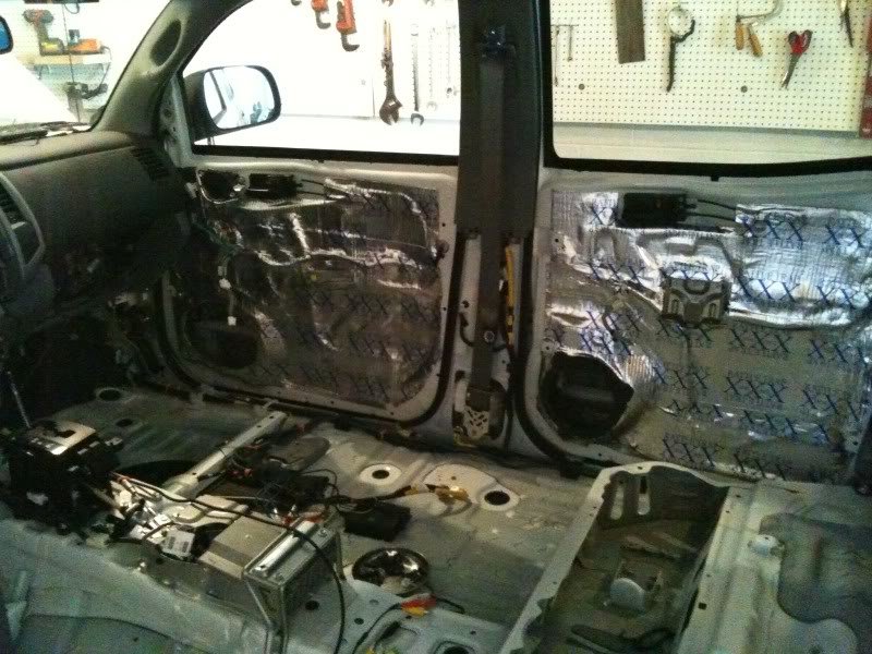

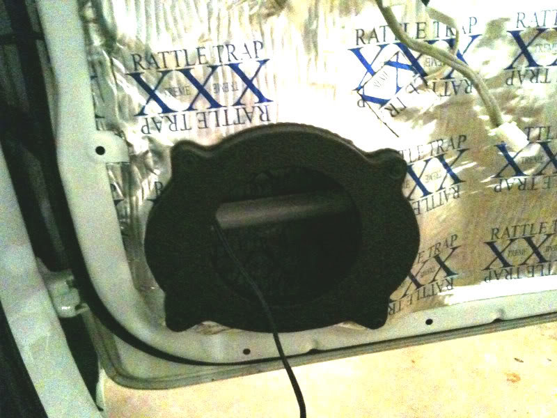

    Next, Take a piece of your sound deadener and place it over the hole you just sealed (in my case fatmat rattletrap xxxtreme 80mil) . I have used this deadener on many projects and have always been pleased with the outcome, and it's not priced too bad either.
    Next, Cover your entire door with another layer or two (including the area you just covered).
    Note:Make sure you do not cover over the holes for the door panel clips!

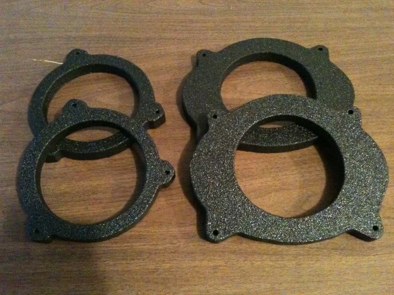

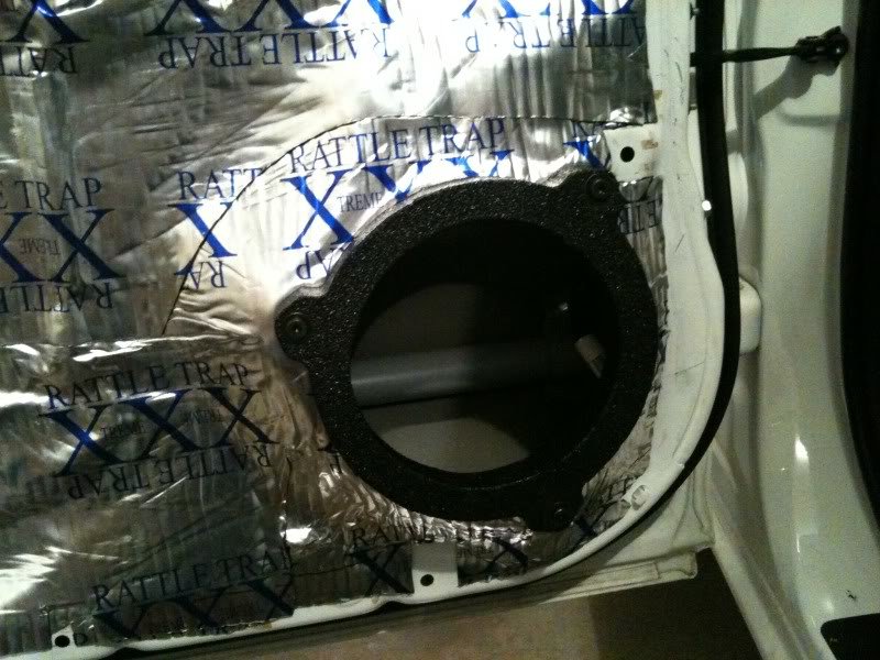

    Lastly, get your speaker rings and bolt them to the door. Here is a set that i made. I had them sprayed with line-x so that they would be resistant to water and moisture.
    Put the door panels back on and you're done!

    I used about 3-4 layers behind the speaker on the inner skin, they rest of the inner skin is pretty hard to access for this. Behind the speaker should deffinately be deadened though.

    The reason people are doing this is because it improves the sound quality. To what degree the door is sealed isn't relevant. Performing these steps will enhance your stereo system. I know from personal experience, the before and after difference was quite noticeable and I don't feel that I wasted my time at all.

    It's true that an IDEAL seal is a completely sealed enclosure. Although this technique does not seal the door chamber completely, it sure helps hold more pressure which will improve the speakers response.
    Additionally, it also helps reduce road/wind/other outside noises which helps drop the noise floor a bit. Of course, this stuff only works for certain frequencies (which is why CCF and MLV are also great because they also reduce the noise floor...but for slightly different frequencies). So the quieter you make your cabin, the lower you can keep your system.
    The benefit of listening to your system at a lower volume is because electronics tend to get more inefficient as they get hotter. The more power you are using in your amp and speakers, the worse your signal to noise ratio gets due to these inefficiencies...

    Another very important reason to seal off those large holes on the inner door skin is to prevent the back waves from the speakers coming through and interfering with the front waves. Also most speakers that would be installed in a door are designed to be infinite baffle, so sealing off the doors isn't necessary, but may help some.
    I def think CCF is a good idea to help stop rattles. I also used MLV, and it quieted down the road noise to an extent. Once I hit about 50mph or so, it's doesn't do much. But then again I have Duratrac tires.

    hookedontronics...you dont by any chance have some leftover speaker adapter plates you can trace and scan into an image file for me...? would make it easy to make some using a printed template rather than measuring and cutting from scratch!
