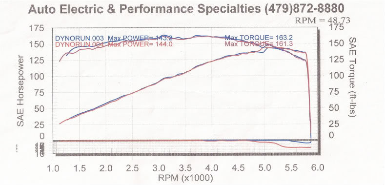

    You say it works, I say it doesn't.:p Below is a chart of of 05 2.7 dyno'd with the factory air filter and then without a filter at all. So a K&N would be somewhere in between agree'd? As you can see there was no difference in power. red was without the filter and blue was with.

    While it's not a direct comparison to what they are doing, I feel pretty confident the air filter is way more restrictive than that screen. So if NO air filter gave you nothing, I can't imagine removing the screen will do much for you.
