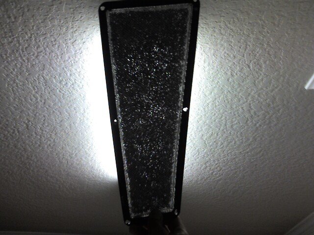

    Ok, so I had decided to remove the filter this afternoon. Thank you for the instructions.
    Attached is a picture of the filter and you can see how it could restrict air flow.
