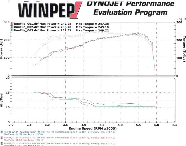

    You would think this would put an end to this zero effect mod, but yet it continues?
    Over at toyotanation lots of v6 owners raved about the increase throttle response, lower rpm?, and badass growl, at least on this thread anyway a few understand it doesn't do any for the V6, but it doesn't do anything for the 2.7l either.
    I sympathize with you Chris4x4, often reason and facts fail.

    Excellent data set!
    I see a detrimental effect at the low end of torque according to chart. It appears to show "with filter" to have a higher rate of torque or rpm (upper data set) at the engine ramp up. This is my experience after removing the filter. It keeps up and goes, don't get me wrong. However, it exhibits a definite lag at the top end of my gear shift in manual. It feels like almost the engine is gasping, starved for something. Fuel? Air? When I buy a newer taco I wont remove the filter for sure.

    Ah but your wrong. If the very bottom lines are A/F ratio, there was a change. If they are throttle position, the person let off on the gas earlier. If those lines represent speed it would say MPH on the side. One dyno sheet does not prove anything. For all we know those runs could have been done with no changes made back to back.
    Here is a dyno sheet from my Mazdaspeed3 when it was bone stock. These runs were done one right after the other. Looks exactly the same as the sheet above. Fact of the matter is you remove an obstruction from the inlet, something is going to change. May not be measurable but its going to change.

    An unmeasureable change isn't worth much. No 2 snow flakes are the same either. Too bad the much tauted improved throttle response has no measurable artifact.
    If there is no measurable difference at WOT there will be none when the throttle plate overrides the filter obstruction at part throttle.

    Good for him, not trying to be funny but I probably have as much experience tuning cars as he does, I am being dead serious. Been modifying cars for power since 1995, working at Turbo Tune until Mark died in 08, still do work on the side. I have lost track of how many turbo manifolds I have welded together from scratch. One thing I have learned that you haven't yet is the dyno is not the only measure of performance, gas mileage also works if the mods weren't accompanied by changes in fuel pressure. His test can also have been messed up by rising humidity and temps while he was removing stuff through the day. There are many things that can change results, thus why I tend to not take dyno results seriously. Trap speeds on a drag strip are a better measure of possible street gains.
    Either way, what does it hurt to remove the secondary filter? It causes no changes in driveability, it costs nothing, and measurable on a dyno and measurable on the street can sometimes be mutually exclusive.

    Here is a study that did not find any reduction in fuel consumption after restricting the filter way beyond any restriction that this carbon filter is causing. They did 3 different types of drive cycle tests on a dyno eliminating variables.
    http://www.fueleconomy.gov/feg/pdfs/Air_Filter_Effects_02_26_2009.pdf
    Are you really saying the butt dyno is more accurate?

    A sigle dyno run on any mod is not accurate. I do a min. of 3 runs per change. 3 before, and 3 after. I try to do them within a couple hours, and the shop I did the runs at was indoors (with the large bay door open facing the north). The average of the 3 runs would dictate any performance gains, loss, or nothing. I have also monitored fuel trims, Mass air flow (Gm's/sec.), as well as exhaust temps. Betweens those things, I belive I have tested as close to accurate as possible, without having access to a full blown lab. As far as the charcoal filter is concerned, I saw no gains, or changes accross the board. I had a friend of mine bench test the amount of air flow the charcoal filter can handle, and its well above anything the 4.0 V6 could move. So...If it has no impact on engine performance with it removed, why remove it? The amount of weight savings is less than 1/3 pound......so you could possibly gain more by skipping a lunch.

    Can't argue with that. Especially the portion about the airflow limits of the charcoal filter. It is one thing to post up a dyno sheet and say here is proof. It is another thing to have the person come in and explain the conditions and methods of the dyno. Thank you for taking the time to clear that up.
