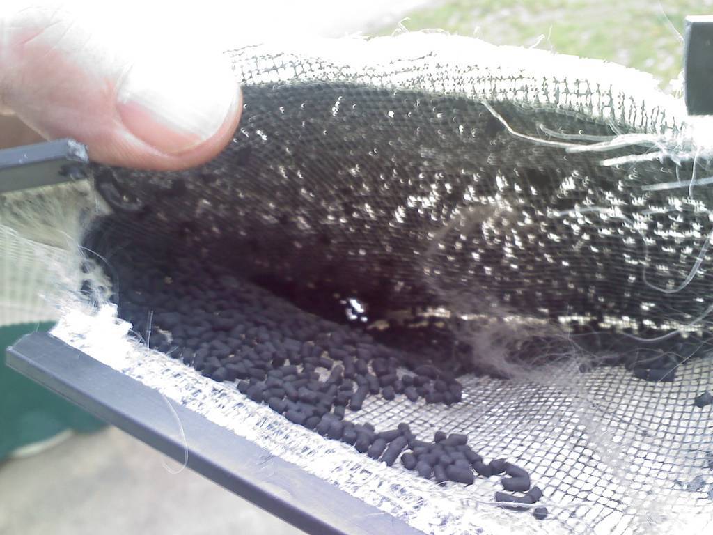

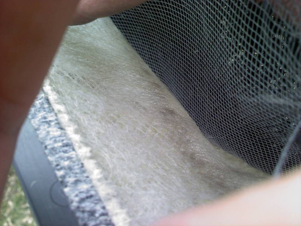

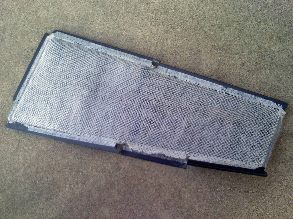

    I've always disliked the manual trans drive by wire lag characteristic and this thing certainly wasn't helping matters. Now that I've seen how it's made, out it comes and plenty happy it's gone.
    Apologies if there are pics of the charcoal filter previously in this post... but have ya seen this restrictive device in person? (V6 model) Sorry for the cellphone quality pics, but you'll get the idea.
    Let's cut it apart and have a peek. Looking inward at one side showing cylinder shaped charcoal held by a layer of nylon looking webbing. The charcoal was displaced during removal but otherwise was equally and uniformly suspended by the webbing. There is a second later of this same construction on the other half of the filter! A mirror image of this same restrictive crap on the flip side. Hava looky see -
    That ain't all either... have a peek at the outer most material, appears to be similar to fire retardant fiberglass cloth... yep that'll flow well. NOT -
    Keep in mind that's just one side. It's built in two sections, with two layers of webbing, two layers of charcoal and two layers of fiberglass like cloth. That's unreal. Pretty much like driving with a pre-clogged main filter. I can see why people commented on improved throttle response.
    Hell, you can't see the grass in my yard below this thing, let alone barely any light through it. I'll agree your butt dyno might not register any HP gains, but it sure ain't doing your engine any good performance wise built like. No, it sure ain't.

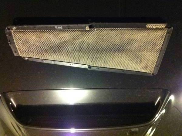

    I just did this yesterday after reading up on it a bit. Made no difference AT ALL even after driving 100 miles, noticed absolutely nothing different. In fact, I wish I hadn't taken it out because it broke coming out. If you think it did make a difference, it is mostly just in your head...just sayin'
