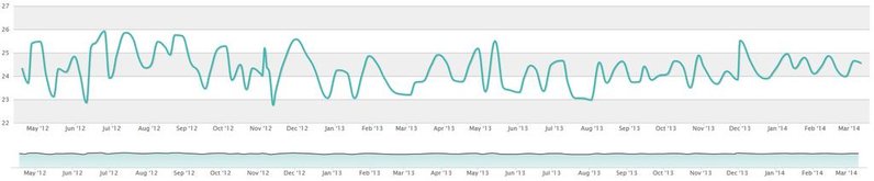

    I also took out the carbon filter on my 4.0 and I noticed a slight improvement in my MPG 0.4 MPG improvement. I also took out the screen further down stream- no improvement and it was not as smooth, so I put it back. My MPG is 20.5 to 21 MPG always, with the A/C off slightly higher. Oh and I run a K/N air filter. I run the factory recommended oil and a Toyota oil filter- the Toyota oil filter makes that valve noise go away for the most part. Coming up on 70,000 miles on the OEM tires, I run 34PSI frt, and 32 PSI in the rear, the tires last a lot longer that way and I rotate them at 8 to 10K miles.

    Open up a fuelly account and text your mileage and fuel usage with every fill-up and you'll soon see that 0.4mpg, and even 1mpg variance from one tank to the next is meaningless.
    There are too many other variables including weather, traffic, emotional state, and the load in your cab or bed that impact fuel economy more.
    Same truck, same driver, same roads for the most part....

    Exactly Rich, fuel mileage is a joke. To many variables in gas consumption. I like the part about "emotional state " this is where I lose the most fuel to.
