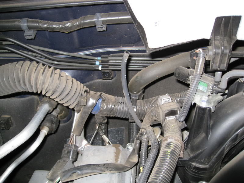

    Ok I would really like to thank 007 for coming up with this. However especially for the mechanically uninclined like myself the guide posted on page 1 doesn't show those of us with a V6 really what to do. So it with great humility that I will be adding this as an addendum to the original guide.
    Please excuse my dirty truck =)

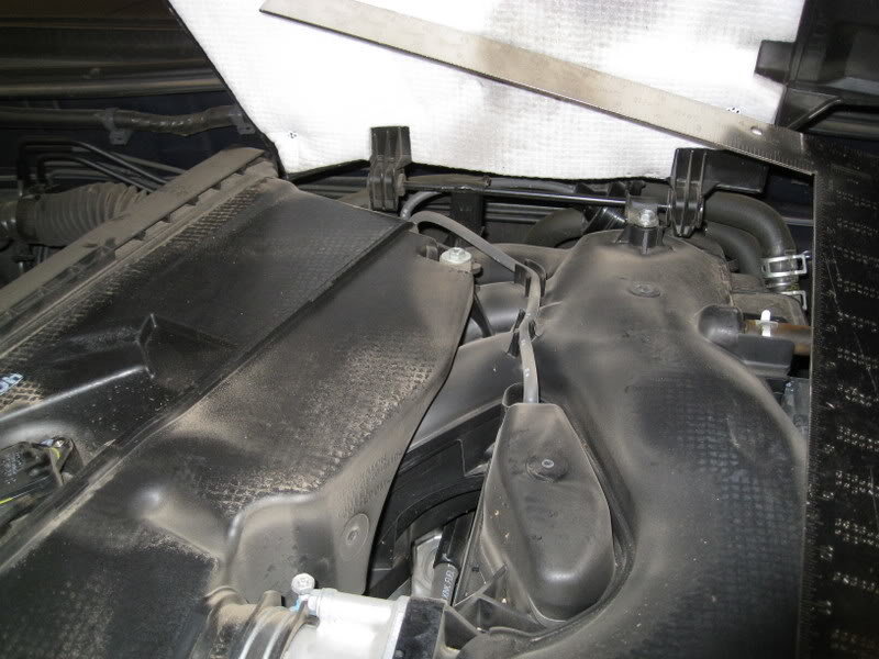

    The first thing you will need to do is to unbolt the engine cover, there are two bolts on the front of the cover you can see one of them here, they are really easy.
    The next thing you need to do is unscrew the bolt clamp on the intake hose #1 (left side of engine bay when looking at it).
    There are now two form of clips simply unlatch these:
    You can now remove this part of the air filter, I put tin foil over the tube just encase.

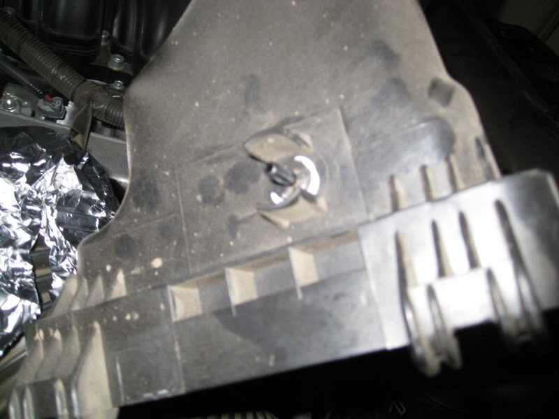

    Now you can work on getting the secondary air filter out. There are two bolts holding down this part of the assembly (one in the front) look down and left sorry forgot to snap a pic here.
    One in the back:
    You will need to remove the plug to the MAF (Mass Air Flow) sensor, you will see a little tab on the front push down on that and then very gently pull the unit out. There are in total 3 hoses connected to this assembly the one in the very front you just push the prongs on the metal tie holding it tight, push that down and pull off the tube. The second hose has another bolt clamp simply undue that like the very first one. The third one is the tricky one, it is on the very back of the filter unit but is not attached with anything so just yank it off, you can see it here:
    Where It plugs into:
    The final step on pulling out the box is there are two little clampy ties holding some wires to the box, grab some needle nose pliers and yank like hell. They will come off. This them near there original points after having been torn out:
    Then repeat all above processes to reassemble your engine:D
    edit: So this being my first mod, i've ever done to a car let me know if anything above is inaccurate or not clear enough. Just wanted to help all the people out there who opened up the hood and went WTF, this looks nothing like those pictures @&^!

    i just took my secondary filter out this morning. took me like 10 mins to take it all apart and 3 mins to use a flathead screwdriver and pry the filter out and 5 mins to put it all together. does it sound like i did nething wrong?

    on the v6, all u have to do is remove the 2 clips from the front where the intake meets the main assembly and the filter is right there....dunno what all u did, but getting to the secondary filter for me only took 5 seconds. do u have an aftermarket intake or something?

    naw man thats the regular filter. do you see what wildcataco posted like 3 comments up? the whole taking the big intake box out, unclipping all the wires.. and freeing up that middle box piece. thats the secondary filter. you keep that triangular filter in.

    there is a charcoal filter where u take the clips off. i know what the regular filter is...i have a k&n drop in...if u take and remove the part that holds the regular filter, there is a thick, charcoal filter right where the regular filter fits into that box. i'm at work and cant see the photos b/c they are on photobucket. i'll try to find a bypass or wait til i get home.

    ok...i went back out there and looked at mine. i uncliped the 2 clips that hold on the intake....i've already removed the thick charcoal filter that is on the box going into the engine...and i noticed there is a lil aluminum mesh screen right before it exits to go to the throttle body, so i ripped that one out w/ my hands as well. are those two things yall removed?? ie the aluminum mesh screen and the triangluar shaped charcoal filter thats attached to the plastic box via the plastic welds? if so, then there's no need in taking off the cover and all that other jazz

    I took some time to look over my V6 this weekend contemplating this mod. I'm with you jhodge, I just undid the clips. The stock primary air filter is on the left, and what I thought was the charcoal secondary is accessible on the right.
    I suspect taking more pieces apart lets you put the secondary filter and the box it's in on a workbench to carefully drill out those plastic welds. It looked kinda awkward to me to try to get those off while the box was still mounted.

    Ok sorry for the confusion guys. yeah I took the entire box out so I could work with it. I'll probably delete the post above and redo it with more/clearer pictures tonight. I suppose you could drill out that filter in place but that would seem like a total pain in the ass to me and somewhat dangerous.

    and other v6 owners, u dont need to drill out anything. undo the 2 clips, cut a slit into the bottom if the charcoal filter to get ur fingers into it, and rip it out...the plastic welds arent that hard and it leaves no clean up...same for the aluminum screen...no tools needed, unless u count a knife...start to finish in under 5 mins...
