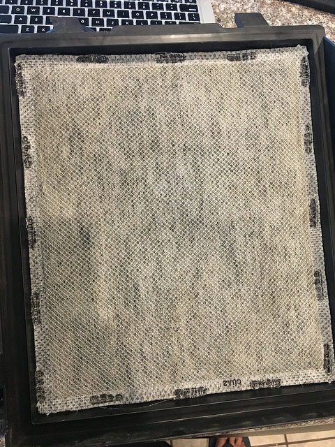

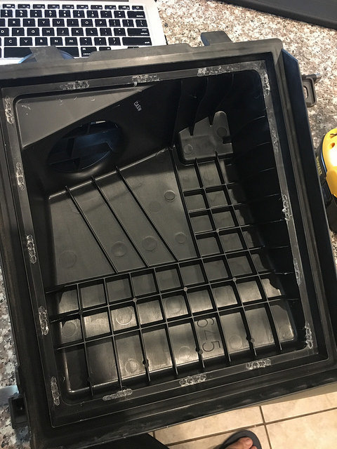

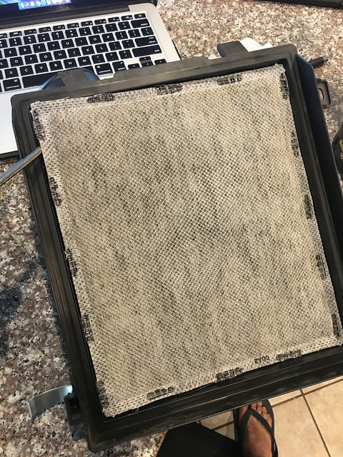

    Just did this on my 2017 TRD PRO. There are no rivets anymore, as much as its a melted stamp of sorts. There are about 18 of the little "stamps" that can be easily pried off. It took my a total of 10 minutes from opening the hood to closing it. Most of the time was because I was careful, and even tried to use a blow dryer to see if the heat helped (it didn't). Included some pictures of what I was working with.[​IMG]
