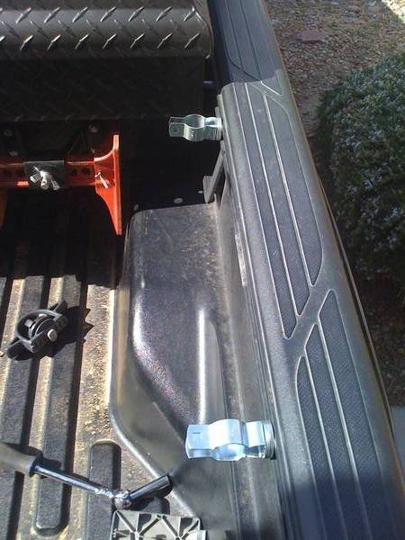

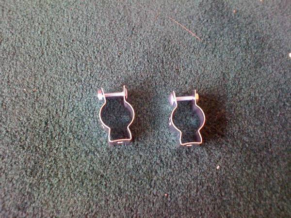

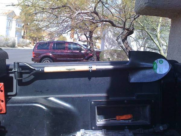

    i just mounted a shovel to the rail on my short bed with 1" conduit hanger.
    instead of getting the quick fists ($7-$10 each) i just bought 2 1" conduit hangers from lowes for 79 cents a peice and bought some bolts and washers to mount the hangers on the rail. all in all i just spent $5 to mount my shovel. let me know what you guys think.

    :thumbsup: your only issue would be if you needed to get the shovel out fast - might want to try wing nuts

    You could even pick up 2 mini sized pad locks instead of the wing nuts...
    Just keep the key on your truck key ring

    ok. how would i mout them to the rail? does home depot or lowes sell those little square bolts that would attach to the rail?

    just bolt, nut and washers. I just got mine off ebay

    i saw this thread and decided to use conduit hangers since i came across them @ Menards for dirt cheap. i sprayed them with 3 coats of black paint though. i am happy with the final result. mounted them on the bedliner over the wheel well so the shovel head is almost up against the front of the bed
