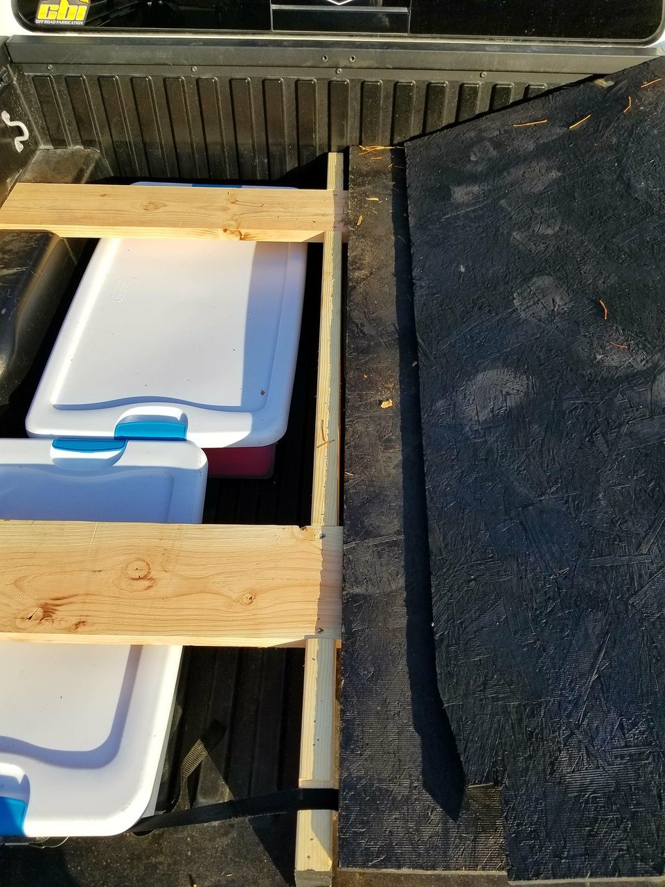

    I decided to build a sleeping/storage platform for my 2017 Tacoma OR.
    The truck is a shortbed doublecab.

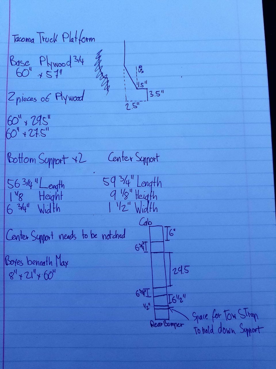

    I started out with taking dimensions.
    The base, which I made out of 3/4 plywood, needed to be 60" x 57".
    I ended up using two sheets of plywood.
    The first one I cut 60" x 29.5".
    The second one is 60" x 27.5'.
    You are able to cut both sheets so they are exactly the same dimensions and both rest on the center support, however I wanted only one to rest on it, in case I needed to carry something very heavy.

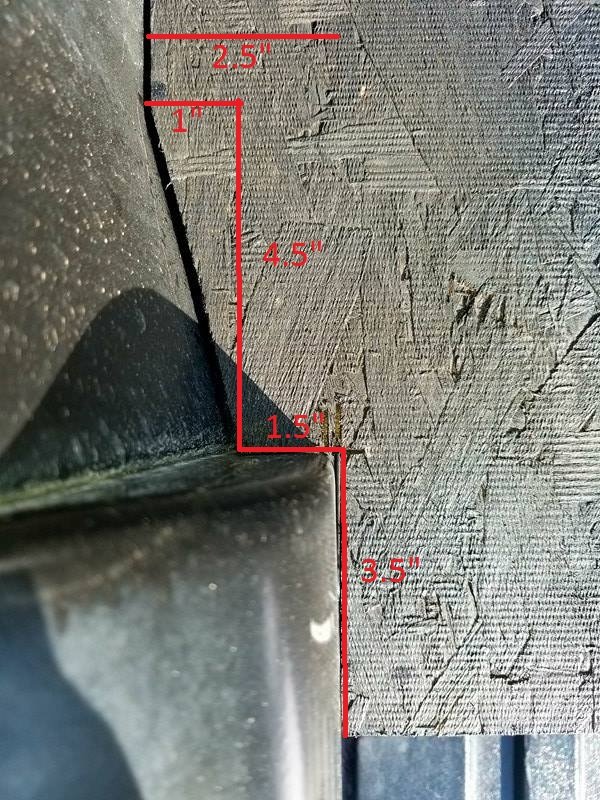

    The hardest part was figuring out the cuts I needed to make, to make it fit by the end of the truck-back.
    Here are the dimensions. As you can tell it is a nice tight squeeze.
    After cutting the plywood, I ended up doing 3 coats of rubberized undercoating.
    Next I cut the two bottom support braces which run from bedside to beside.
    The dimensions are:
    56 3/4" Length x 1 1/8" Height x 6 3/4" Width
    I purposely left some space in-case the wood gets wet and expands.
    I also decided on doing a center support which will go beneath the two boards we just cut.
    The dimensions are"
    59 3/4" Length x 9 1/8" Height x 1 1/2" Width
    I needed to add notches in the center support. Two for the support braces and one small one for a tie down at the end of the bed.
    All notches need to be 1 1/8' deep and need to have a length of 6 3/4".
    Coming from the Cab back, I made the first notch 6" back.
    After our 6 3/4" notch, I measured 29.5" and made another notch.
    Next we will notch our tie-down notch.
    Measuring from our second notch, I came back 6 1/2" and notched it. The notch only need to be barely cut and with a width of about 1/2".
    I nailed the support braces to the center support for added stability.
    The platform now is complete.

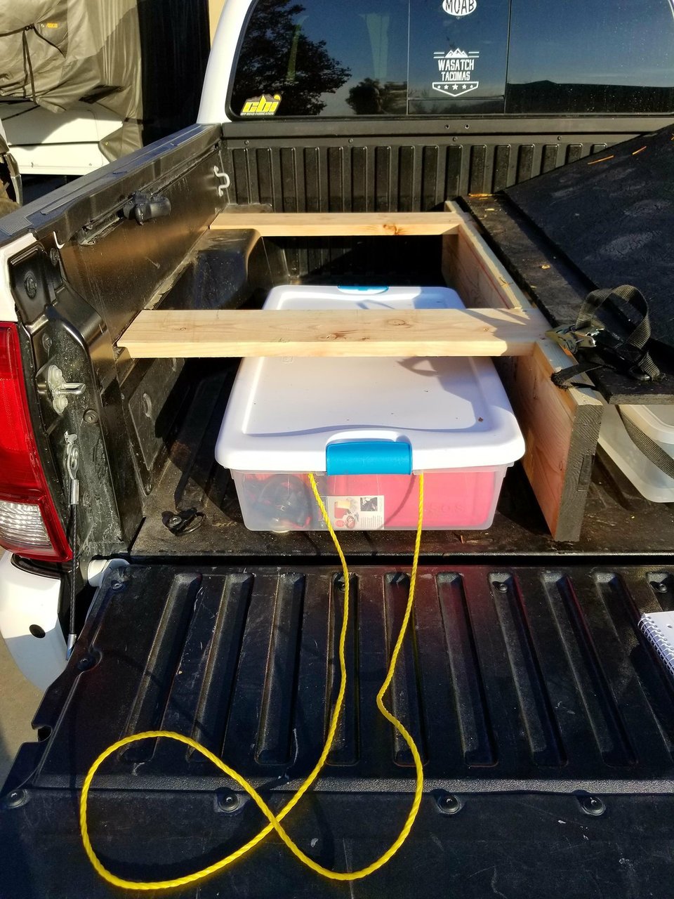

    My plan was to just use seal-able plastic boxes from Walmart.
    The max dimensions for the storage can be 8" x 21" x 60".
    I ended up using 4 boxes in total.
    Since it was hard to reach the further back boxes, I just attached a string of rope. 23157985_1710174305673072_805416827_o.jpg

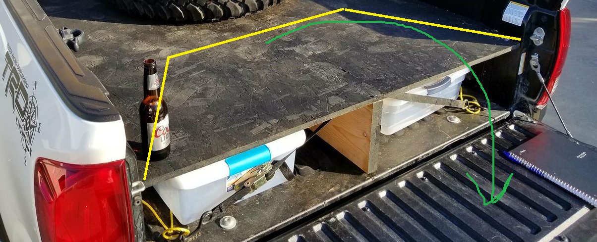

    Just a heads up for anyone attempting to diy one.
    As you might know, the Tacoma bedsides like to deform and flex, so resist the urge to make the boards fit tight, since that will just make the bed spread more quickly. You can still make it fit nice, leaving a small gap but don't make it tight.

    That's one of the reasons I did this thread mainly for the measurements. It took me two trys to get it fit nicely, so I figured I spare someone else the hassle.
    My plan was originally to build boxes on sliders out of wood, however it would be pretty heavy and I wanted to make sure everything is sealed nice beneath.
    Thanks for the tips with the bed sides. Ill recut the side pieces with about 1/4" space so hopefully this wont be happening to me.
