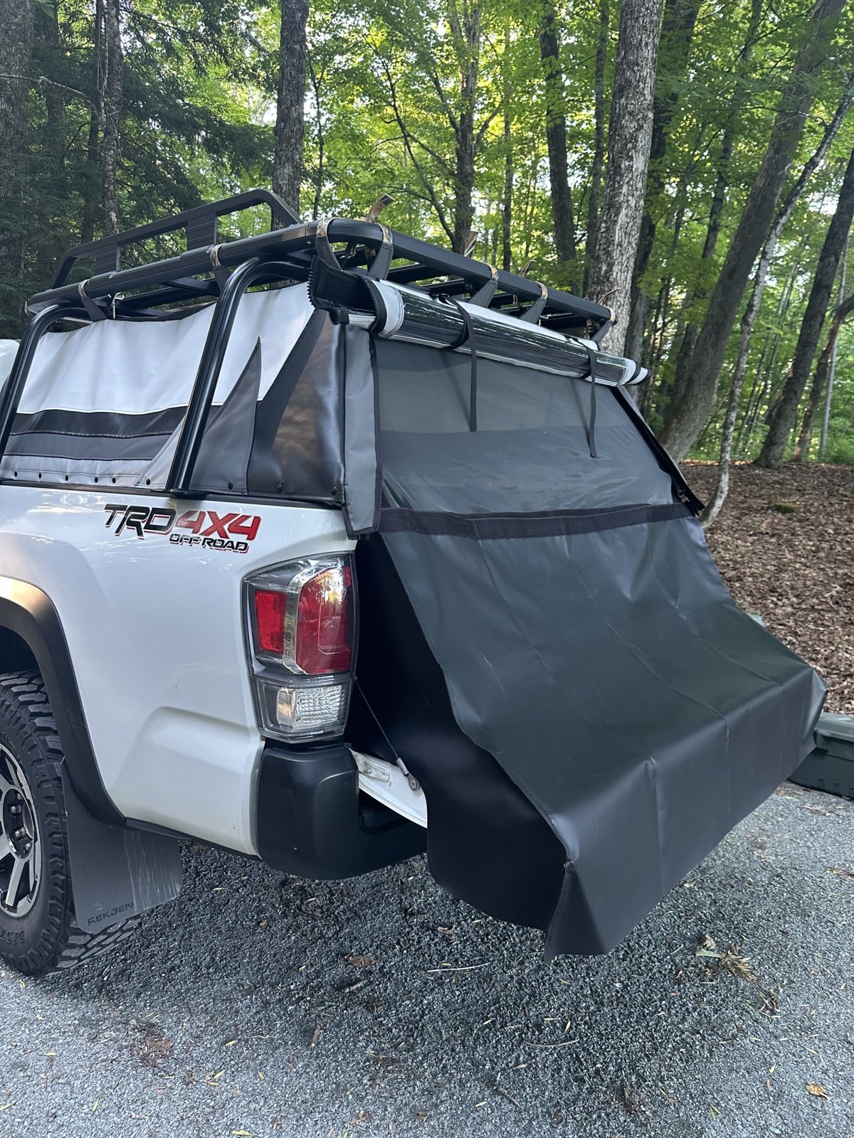

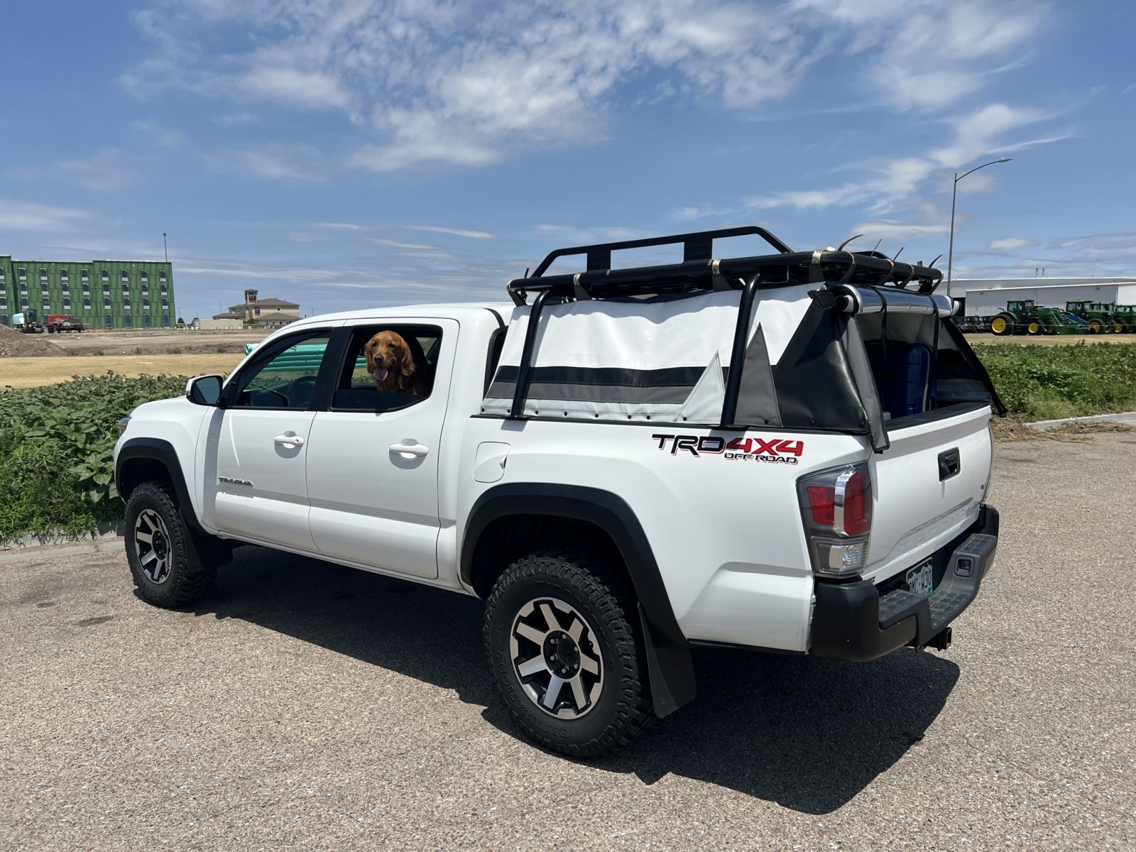

    I made a soft topper that straps to my bed rack and snaps to an angle iron frame. Also sewed up a bug screen and rainproof tailgate cover to make sleeping in the shortbed more comfortable. What do you think?

    I’m 6ft even and can comfortably lay out with my 5’6” wife and 70 pound dog. Short bed is now a lot better for camping!

    Very nice! I like the "embelishment" of the color panels. "PEAKS"! ;-)
    The fabric must flap as you drive though. Or does it just inflate?
    Looks very secure. and airy

    Very nice! This is a really cool design. Do you keep it on while driving, or just attach it to the rack when you park? Looks like it would be very easy to take on and off with the straps.

    I just leave it on while driving. Made it to Maine after 2500 miles at 75mph- so far so good! It’s made out of super burly fabric and thread so it should hold up to some abuse.

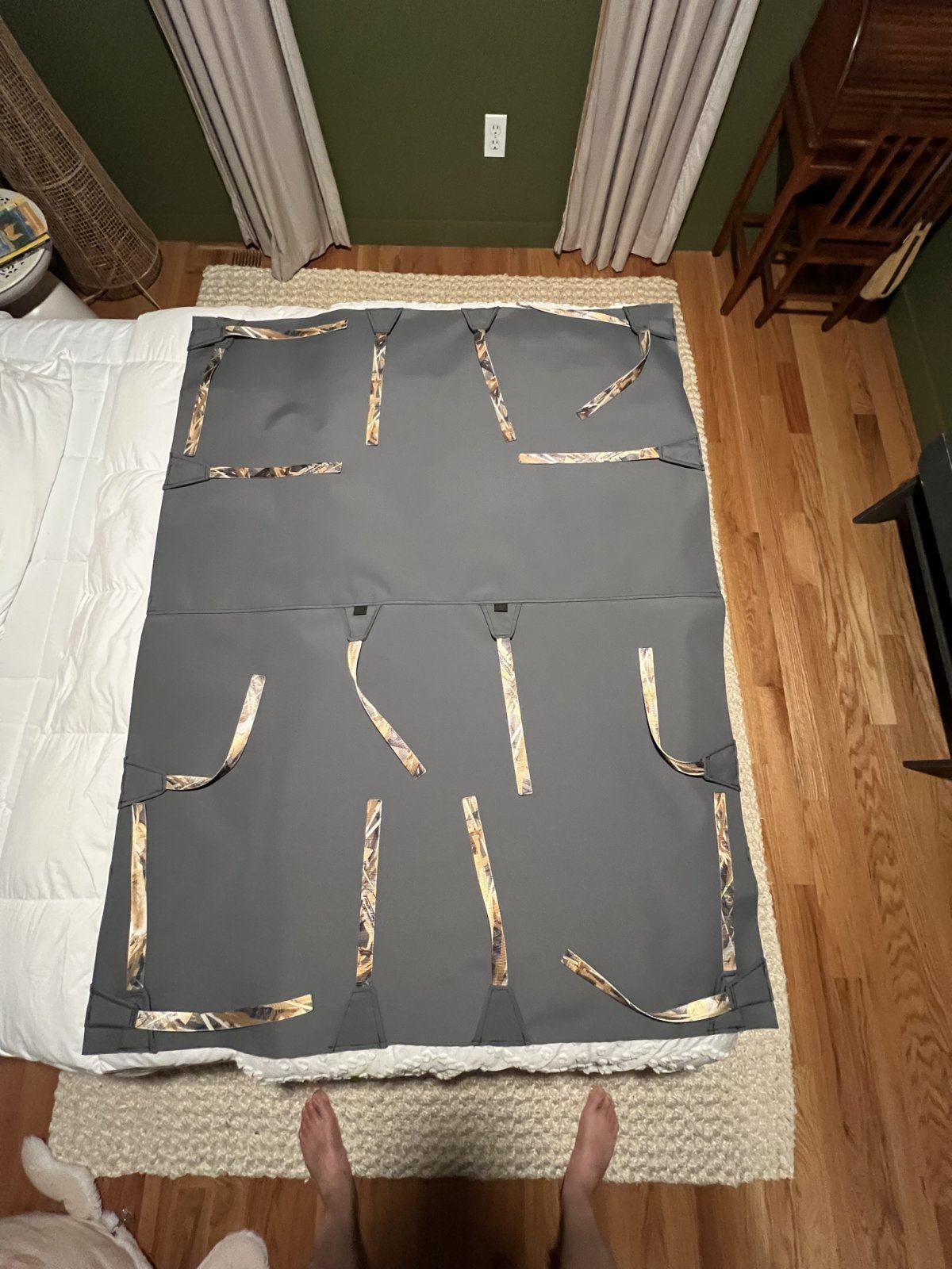

    it doesn’t flap around too much. I added a 3/4” bar at the back to keep the rear flap solid. The 40 snaps and 18 straps do a pretty good job of keeping it from flapping too much. Looks about the same as a Jeep soft top or the softopper at 75mph.

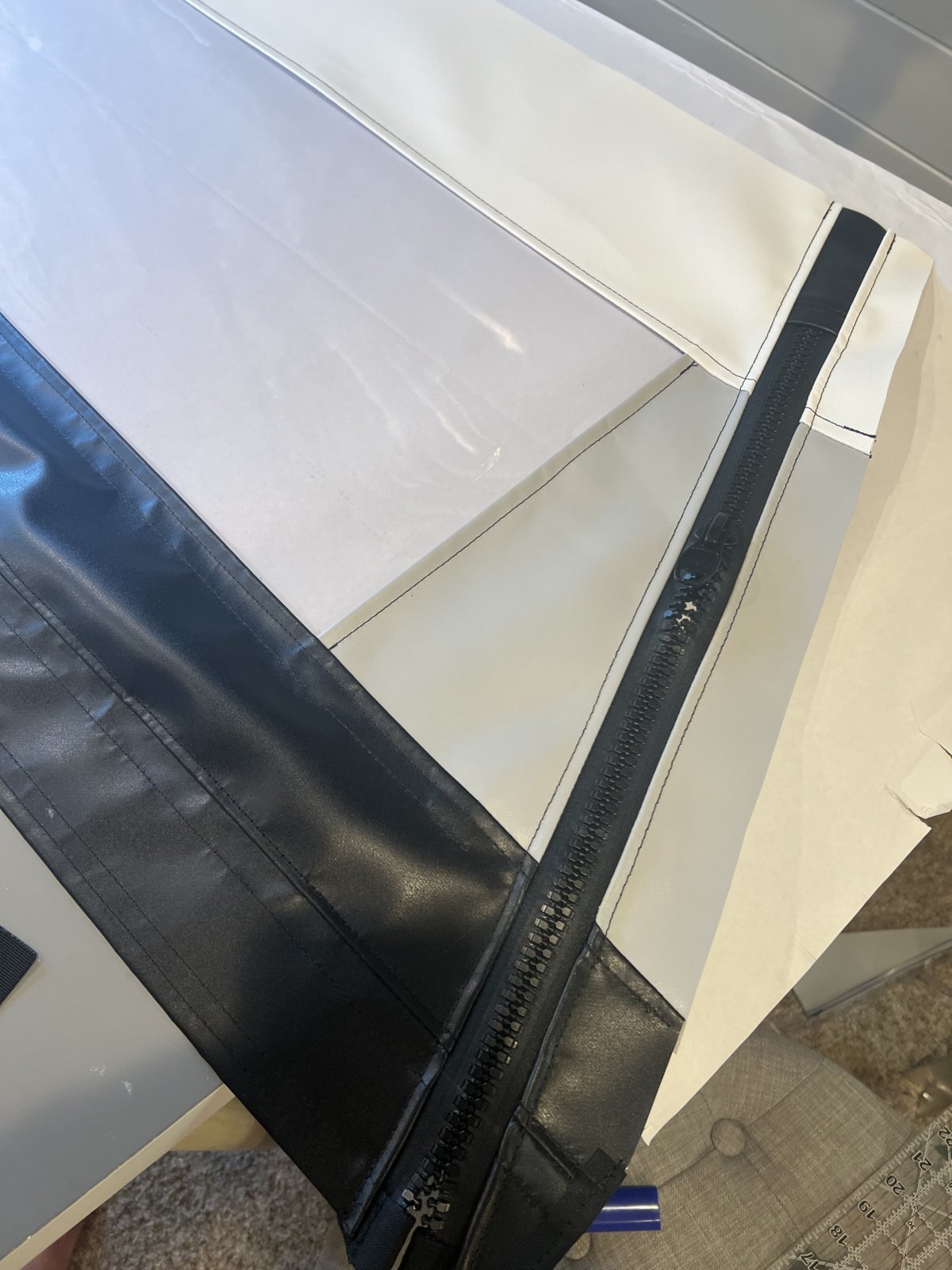

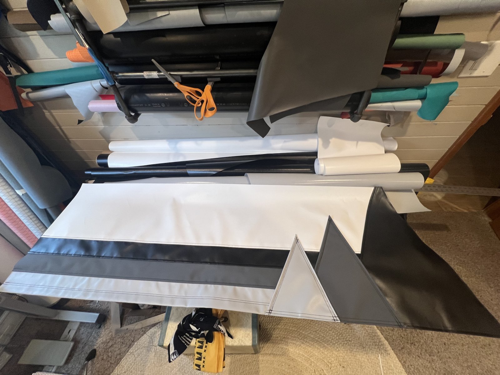

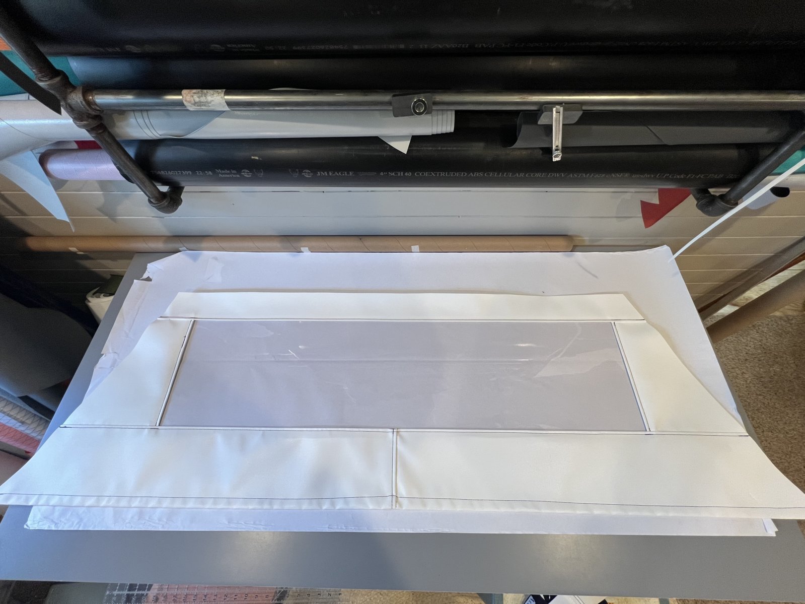

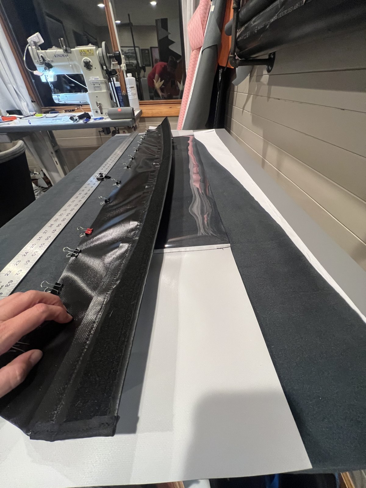

    Some pics of the panels under construction. One of the hardest parts was matching up the slight curve of the tailgate when it is closed. IMG_6476.jpgMatching up the panels on each side of the zipper took a bit of time to figure out. Also first time sewing windows. Glad to have a pair of industrial machines! IMG_6664.jpg IMG_6653.jpg
