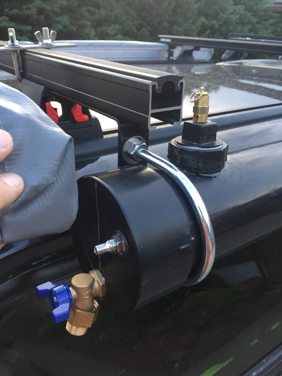

    My 4” ABS diy solar shower is roughly 5ft long and I can get 3 quick showers out of it. It holds roughly 3.3ish gallons of water.
    It’s easy enough to refill on the road. Ive filled it up with both spring water and crick water multiple times.
    I carry a collapsible 3 gallon jug I used to get water from the ground to up on the shell roof. You could do a small 12v pump too if you wanted.
    Only downside of this is you have to be near a water source.

    Mines 4” ABS DVW. It has a 30psi pop off on it.
    I was skeptical at first until I used it.
    4” ABS DVW will hold 30psi no issue. I connect my compressor to it and just let the compressor run when I use it.
    It’ll pressurize then pop off. If you don’t run the compressor while using it, there’s not enough pressure.

    5’ 4” DVW.
    It works well for what I need. It holds like 3.4g of water. I can usually get 2 good rinses outta it.
    Spray off real quick. Then turn off the water. Soap up. Turn it back on and rinse off.
    It’s easy enough to fill on the road too if you wanna a use more water.
    On a sunny 60* ambient air temp day, I’ve measured the water temp in the upper 70*s. Over summer, I’ve measured the water temp in excess of 110 quite a few times. It definitely works as long as there is a some sun.
    You could probably run a regulator off the tank to the shower to control the pressure that way.
    I use the pop off just because I connect the compressor and let it run the whole time. My air system is an open system so there’s no tank, it’s just compressor to hose
