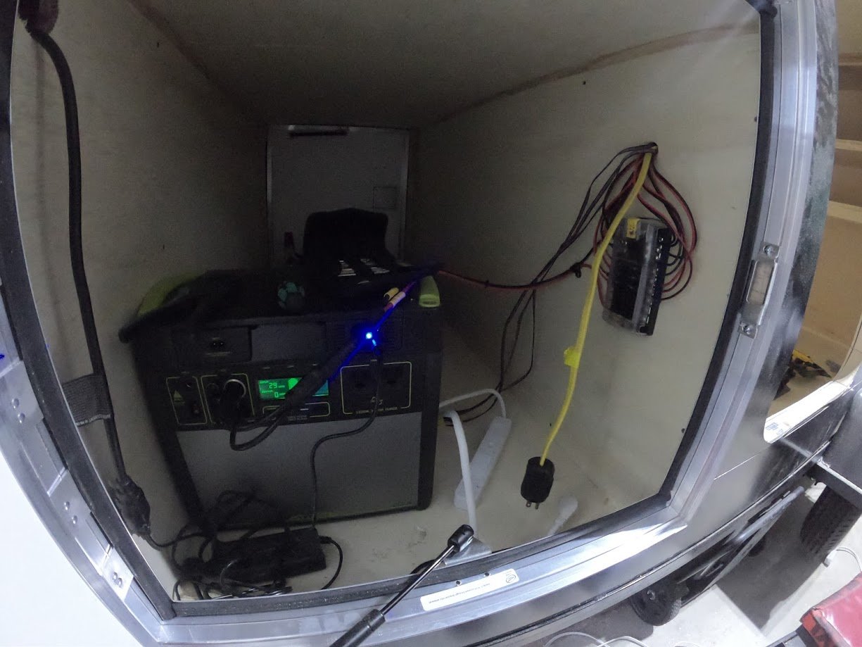

    For the inquisitive minds, here is my electrical/ fridge box (sans fridge). I'm using a Goal Zero 3000 to do all the solar charging (200 watts), the 12v and 120.
    Interestingly enough, Goal Zero sells an adapter that take all the 12v outputs to one single mini-anderson connector, which is what is feeding the Blue Sea terminal/fuse box.

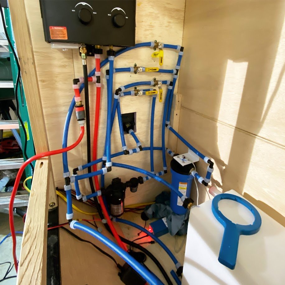

    Yes, it is a mess for the moment, BUT it works!!

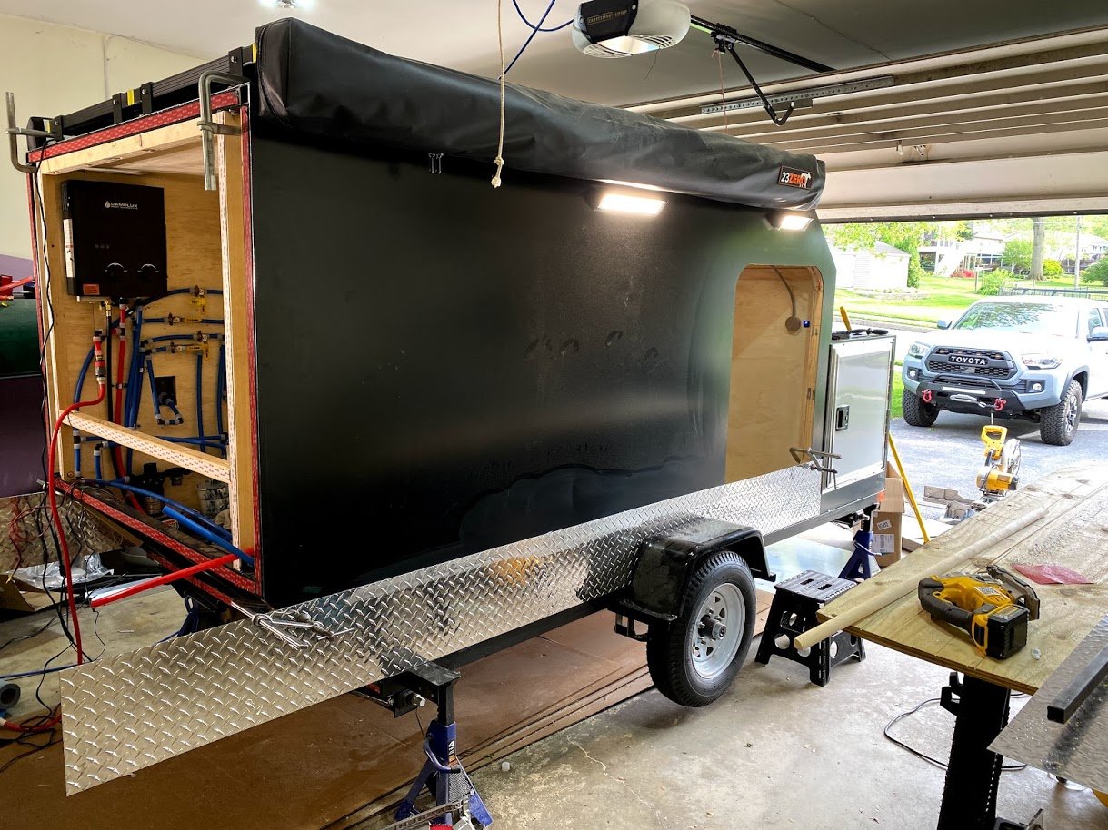

    In addition to using our shower and sink as designed, this water system will also give us the ability to pump water into the tank from a fresh water source (such as a river or lake) using the same pump. The water is filtered on the way into the tank, and as it leaves the tank. Neat!

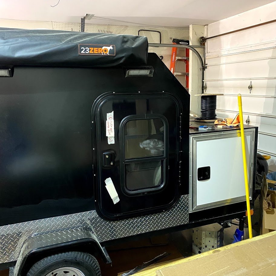

    Doors!!

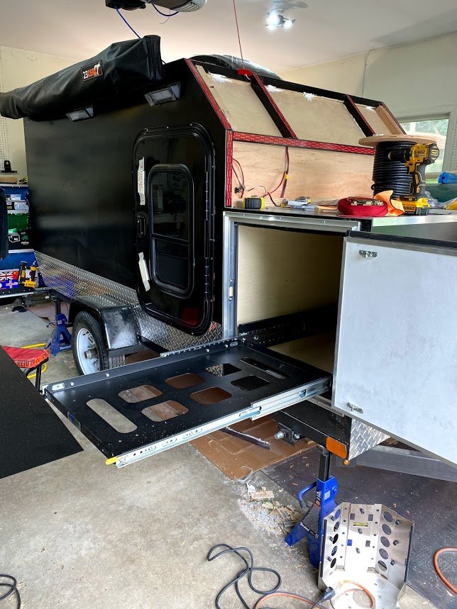

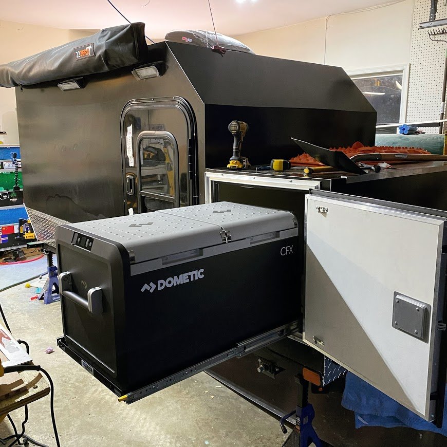

    After ordering a dometic fridge slide for my CFX3 75DZ back in February, I was recently told it is back ordered until the end of June. With some help from some fellow members, I was able to find this bad boy. I had a few constraints to work within, as you can see.
    BEAR_KNIFE_FIGHT and rblalliance like this.

    She fits! This is the most excited I've been on this build in a long time. Ice cream in the backcountry!

    Looks good! Out of curiosity, have you weighed this thing yet? Do you have a target weight in mind?

    Thanks! I haven't weighed it yet, that's on the schedule for this week. I'd like to keep the dry weight to under 2000lbs.

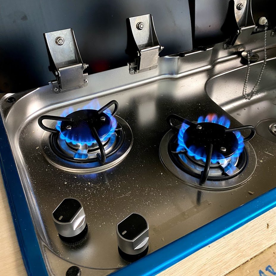

    Now we're cooking!!
    We're carrying propane with us for cooking, a hot shower, and the sink. To be determined if we add a heater for the cabin, but we have room to expand for that.

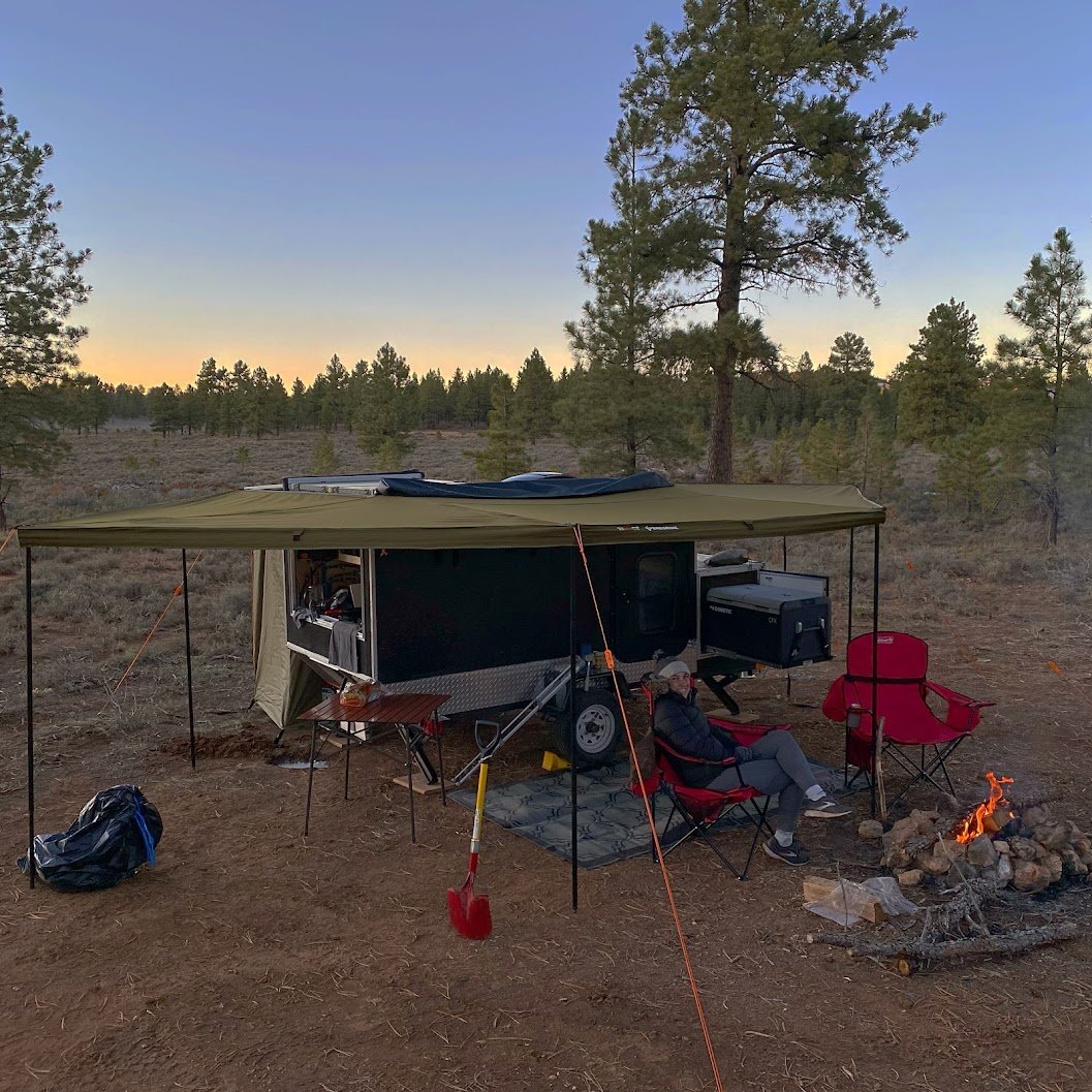

    First trip with the trailer, and it didn't fall apart! We headed down to Portsmouth Island, NC to spend the long weekend on the deserted beach

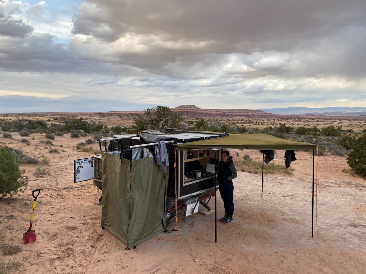

    2nd big trip down in the books! Stops included Zion, Grand Canyon, Bryce Canyon, Canyonlands and Arches National Parks. Utah does not disappoint!
