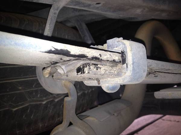

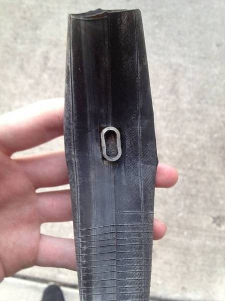

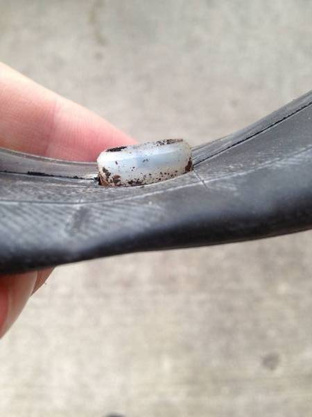

    Thank you!!!! Got this done tonight, what a difference! Although, I did it a little bit different. I'm sorry if what I am about to say is a repost
    When putting in the bike tube I noticed there was a small plastic insert, so what I did was shoved it into the bike tube and then cut a hole to let the stem thing stick out and go back into a hole to keep the tube in place rather then super glue. Pic here \/\/\/

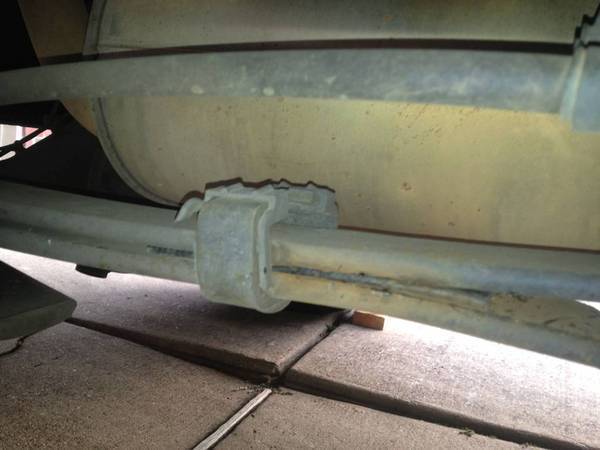

    I also did both c clips as I found that the one closest to the front of the truck wasnt the one squeaking for me, it was the one closest to the back of the truck. Pics here \/\/\/\/
    Sorry for the crappy iphone pictures
    P.S. Make sure that you jack up the truck like the OP said and clean the c clips. And make sure that you have a big enought jack
