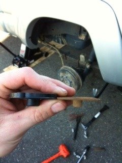

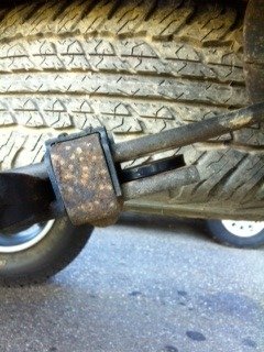

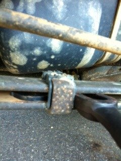

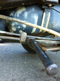

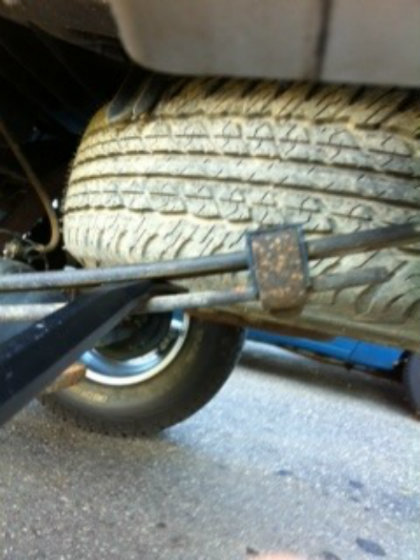

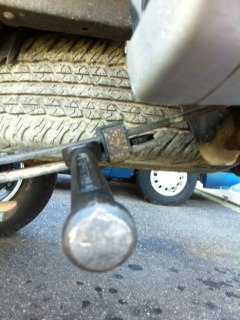

    Sooo the fuel tank straps i used for the fix started squeaking last week.
    Now... I'm +1 for the toyota bushings..
    Picked them up from the local Toyota dealer and installed them today. This is a beginner skill level job.

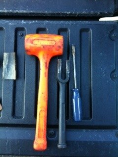

    Tools:
    1) Rubber mallet
    2) Pickle fork
    3) Flat head screw driver
    4) Floor jack
    No need to remove the tires, bushings are easily accessible without removing them. (I removed mine to check the brakes while i was back there :cool:)
    I started on the driver side rear bushing first.. as you can see driving the pickle fork in gives plenty of room to retrieve the original plastic bushing and insert the new rubber piece
    here's a comparison old vs new
    new bushing in.. it went right in using the flat head screw driver to push it into place. As tempting as it looks, don't try to stick a finger in there :eek:
    Then i moved onto the front..
    new one in..
    Repeat for the other side and that's it, no more annoying squeaky leafs :D
    Took me about 5 minutes for each side including lifting the truck.. cake.

    what size are the nubs ?
    3/8" diameter ?

    their oblong
    if you get under your truck you can see the hole in the bottom leaf

    3/4" long / 7/16" wide
