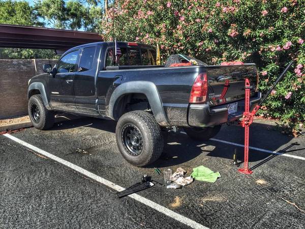

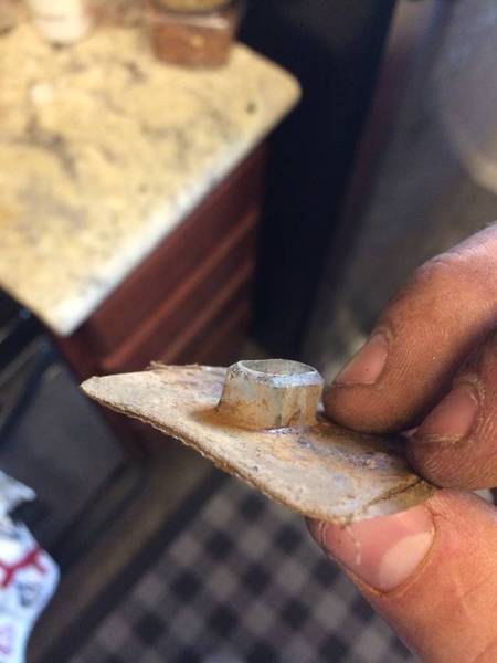

    THANK YOU! used this method (but installed the new, thicker toyota spacer pads as opposed to cut hose)...super easy; didnt even remove the rear wheels. Only tools i used were my oem jack kit, a butter knife, and a pair of channel lock pliers...plus I got to try out my new hilift!
    The old spacers...total junk:
    The setup:
