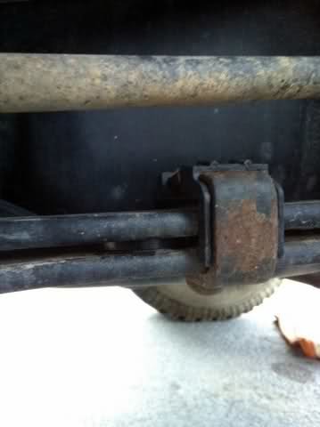

    I would if I were you. I did that to mine since I did the leaf pack and helper springs, might as well do the aal since I was under there. You dont have to take it apart. Just jack up on the frame to relieve pressure, jam a pry bar or something between the two and spread them enough to slide something in between.

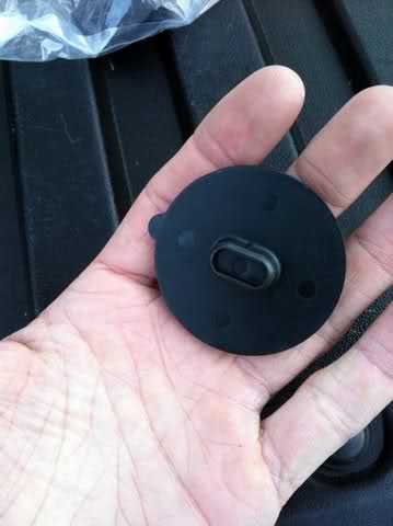

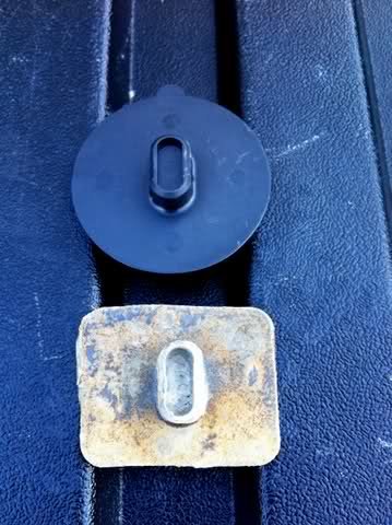

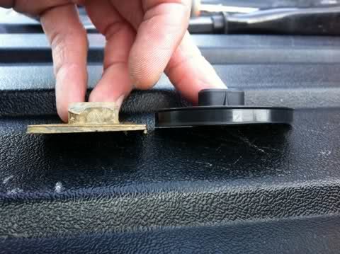

    Thanks man. . l know this is an old thread, but it was exactly what l needed. l ordered my spacers today. Are they still working as good as you thought they would. ?
