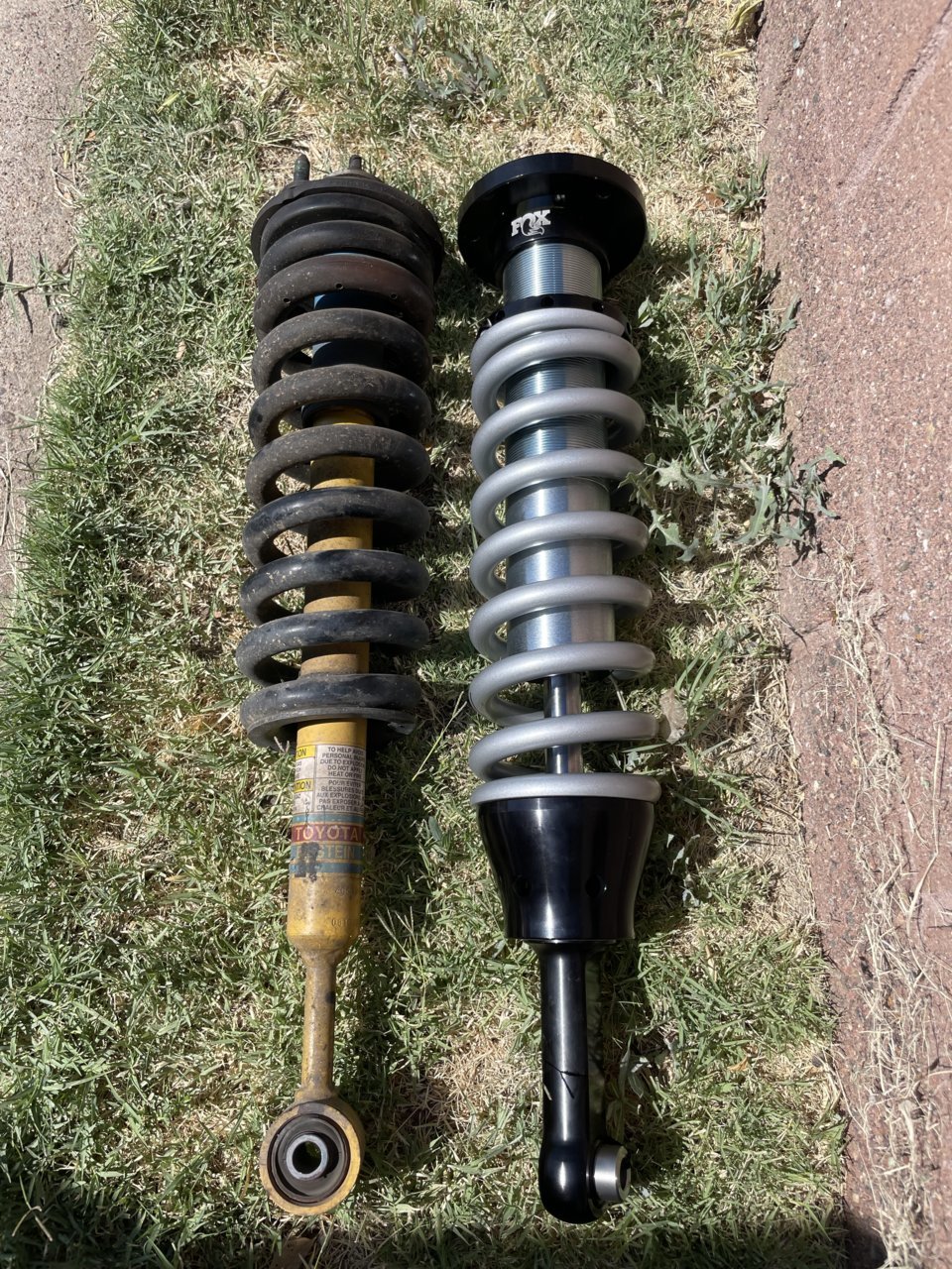

    I’m working nights right now and my coworker was supposed to wake up early and help me out today. He did not show. I was already sitting there with the truck lifted and factory UCA’s out and decided to send it and it was a challenge. Not the install itself but sitting in AZ heat in my driveway and taking my time to double and triple check everything. It took me about 5 hours all in all and I’m pretty damn happy with myself. Thank god for YouTube videos from the community, seriously. I watched them so much I didn’t even need to reference anything except torque specs. I still need to do the rear but plan on tackling that this weekend, truck is going for an alignment tomorrow when I wake up. I did NOT adjust the Fox coilovers whatsoever as I don’t know what my rear height is going to be yet, when I find that out I’ll adjust for about 1” of take. My starting hub to fender was 21” and I’m now at 23” so I’m living with the bro lean for now. If I had to do it again I would shell out the cash for a 3 ton floor jack and 6 ton jack stands, it was a pain getting the thing up. Thanks for all the input and help guys!

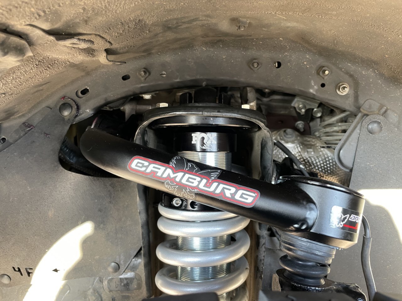

    With 65k miles on the truck now I think it was well overdue.D1DFFE0E-2A02-4DF2-9D54-26D499D3D367.jpg 89056D2A-75BB-4710-A71D-5EFDE3C5D5CF.jpg
