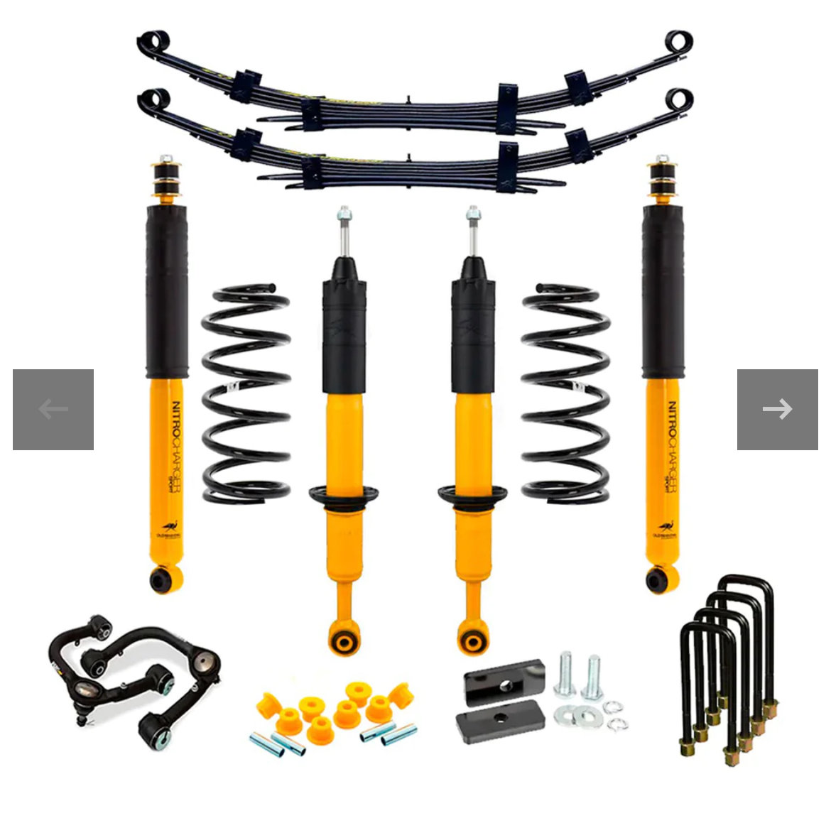

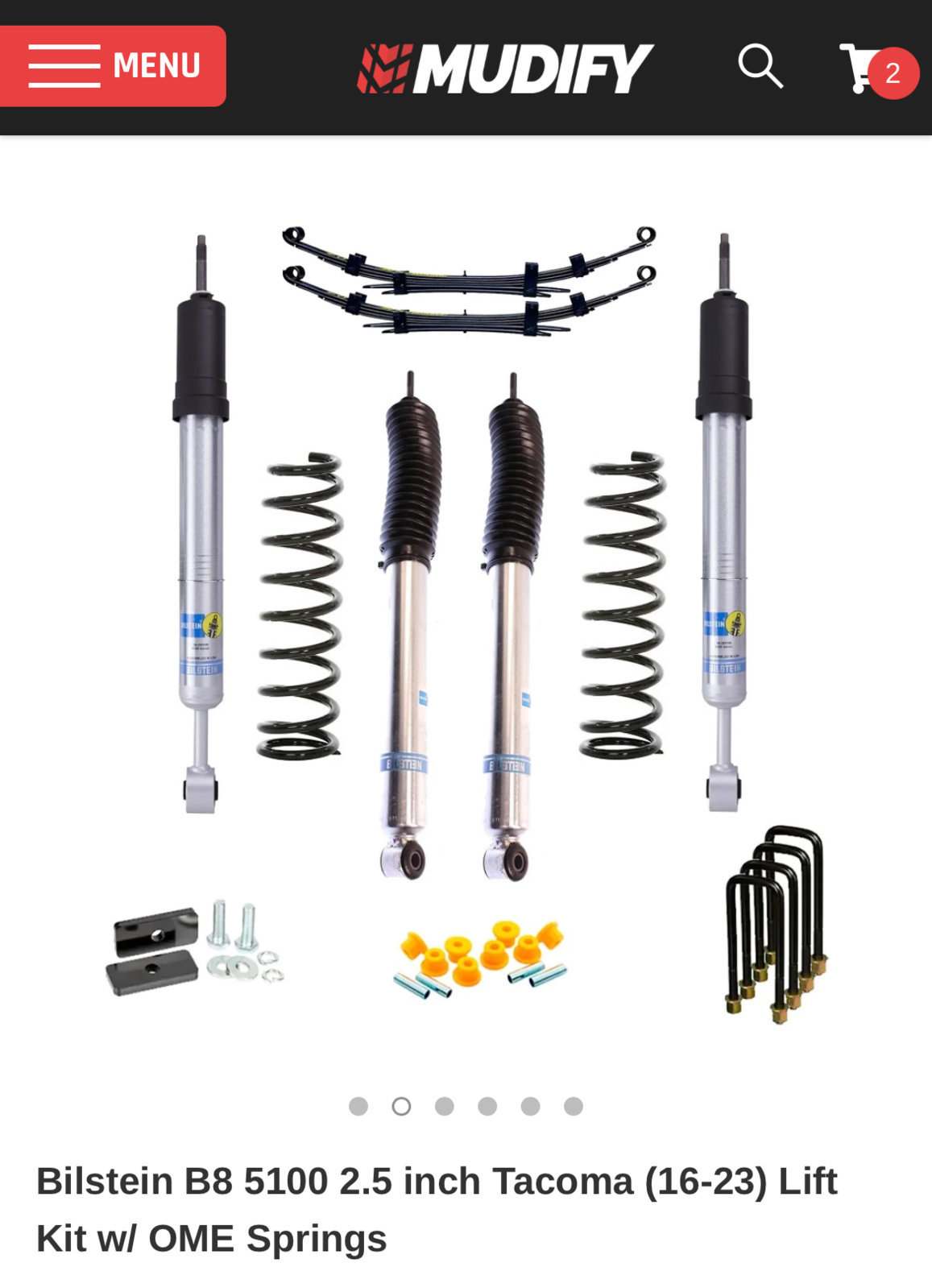

    Hello, first time taco owner looking to change the suspension by myself. I have done some mods already, but they were quite less complicated than this. Changed front bumper, headlights, exhaust, and air intake but this is definitely the most complex change I want to make. Mudify sells lift kits and I was wondering if anyone could advise if these kits include everything I need. Both are 2.5in lift kits, so I don’t think I will have to do any differential change. Really looking for something plug and play but do not want to just run spacers. Attached photos of the 2 kits I was looking into.
    -also if anyone could give opinions on these 2 options. OME v. Bilstein 5100s

    What year is your truck? I had the ome kit on my first gen and lived it, but that being said I went to fox 2.5's up front and love it even more. But if you want a all inclusive kit I can comfortably recommend the ome kit.

    The first one (5100s) doesnt show UCAs, but make sure you do those with any lift.

    Yes upper control arms are a must with anything over 1.5". Without them your alignment shop is goings to hate you, and your truck and tires wont like you much either.

    I have personally found a 1" lift to be the sweet spot.
    Here's why- I run a heavier leaf pack in the rear for handling the trailer and camping stuff, and the front is there strictly to maintain the rake. Otherwise I wouldn't be lifted at all.
    When going off-road, down travel is more important than stance. And without a full control arm replacement you're just putting your truck in high heel shoes - aka you're sacrificing down travel for stance. Not clearance. Just looks. You get clearance through tires, and even then, you're getting about an inch. Meh.
