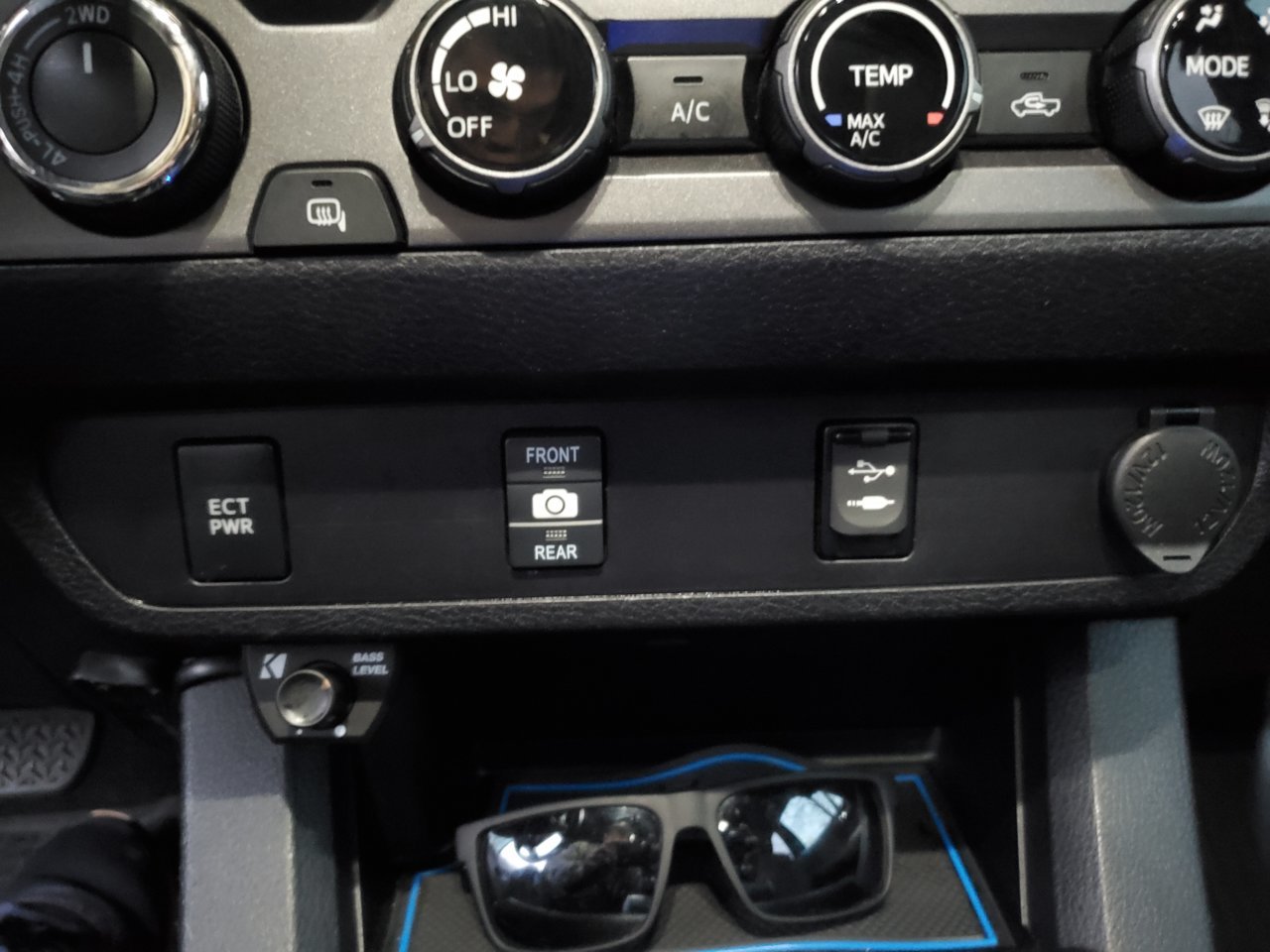

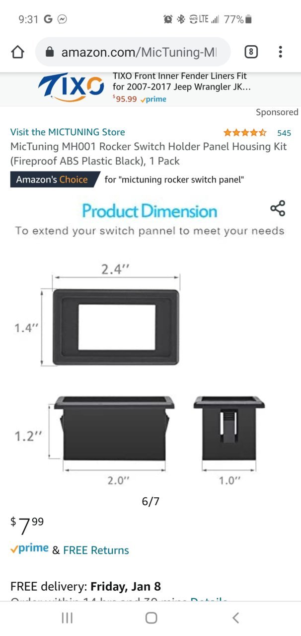

    Do you know if hats the “normal Toyota switch size”? It shows rocker switches in the pictures. Not even sure if there’s a difference to be honest, but figured I’d ask.

    Yes cut out, snap in and install switch.
    And you can get these inserts for different size switches.

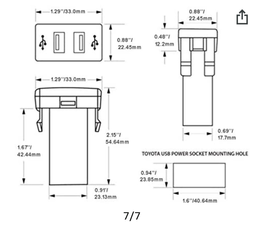

    Anyone know the OEM switch dimensions

    I can confirm the following as I have used both.
    Taller switch dimensions:
    Shorter switch dimensions:
