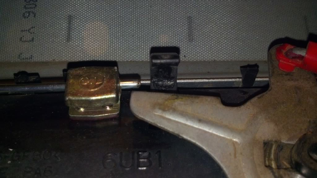

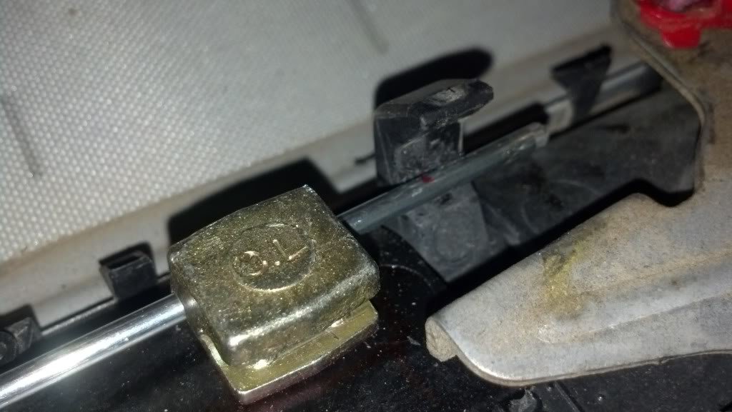

    First of all very nice work, I am definitely considering this mod.
    I am curious though, do you ever have a problem with the slide bolts catching as pictured above? I'm guessing it would only be a problem on the side with the catches on the bottom if it happens at all.

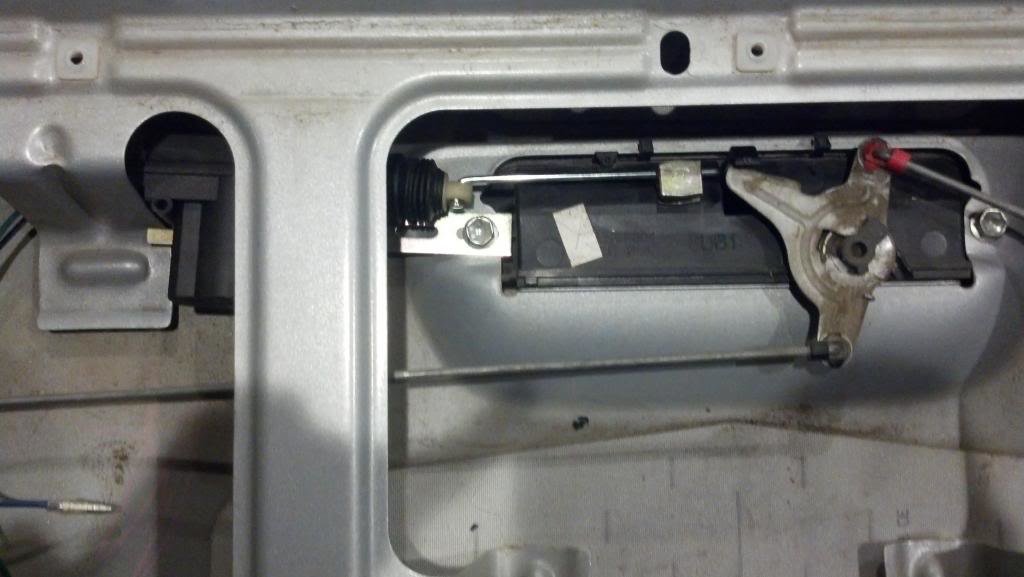

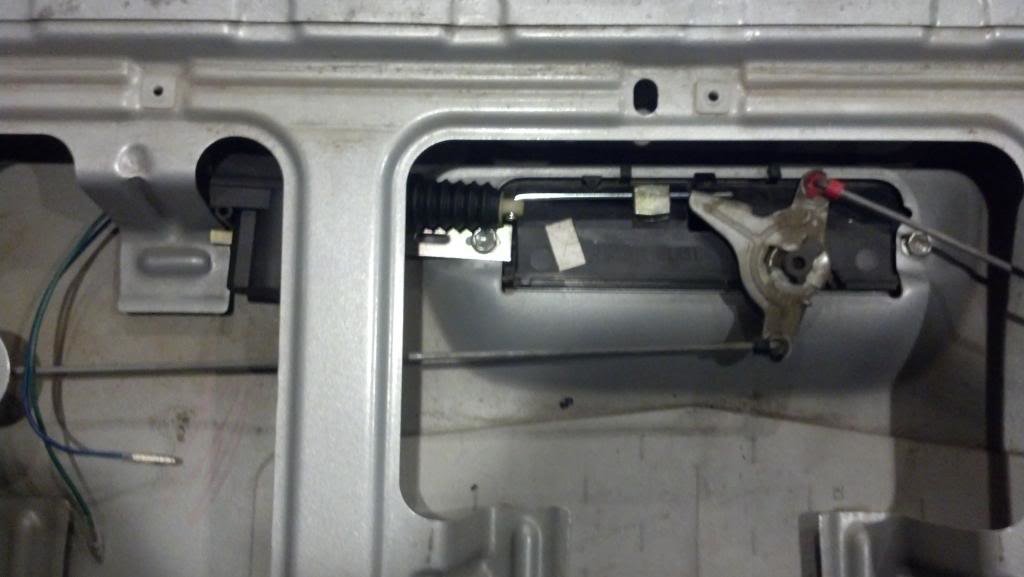

    I know this thread is pretty old but I have another idea that I just started working on tonight. I picked up most of the parts you suggested from a local member. I used one actuator and rod to secure the back side of the handle. I had to notch out the plastic a little to allow the rod to slide into place but its only semi permanent and holds the handle very securly. I'm pretty sure the handle would break before the rod does and if thats the case the tailgate still would not open. I haven't wired it yet but I will still using a dual relay set up (one for the tailgate and one for the canopy lock). Here are a few pictures:
