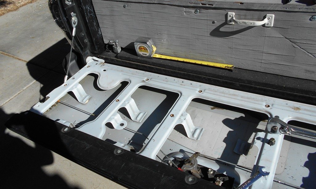

    Nice. That'll stand up to some abuse. For the center row of screws, what did you screw into? I'm assuming the factory sheet metal crossmembers. Also, what type of screws did you use for that?

    I replaced all of the factory attachment hardware (except up at the cap row) with Rivenut threaded inserts and 1/4-20 stainless button heads. Decided I ought to also utilize the cross-members, so I laid out the pattern on the cover, drilled it, then transferred the pattern down onto the t-gate.

    Rivnuts... how it shoulda been done from the factory. Nice!

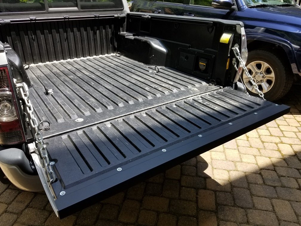

    Now you need to do the chain support mod ;)
    4000 miles 2 motorcycle rear tires sitting on tailgate no problems.

    It is probably obvious to most, but in your chain support mod, are you locking a chain link into the tailgate latching mechanism?

    Are those chains loud when you go over bumps with the tailgate closed? Do you only put them on when you need them?

    Yes, feed the last link into the lock latch mechanism until it clicks twice (very important). Thank you for the kind words on my build thread. I have to admit this chain mod is not mine. I found it on TW about 2.5 years ago when I was researching ways to reinforce tailgate. I don't even think the original inventor is known, the guy who posted about it said he got it off of someone on TW.

    Only used when I'm transporting motorcycles. Go on and off very easily, you can't leave them on and close the tailgate.

    Thanks, I realized right after I posted that you couldn’t close it with the chains on. Great idea though for what it’s used for.

    I've got my chains for the tailgate made a bit shorter to carry it at an angle. So the top edge of the gate is held up to a height that matches the notched supports in the sides of the bed lining. That way, with some sticks fitted across the notches - you can carry an upper, longer piece of building material without the droop. Check out my album.
