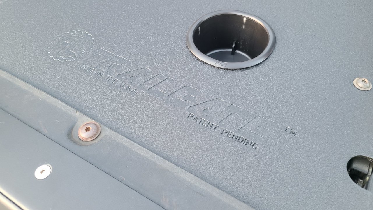

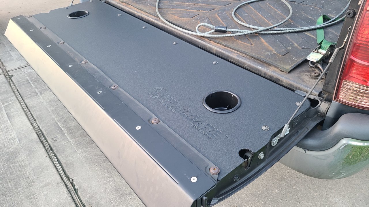

    I also like what the OP did. Plain and simple ,and by far a motivated approach of DIY goodness, rather than leaving it alone.
    After looking through this thread, I now want to rivnut my aluminum cover to my tailgaters support ribs. The combination of the angle iron that I welded in under the skin, this plate, and the wing supporting the top section, the rivnuts would tie it together.

    Did you have to bore out the holes bigger with a drill bit to fit those?
    Maybe I will just go ahead and order that size or will remove the skin to measure the hole diameter with measuring calipers to try and match a rivnut size
    At least one of my stock holes is stripped even after taking gentle care tightening any of the torx bolts trying to not strip it; I guess they’re just fragile/weak
    I wonder if there are cup holder inserts available standalone
    Currently running the aluminum full wrap around relentless fab skin and it looks like a good idea to take a hole saw to it, to add cup holders
