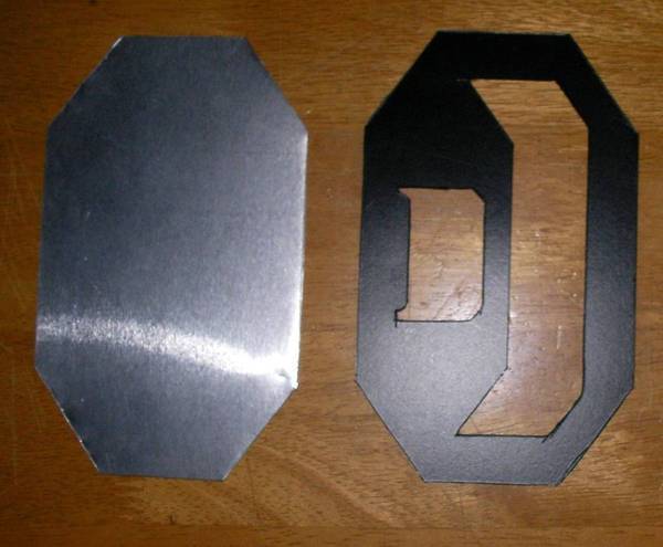

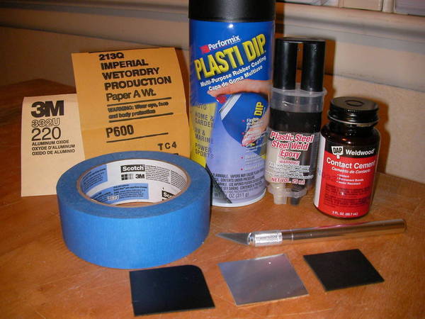

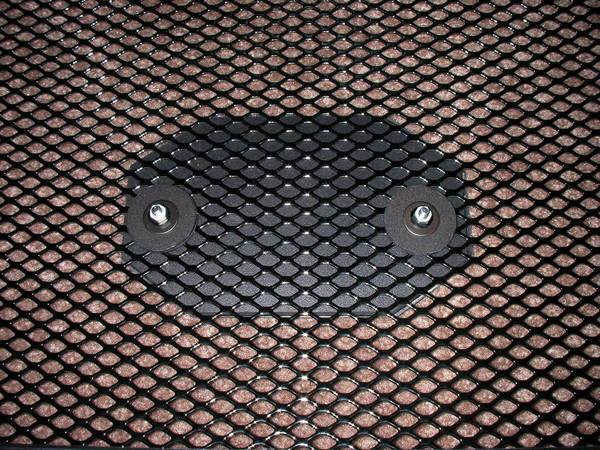

    Basically your just sandwiching the aluminum between the top layer plastic and backing layer rubber
    Materials are:
    Black plastic License Plate (The kind the dealers put on the cars on the lot) But not a super thin one, a good quality one that's not very flimsy but kinda soft and easy to cut with exacto knife
    Thin sheet aluminum from Lowes SteelWorks (.025 Thickness)
    Backing is 1/8" Thin black sheet rubber
    I printed out the Toyota Trucks logo from the internet and made a template and traced that onto the plastic
    Plastics/rubber were cut out with Medium exacto knife---Thin Aluminum was cut out with sharp scissors
    All the layers were lightly sanded cleaned with rubbing alcohol and bonded using DAP contact cement with brush applicator
    Plastic was painted with black Plasti-Dip 3 Coats
    Used steel weld epoxy to bond bolts to aluminum for mounting

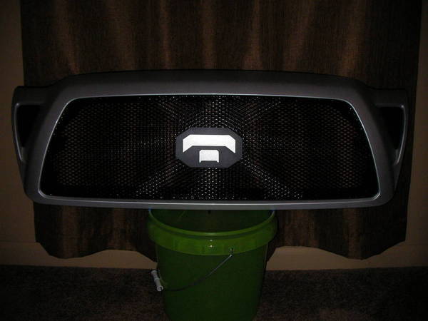

    I like it, alot. Only gotta criticize one thing, it seems that you need to be almost perfect cutting along the holes of the mesh. One side is jagged, while the other side is smooth.
    Hell I could throw this together in like 10 minutes at my work, love it!
  9. Jan 30, 2011 at 10:35 PM
    blazze2005
    blazze2005 [OP] Well-Known Member
    Jan 18, 2010
    #29594
    965
    South Jersey
    05 Tacoma Pre-Runner Sport
    Fuel Off-Road Octane Wheels,Yokohama Geolander ATS 265/65/17.Grillcraft,Borla Exhaust,Truxedo Lo Pro Tonneau Cover,Pop n Lock Tailgate Security,Custom Wet Okle TRD Seat Covers,Catch-All Matts,Gatorback Belt,Shorty Antenna,Toyota Bed Matt,Sirius Radio,Vent Sades,20% Lumar Window Tint
    Brian' actually you wont see that when the emblem is finished
    I didn't even epoxy anything yet,Once that solid back plastic center piece is totally lined up you wont be able to notice it:)
    It's the solid center piece that makes it so the edges are clean against the Aluminum not the mesh...
    Thanks Glad U Liked it....

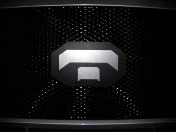

    Ok I had to leave out the mesh piece cause no matter what plastic glue or epoxy I used, it just wouldn't bond good enough
    So top layer plastic
    Middle layer aluminum
    Backing layer is rubber
    All 3 layers were bonded using DAP contact cement with the brush applicator
    Just gonna do one more coat of epoxy on the studs just to be safe. Then I'll get the pics up of it on the truck

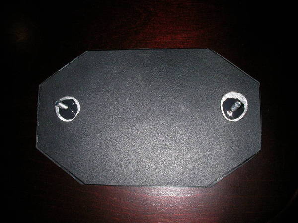

    Used Metal epoxy to bond bolts to aluminum
    Also you can see the rubber I used for the backing in this photo,Cut out circles to expose aluminum
    Some rubber,plastic,and metal washers to attach the emblem

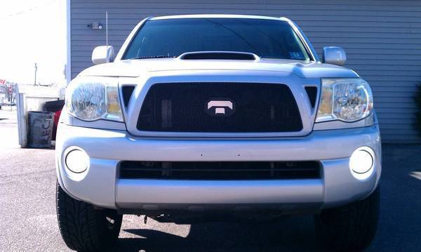

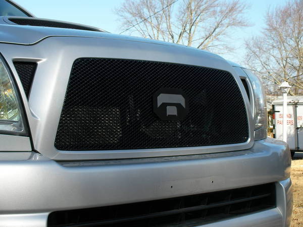

    Got the emblem all mounted up today:D
