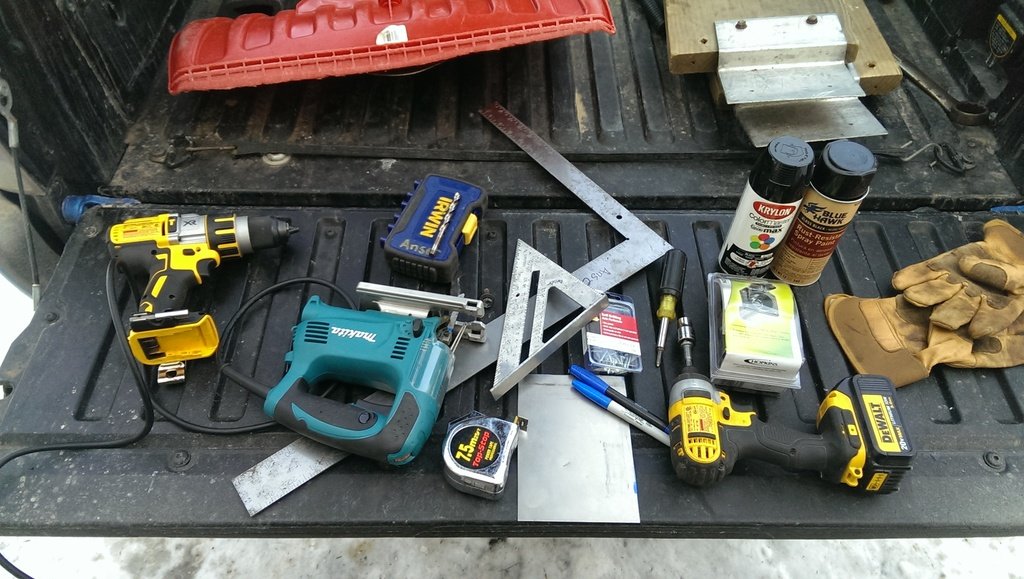

    What you will need: piece of steel, heavier gauge, not to flimsy. Jig saw with metal blade. 12mm socket and wrench(I used my impact gun). Vice, mini sledge(regular hammer should work fine too. Screw driver, 5/16 bit(I think that was the size I used, if not I will edit) Some self tappers to attach the harness in place. Markers, True Square. Tape Measure. Paint if you are so inclined and have it laying around.

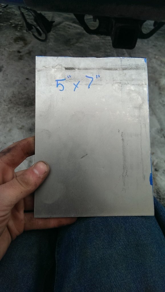

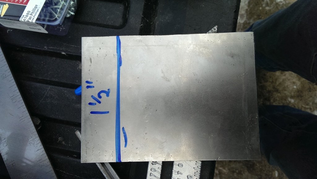

    First step will be to cut a piece of steel to the right size. I cut a piece 5x7, there is enough room to go 5x8 if you have the stock spare.

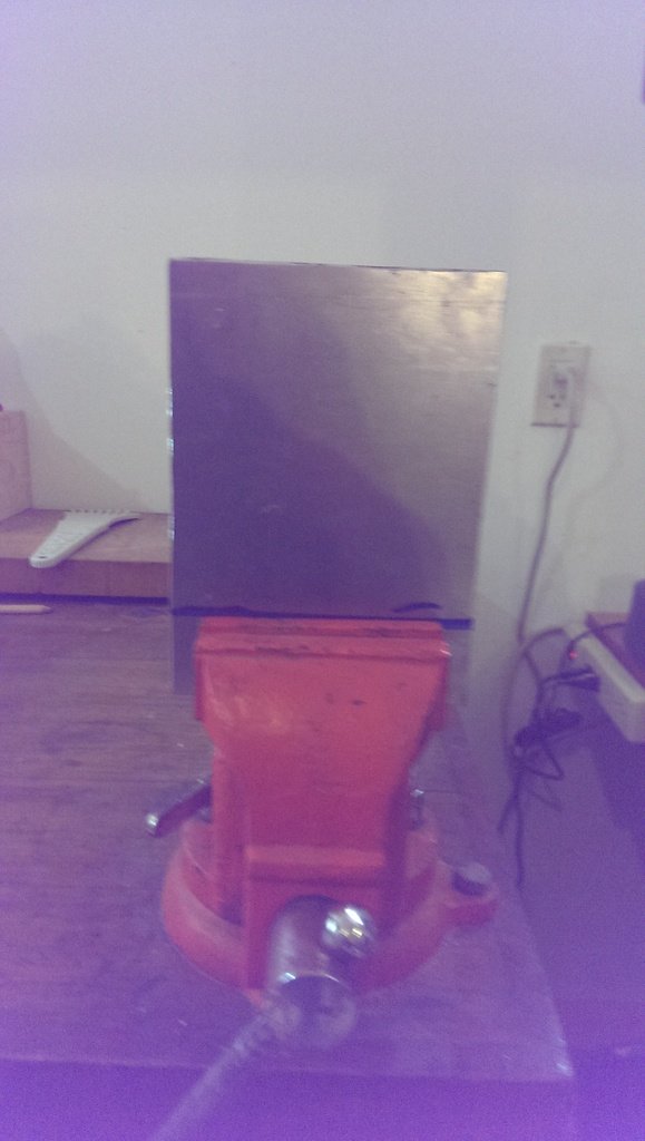

    Once you have done that measure measure 1 1/2'' down, you will be bending a 90 degree angle here in the vice.
    Then head to your vice
    Hammer it so it bends on the line

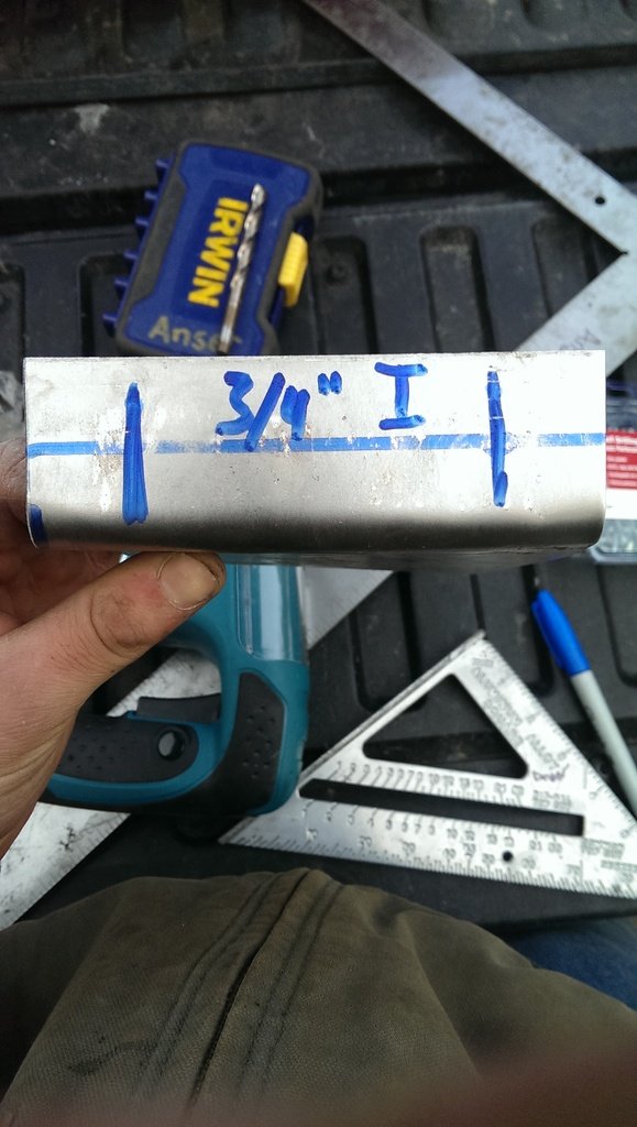

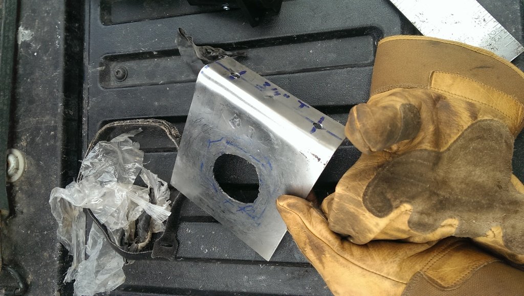

    Now measure 3/4'' down on the bent part and make a line using a straight edge. (you will be drilling here in 2 steps)

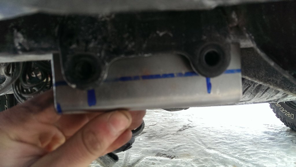

    Remove the mounting bracket screws. Hold the bracket up to the mounting holes and use your marker to mark on the steel where it lines up.
    Now make those lines very apparent

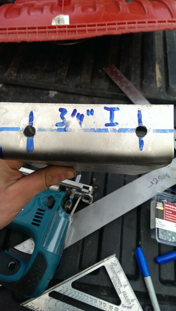

    Drill on the cross hairs

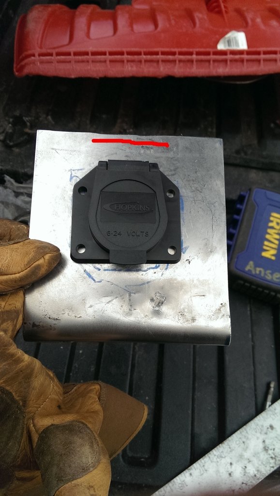

    Now comes the tricky part,the best thing you can do here is take your harness off and mark on the steel how and where to cut, making sure you have enough room to have the screws mount up as well. This wasn't too diffulcult for me because I had a new harness anyway. BE SURE YOU LEAVE ENOUGH ROOM FOR THE HARNESS TO CLEAR THE CROSS MEMBER OF YOUR HITCH, IT WILL HIT IT IF YOU DO NOT.As in make sure the harness is close to the spare tire, basically if you start cutting a half inch from the front of the bracket you will have enough room. Trust me I found out the hard way. You want your harness to sit as close to the edge as possible on the bracket, I drew a red line on the second photo to explain better

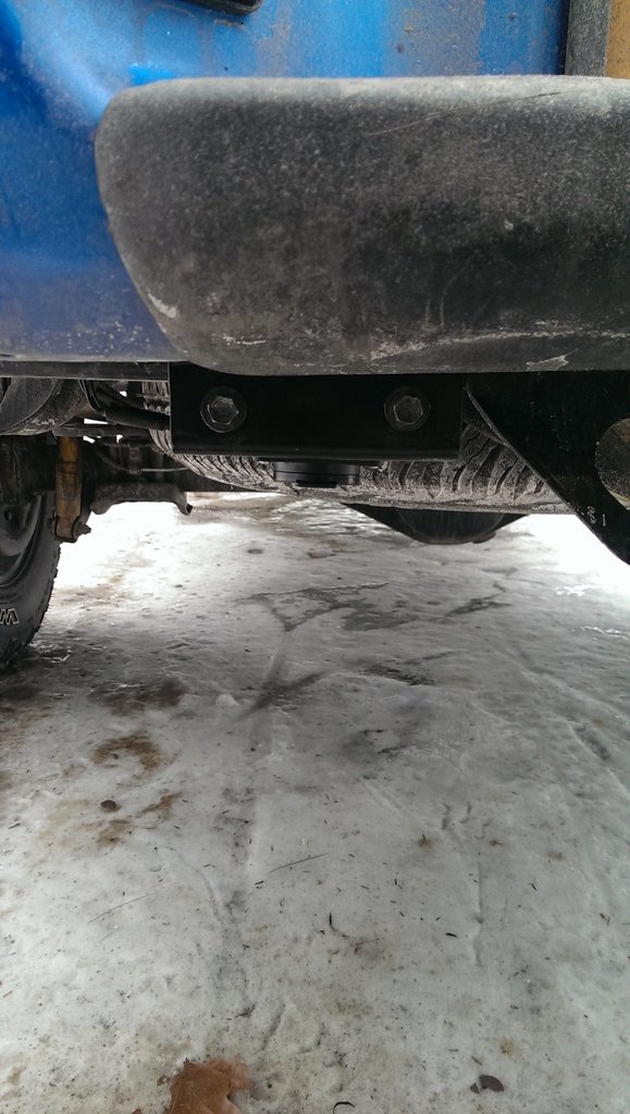

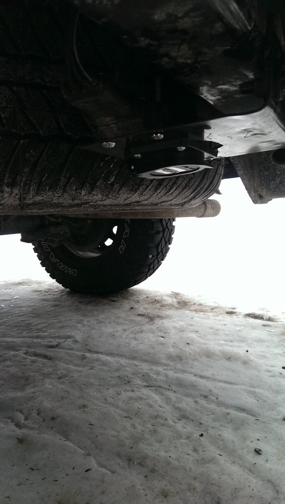

    Paint it and mount it, done.
    This did not take me long at all to make. A few notes, If you trace the wires off the wiring harness up to the cross member there is a wire tie, cut it and it will give you a lot more room to move the harness around. WEAR GLOVES AND EYE PROTECTION, METAL IS SHARP WHEN YOU CUT IT, DUH.

    Do you think it's in a position that will get caught by rocks/stumps very easily?

    No, it is above the hitch receiver and the spare, so the spare would have to be getting beet to shit as well as the receiver
