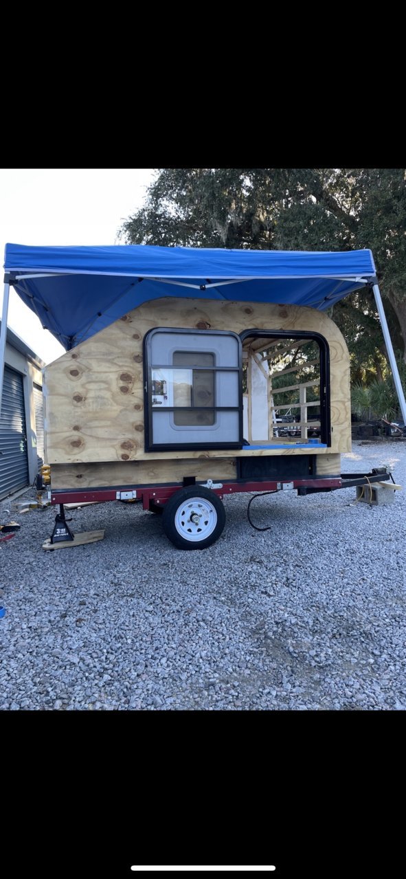

    Been working on this for a couple of weekends now. My goal is to produce a camper that weighs 500 pounds with some gear in it. This video shows the shell is about 80% complete and it's around 200 pounds give or take. I want the ability to close the tailgate similar to the Kimbo. This is a 5ft double cab truck....I have not been able to find any 5ft builds or commercial products. Hopefully this build will be a useful reference.
    I want something that is large enough sleep comfortably but not some huge hulking thing that loads the truck down and makes it tippy.
    Lot of work left to do....I will post updates as I complete work. Will be working on the inside over the winter. The outside will have to wait until spring because I plan to use bed liner.

    Harbor freight 4X8 trailer?
