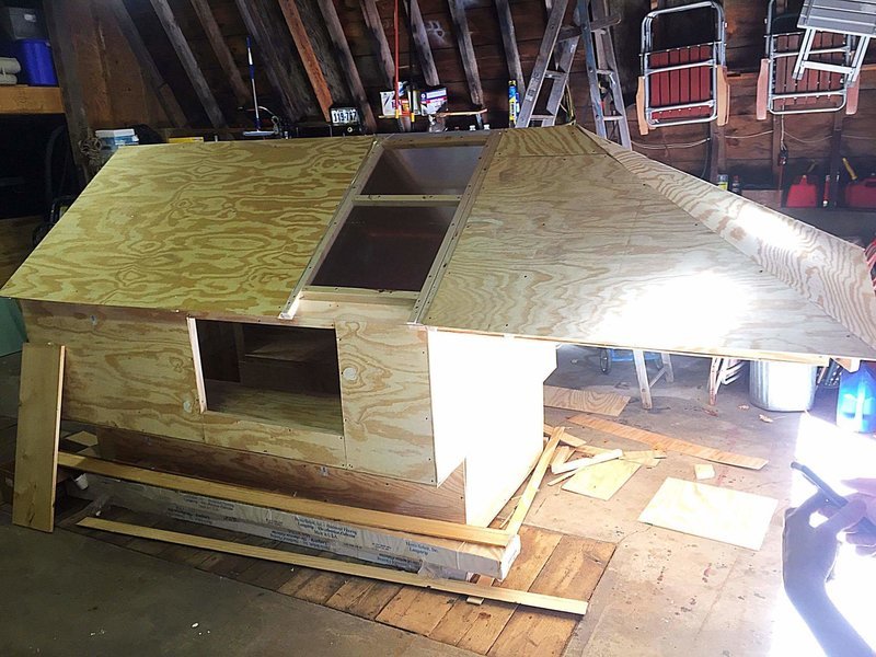

    Bed truck campers cost arm and a leg so I can see why you wanted to make one yourself. Thing is... they do not cost arm and a leg because they are inherently expensive. It is all the cabinetry and plumbing and other things. If you swing by camping supply stores or even better RV junkyards, you can scoop up some goodies very cheap.
    Only change I would suggest is to get rid of gable roof and put an arch on it. It will give you more head room.
    I drove around for a while with my teardrop camper and headroom was an issue. Taller = better.

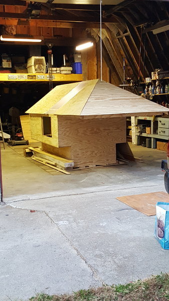

    Today's improvements

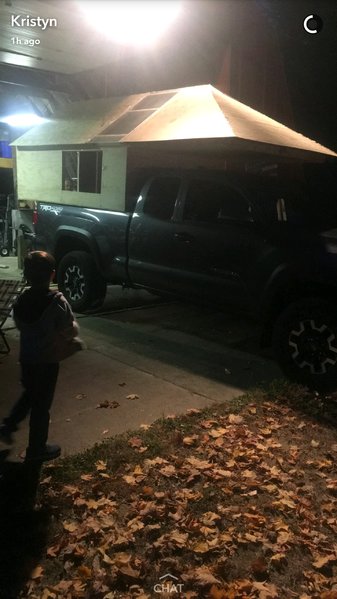

    I put the camper in the truck today to weigh it. 700lbs on the dot.

    Looks like a giant wind break. Does that front lip not catch air?

    Not just that the aerodynamics?
    with that type of roof I wonder if that will cause issues with wind. not just normal camper issues MAJOR issues.
    It does say somewhere in the owners manual about those tie downs.
    If I remember right its only supposed to be 70lbs per tie down.
