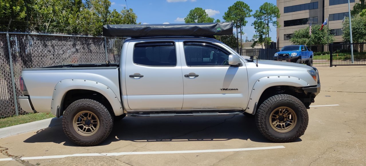

    I've been running long bed flares for quite some time now. You just need to squish the rear in and bolt it in. I trimmed the bottom front area of the rear flares.

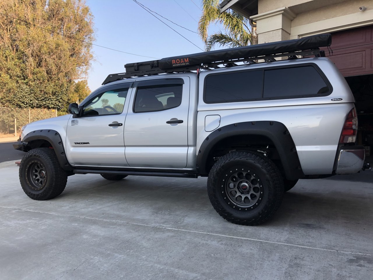

    1in bolts didn’t work for me. The RDJ flares is bit wider. Had to source 1.5in bolts and lock nuts. End result looks fantastic. Thanks Nimble.

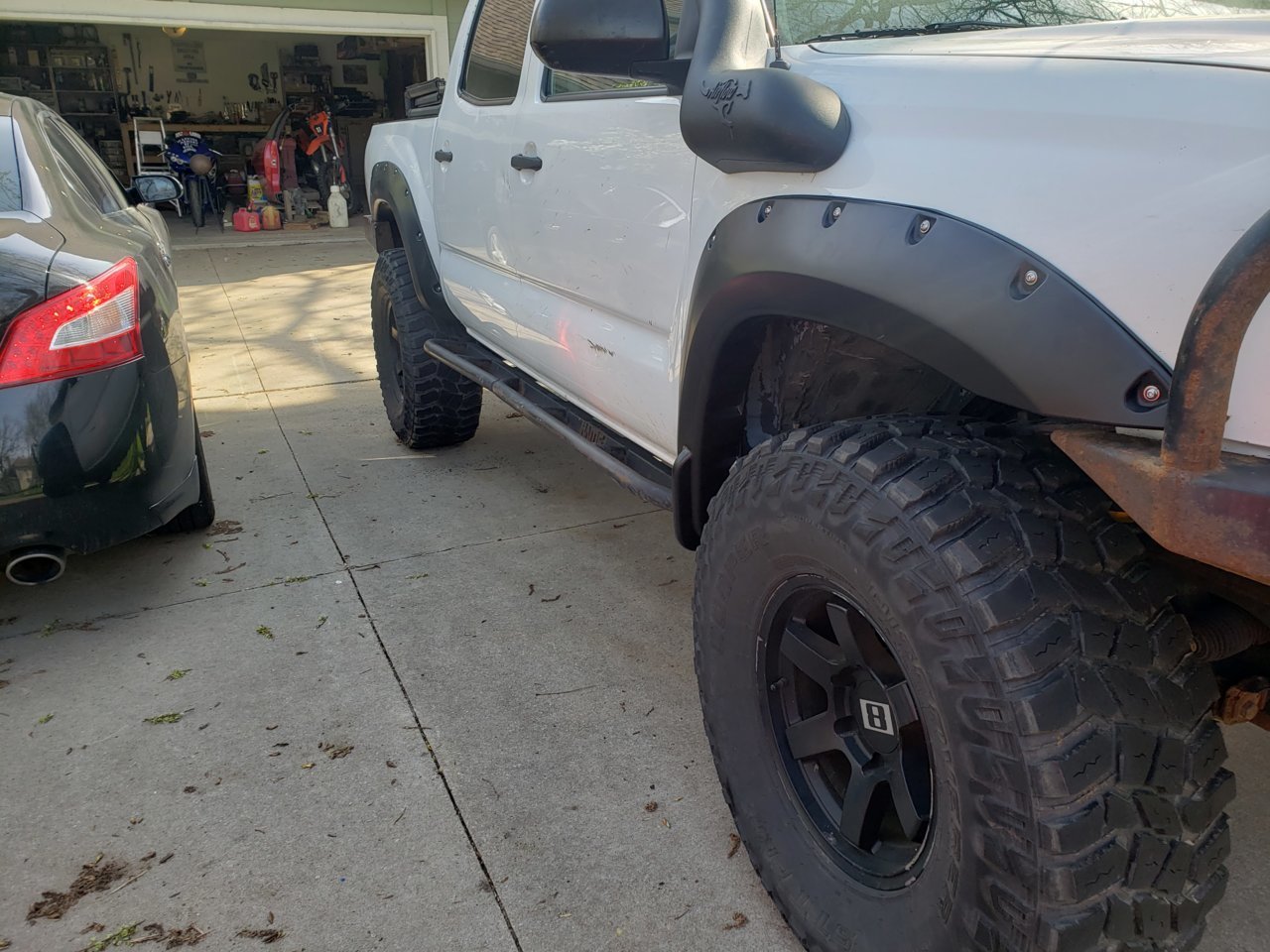

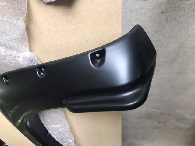

    Hey guys, did yours have these ‘mud flap’ flare outs? BCFF1A35-B1D9-4356-BD9A-DB6F3AD88A87.jpg8C385732-BB52-4A32-8786-0D6AD62CDF05.jpg 8C385732-BB52-4A32-8786-0D6AD62CDF05.jpg

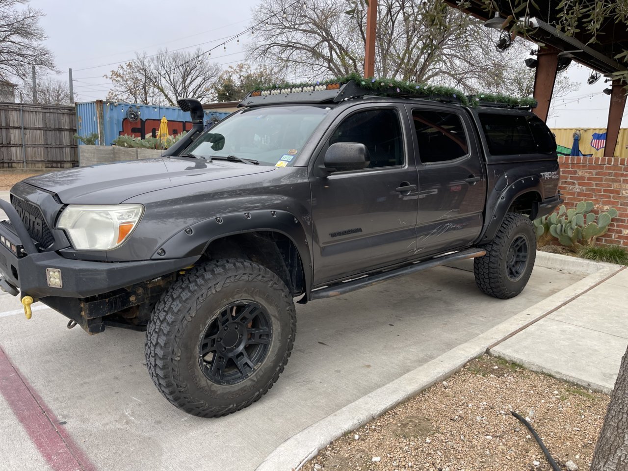

    A5B83268-4A9F-4E2D-A3AB-C31AE686F27D.jpg B35D5175-298F-4113-BB94-13E0C3A2759C.jpg The answer is Yes. :)

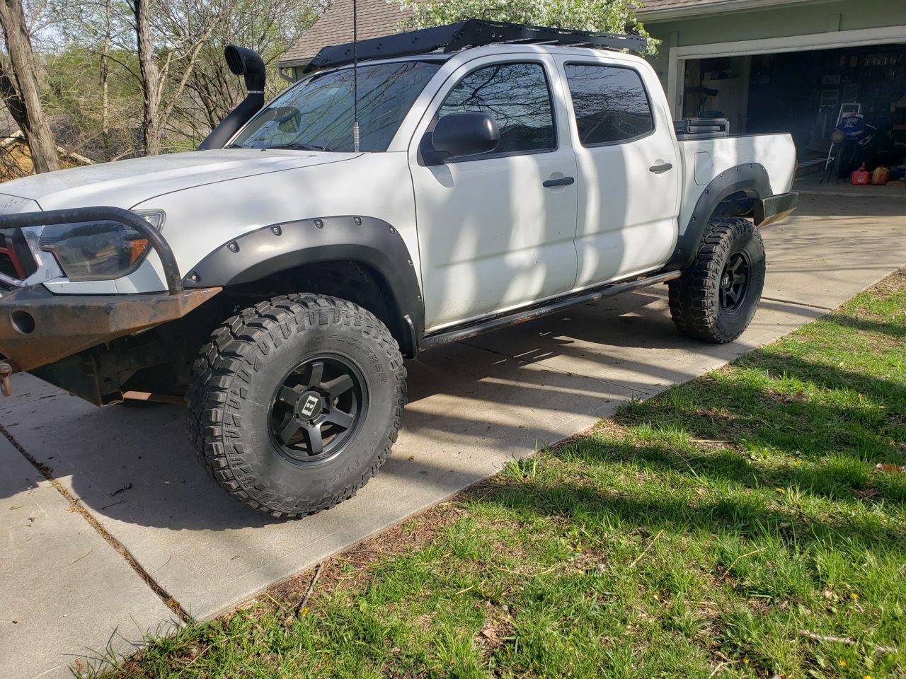

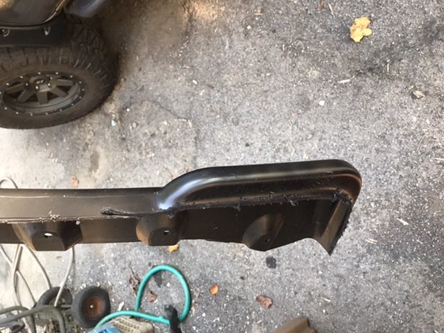

    Put mine on today. Fronts are easy, i only drilled the two rear lower holes. Backs had to drill all of them but i wasnt too particular since my truck is pretty beat up anyways.
    I didnt trim them so they took up more of the wheel well and kept the strength from the extra material. Just cut off the flexed in part front of rear tire.

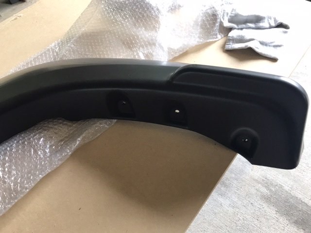

    I had a fender flare fly off driving down the highway, so needed a replacement. Found some legitimate Bushwacker flares for cheap on FB marketplace, so figured I'd give them a chance.
    Fronts went on no problem, same as everyone else.
    However, for the rear, if you start with the "top" bolts, you can use the existing holes for almost all of the bolts; second from the bottom at the front of the flare still needs to be drilled. They often take some persuasion to fit, but plastic is flexible. I'll try to take some pics in the daytime.

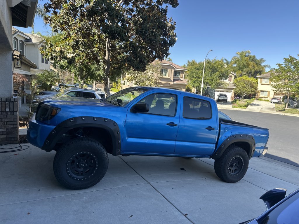

    Got mine for $20 on marketplace
