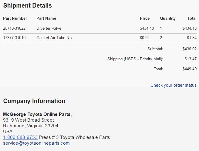

    Its really a straight forward install just make sure you have the tools the OP recommended and i would probably add a set of ratcheting wrenches and a universal joint. I was throwing codes P2440 and P2442 in the beginning and then just code P2441.
    The link the OP posted is no longer active so here is an updated link with the P/N that I used: https://toyotaparts.mcgeorgetoyota.com/oem-parts/toyota-diverter-valve-2571031022
    I also purchased the gasket air tube: https://toyotaparts.mcgeorgetoyota.com/oem-parts/toyota-gasket-air-tube-no-1737731010
    I cleared the CEL and replaced the parts. and no problems since (did this over the weekend)
    Hope this helps anyone else out in the future!

    The part numbers and online store link are in post #4

    Post #4 was has the part numbers and site where I got them, was the lowest price I found and shipped very fast.
