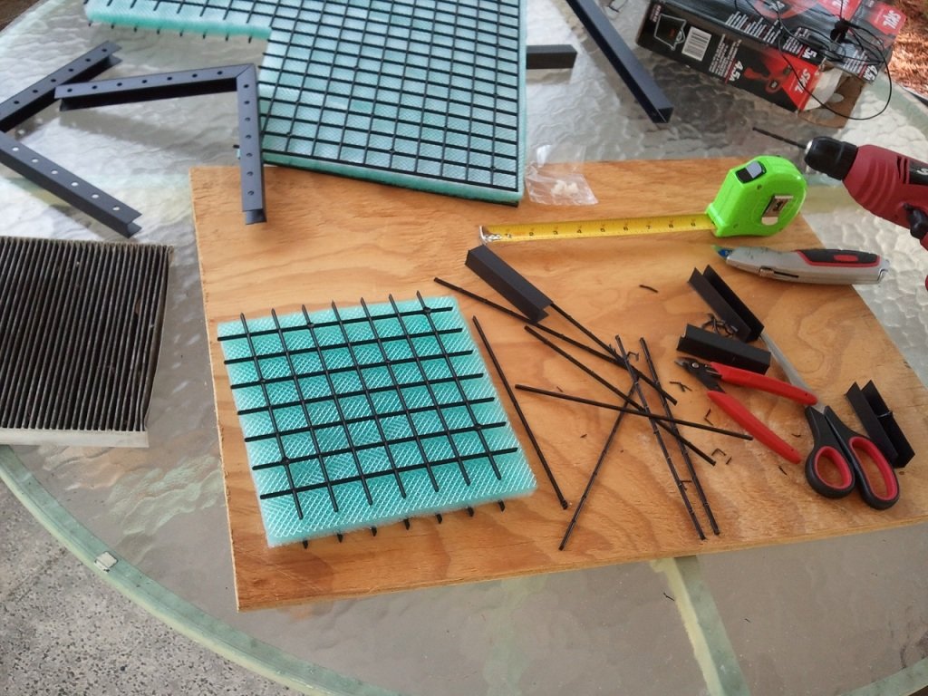

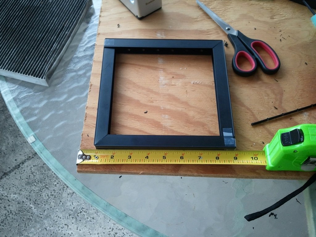

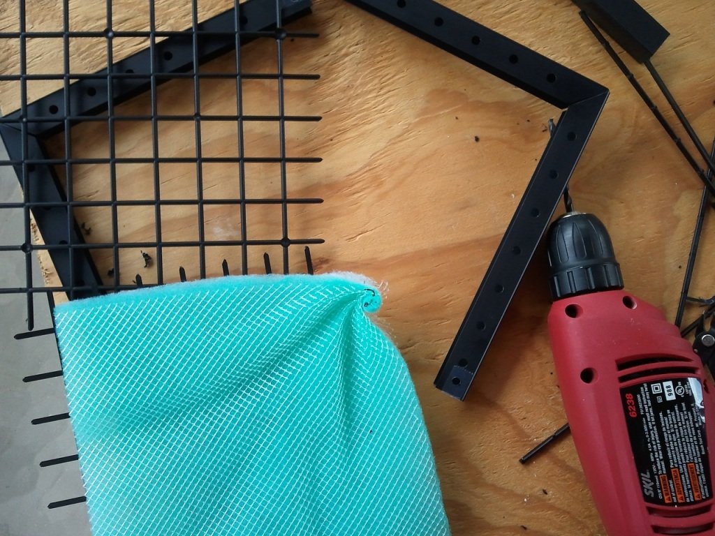

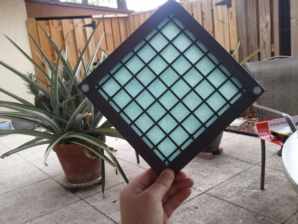

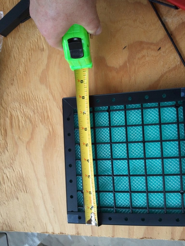

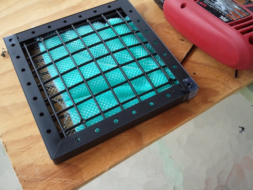

    Since I had time to kill, and, when compared to the others around here least, 9 left thumbs and the hand-eye coordination of a sotted baboon, I figured I would post some pics regarding my time assembling this little DIY treasure.
    Some points I will make, so that other may avoid suffering as I have have suffered (mostly by being a nine-left-thumbed putz, as noted above).
    At first, this looked fairly easy, as noted above. However, over the course of two hours and ending up making the damn thing three times, let me point out some things to avoid along the way.
    First, while you have a bunch of screen and plastic mesh, you only have one set of small side rails. Measure twice, cut once my rosy red ass. Measure three times, cut once, and still spend twenty minutes trimming all four sides until it's perfect.
    Even if you cut it perfect, it'll be too big the first time. And, when it's just a little too big, it'll get stuck. Then, when you're trying to get it out, the back edge of the dash rail (that's deceptively sharp) is in just the right place to rip a chunk out of your finger while you're trying to lever the damn thing out.
    Then, if you're like me and not paying QUITE enough attention or not thinking ahead, you'll get this far in the assembly process and grab your drill (FYI, the 3/16th bit is the perfect size for these rivets) and go to town. Don't do this. Here's what happens when you do:
    Also note that, with my 2006 regular cab, the filter box is too small to use the 'outsides' of the 8 X 8 grid. I had to cut them off of all four sides to make the whole thing small enough to correctly fit:
    Then I had gotten the whole thing together, it measured perfectly, I reveted it, it was so pretty...I took it out to the truck in the parking lot and...about a 16th too big all the way around. Start over!
    So, after two hours and throwing away the ruler, I went "by eye" and fitted it with scotch tape until the rail assembly fit in the dash perfectly, THEN trimmed the grid and the filter material to fit THAT.
    Bang. This time the whole thing came together in about 6 minutes, and slid effortlessly into the dash like it had been there the whole bloody time.
