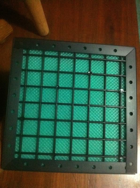

    Just got mines done today. First time fits like a glove haha
    CE5B62BD-95CC-4760-B1D2-2B39B80C72C6-104_e438b2d6fb7903da9541964008db79aa6a2ccd99.jpg
    Replaced this filthy thing.

    Thanks for the write up. I went to Home Depot and purchased the adjustable air filter yesterday and completed the project within an hour. Actually less than that because I made 2 sets in that time frame. I didn't want to throw away the extra material, so I pulled my wife's filter on her scion xa and made a replacement for her car as well. Good deal! $18 filter from Home Depot made me 2 washable/reusable cabin air filters for my tacoma and a scion xa.

    Yep, great write-up & great comments from others who have also done this DIY mod. I bought the filter from Lowes yesterday and it was still $20. Spent maybe 30 minutes this morning to do the cutting & it fit perfectly the first time. Just a slight resistance as it was pushed in. I did cut about 1/8" smaller than the 8"x8" recommended by the OP.
    Our new Toyota cabin filter was totally full of dust after only two off-road excursions earlier this summer. I knocked out a pile of dust, but it was still very brown & dirty looking. I'm looking forward to just rinsing off this new one. Money well spent.

    Cut 8x8, didn't work. Trimmed more, didn't work. I ended up slapping it in the truck without the frame. Works fine this way too

    I did the mod today (thanks again 05Moose). It took me a couple of tries, but my filter was under 8". I kept test fitting the frame and finally got it perfect. I just hope I can get the thing out to clean it!

    Attempted to make this last night... had to revisit the drawing board 2-3 times before i got it to fit.
    i have a 2013 and had to cut it down to a little under 8" for it to fit. also the border on the filter is thick so i know i am going to have a sweet time getting it back out. (problems for a later date)

    I did it by the book and it was a pain getting in and out.
    I ended up not using the frame and just using zip ties to hold it together. Doesn't look as good but functions, IMO, better.
