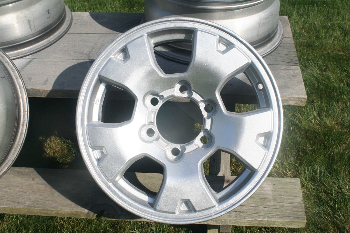

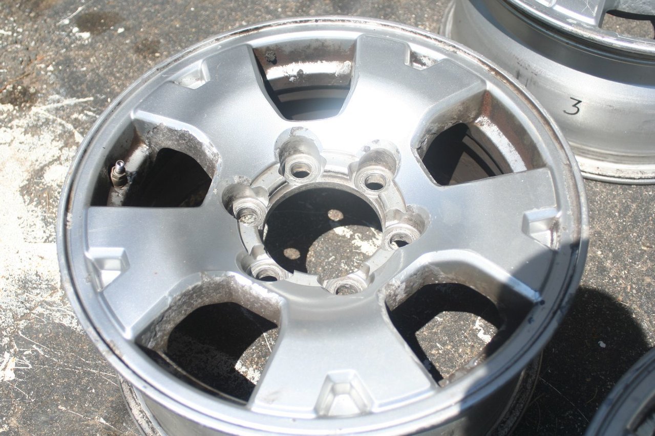

    I wanted Aluminum wheels for the truck - my steelies are rusted and flaking and basically look like crap. I found a used set with tires - the tires fell off and I gave them to my shop and asked they go to the needy (They sometimes get the "broke student" down on their luck types and sell used tires cheap - truly good Christians)
    I went and got a quote from a local refurb shop - they wouldn't touch them. WTF...OK now what.
    Research and figured a plan - then set to it.
    Time budget:
    About 24 man/hrs total - I didn't track it to the minute but over the course of 4 sessions I washed, scraped, wire wheel, sanded, cleaned, primed, backside color, color. I need about another hour or so for clearcoat. It's not a pro job so I took my time and relaxed. Figuring out what wheel and paper I needed took some time too.
    The cleaning, sanding prep before paint took the most time.
    Materials:
    small wire wheel on a die grinder - I have an air compressor
    220 wet/dry paper - get 3M brand - the HF stuff crumbles when wet, clogs when dry
    scrapers of various types - 1/2" flat was most used.
    degreaser
    soap and water
    denatured alcohol before applying any primer

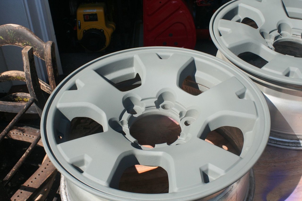

    paints:
    self etch primer - 1 can, 2 coats each
    primer filler - I didn't use this but wish I had - I got a 5 foot finish without filler. 1 can

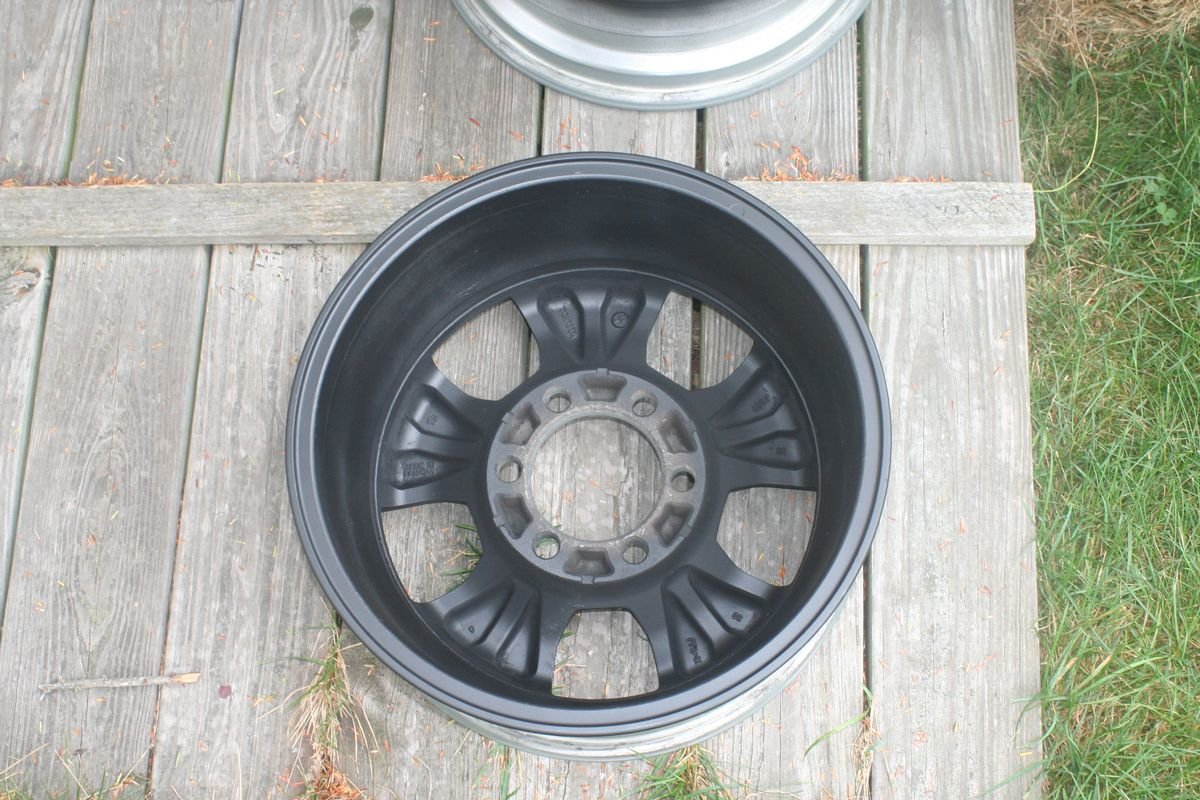

    flat black paint for the backside - 3 cans for 2 coats
    Rustoleum High Performance Wheel Steel color - 2 cans with left overs - matches center cap exactly
    clear coat - I only plan to use 1 can worth because it's 2x coating according to can.

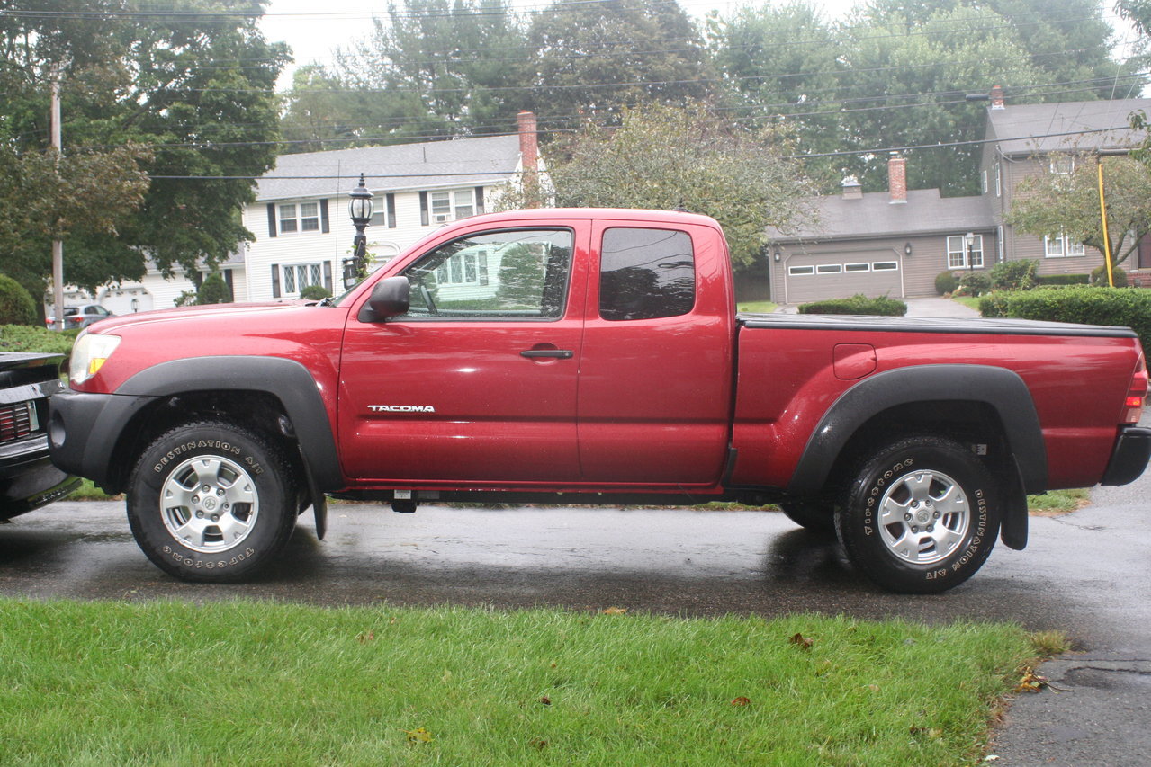

  13. Sep 24, 2017 at 5:09 PM
    ImpulsedComa
    ImpulsedComa Well-Known Member
    Nov 23, 2014
    #142965
    494
    NJ
    05 Double Cab 4x4 SR5 V6
    pics on the truck?
    gunn_runner likes this.
  14. Sep 26, 2017 at 5:37 AM
    Sprocket
    Sprocket [OP] Well-Known Member
    May 12, 2017
    #218835
    366
    In the rain - I can get a dry pic later if desired
    OK - Here's the summary:
    I should have used a primer/filler for at least 1 coat and taken my time to double check the sanding process before the primer process - found a couple things I could have done better.
    I should have waited a week for the paints to cure but I rushed it and got what I deserve. Only 1 wheel was bunged up badly during the mounting process and was scraped during transport so I won't blame my mech. I'll touch it up shortly but re-work could have been avoided.
    The lug nut scramble was on me as well because I didn't think about it so learn from my other mistake. Check your nuts if you're going from steel to alloy!
    I have more time than $$ invested in this project - the powder coat guys want a much higher prep level than what I did and their cost out weighed using this wheel set for me - buying new aftermarket wheels would have been a better choice.
    Also, I'm not sure why exactly but these wheels have a lot more weight on them than my steelies - However, my vibes are gone - like not there anymore gone. It rides like it should and I'm not fighting to control at highway speeds. I suspect one of my rims was damaged and causing the vibes.
    Budget totals:
    rims = $50 each at a junk yard
    materials = $150 or less not including the die grinder I bought, tools are an investment. The paint and sand paper are the consumables for this one.
    Like all the posts say, take your time, double check and be fussy while sanding. Once the first coat goes on, check again and make adjustments as needed. The overall end product will be worth it.
