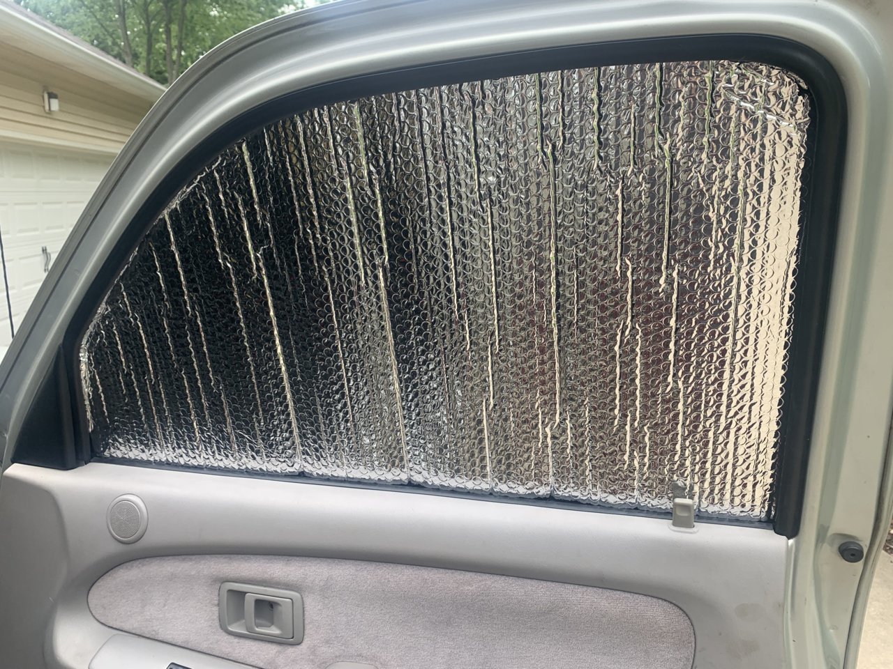

    I made sun shades for my Tacoma many years ago, and they were starting to look a bit worn. With the summer heat in full effect I decided I wanted to make a fresh set. So I traced the old ones, scanned them and cleaned up the lines on my computer. After a few revisions I compiled the scans into PDFs and have them ready to share.
    The attached PDF templates are for the two side windows for an Xtracab and the rear window. To make a set, you'll want to use a roll of Reflectix at least 2 feet wide, this is the one I used: https://www.lowes.com/pd/Reflectix-...ive-Roll-Insulation-24-in-W-x-25-ft-L/3011904
    You should need less than half of a roll.

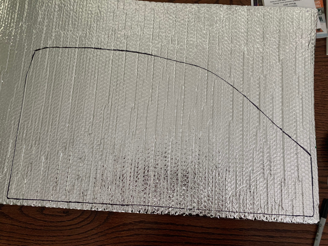

    Print the PDFs with no margin or as small of a margin as your printer will allow. Tape the pages together, and then cut out along the lines. Trace the template onto the Reflectix, and then cut it out.
    The windshield is tricky, and I don't have a template for it. But if you cut a 52 inch length of 2ft wide Reflectix and adjust the corners to your liking you'll be close.
    These shades are meant to be tucked into the gap between the window and the body, they should provide a tight fit. If they are too tight you can trim them down. They aren't magic, but they help keep the interior surfaces cooler on hot summer days, and should help protect the dashboard and plastics from UV damage.

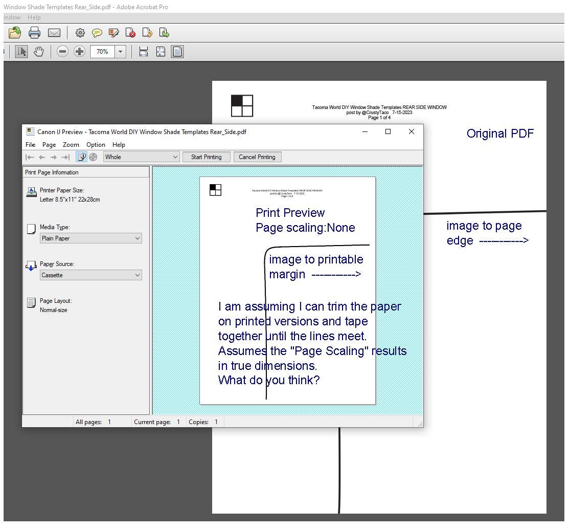

    This is as small a margin as I can print. Take a look, @CrustyTaco and let me know what you think.

    Should be fine, my laser prints with a similar margin. Tape together the full 8.5 x 11 sheets, connect the gaps between the lines, cut it out and give it a test fit.
