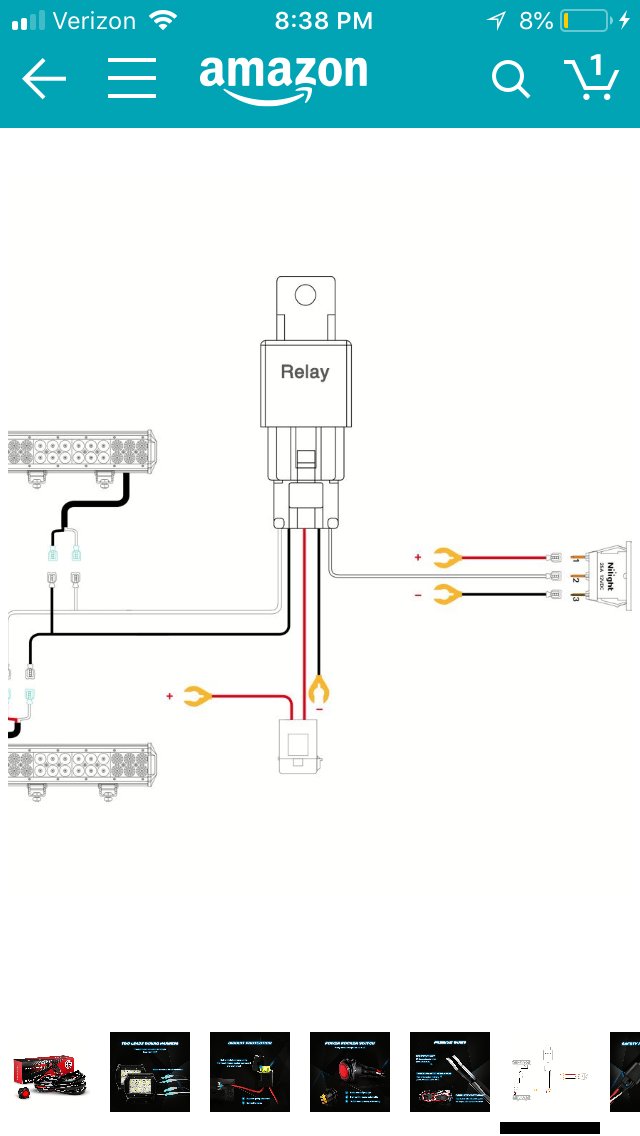

    I ordered a wiring harness off Amazon has to relay built in and the fuse all together just got to run positive from the switch to some kind of power source . It says 25 amp on the switch where I’m confused is it’s telling me to run the switch to the battery . I want to tie it in to the fuse box but it’s all small fuses and there’s a 30 amp and a 20 amp . Now the fuse that’s on the harness is that the one for the switch and is it as simple as putting the power wire off the switch to anything that has power in the fuse box I’ve got the relay ran from the battery so I’ll post pic tomorrow what I’m dealing with and maybe y’all can tell me how to run power for the switch

    Please lay out the harness so we can see the wire labels and how they run.

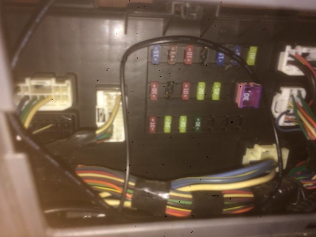

    I have a pic of the fuse box will post more when I get off work

    Fuse at poc bottom center supplies the main light bar current, fuse to switch supplies only switch led current(illumination~10-50mA)) and relay activation current (~100mA).

    Should I use a micro fuse tap I noticed I have small fuses but the picture you have looks like a reg fuse tap ?
