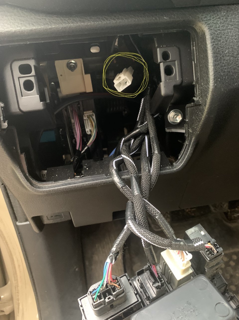

    Anyone know where I can find plug and play male plug for this white receptacle? It is for the dimmer circuit tied into the headlights. The female was just hanging there so I thought if a can get a matching plug could use as dimmer for multiple add on switches. It only has the one green wire in a 5 prong plug. Located left of steering wheel.

    Part number for the terminal/wire
    82998-24380 or 82998-12340

    Not particularly. Member Havoc showed me something I hadn’t known before in that each oem switch is wired to these two dash light junctions and that rather than using T-taps or buying expensive break out harnesses you can diy with these terminals and some wire or plug/play with terminal repair wires. Just spreading the news a bit.

    I am definitely not using t-taps that’s for sure. Thanks for the info!

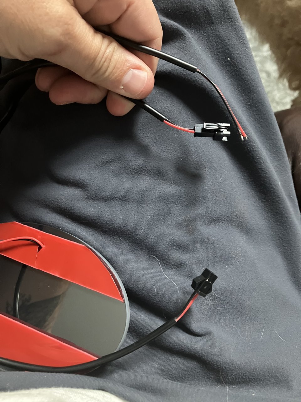

    Hello,
    First post please be gentle. I have a 2012 Tacoma SR5 4x4. I bought an aftermarket Toyota LED emblem that lights up. I would like to have it on with just the two front end yellow lights that stay on all the time. Not sure if these are considered DRL or not. Am I able to splice in from the very front of the vehicle? I am attaching an image of what the company Aoonu.com gave me. Any assistance is greatly appreciated. Thanks!
