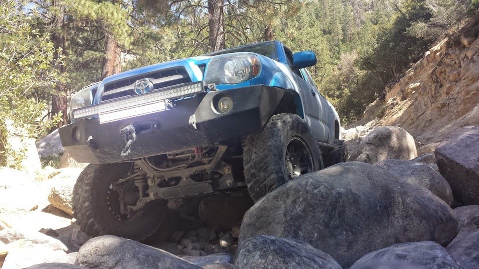

    My number one question is if you wheel hard IF so don't do it.
    Here is what i have done with my 6 inch lift.

    Curious how a 3" would be better in this pic?
    I think the Pro Comp coilovers make u extra biased:p
    :confused:
    Only place a 3" lift could have more clearance than a 6" is under the front diff.
