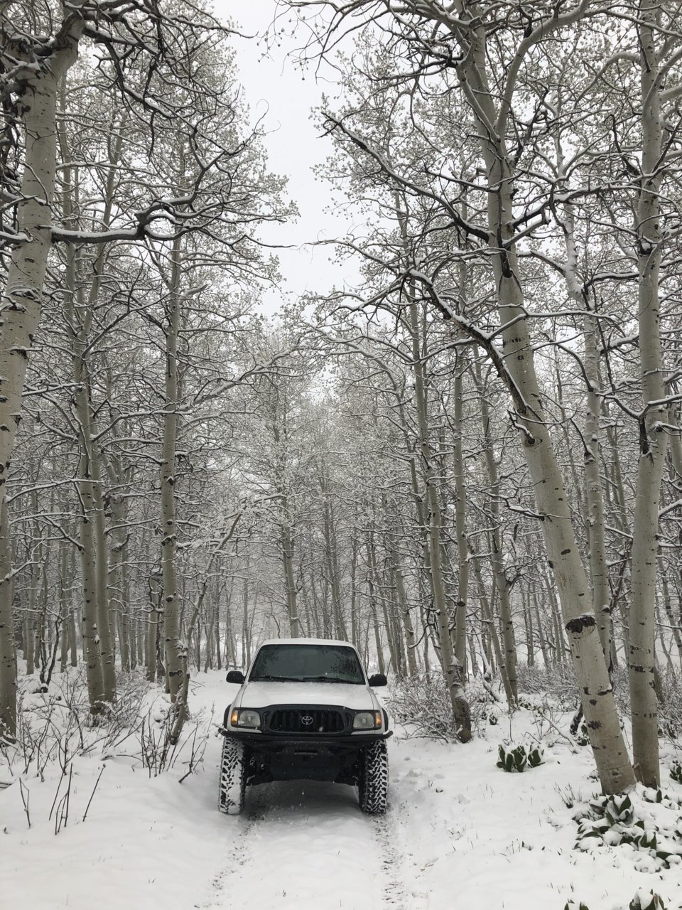

    My first Tacoma was a 2nd gen double cab, which was alright at first but I grew to despise it. I've always loved Toyota 4X4s but the more they change their trucks to fit normal American preferences, the less I like them. I got addicted to awesome 1st gen regular cab builds from @Jiveydude, @Ritchie, @allenfab and @cdj1. My incurable lust for these utilitarian little mules meant that the 2nd gen had to go and "Whitey" came into my world.
    Our first day:
    Recent:
    Exterior:
    -El cheapo ebay TOYOTA tailgate decal
    -El cheapo used aluminum shell
    -Junkyard sourced OEM sliding rear window
    -Painted cab pinch welds black (AKA instant 3/8" lift)
    -Relentless Fab aluminum tailgate reinforcement
    -Relocated turn signals:
    https://www.tacomaworld.com/threads/01-04-blinker-relocation-mod.305152/
    Interior:
    -Dynamatted cab
    -Uniden CMX560 compact CB
    Wheels & Tires:
    -1st gen spare steel wheels
    -Yokohama Geolandar MT 255/85r16 tires
    Engine:
    -NAPA Platinum AGM battery
    -New spark plugs, water pump, drive belts and coolant
    -Custom starting/charging system 8GA cables with 130A alternator and military-spec battery terminals.
    -3RZ deckplate mod:
    http://www.toyotanation.com/forum/79-1st-generation-1995-5-2004/386372-deck-plate-mod-my-2-7l.html
    -Wiper fluid reservoir relocated to engine bay:
    https://www.tacomaworld.com/threads/diy-wiper-fluid-reservoir-relocation-for-1st-gen-tacomas.441906/
    -Flowmaster 50 muffler
    Chassis:
    -4:88 gears
    -Front & rear Harrop e-lockers
    -Old Man Emu 880 coils/Dakars/greaseable shackles
    -SPC upper control arms
    -True North Fabrications skid plate
    -BAMF LCA skids
    -Sonoran Steel diff drop
    -Toytec steering rack bushings (yuuuge difference)
    -Marlin Crawler shifter bushing kit
    -CBI Off Road frame reinforcement plates
    -Sky's Off Road spring hanger reinforcements
    -Stubbs Welding HD-SKO rock sliders
    -Trail Gear front bumper, reviewed here:
    https://www.tacomaworld.com/threads...ow-profile-bumper-for-1st-gen-tacomas.441752/
    -Rear diff breather mod:
    https://www.tacomaworld.com/threads/differential-breather-mod-for-dummies-pics.15686/
    ADD to manual hub conversion:
    https://www.tacomaworld.com/threads...or-the-1st-gen-tacoma-3rd-gen-4runner.460180/
    -Wheeler’s Off Road extended rear brake line
    -PlasticsGuy Durobump bump stops
    -Deleted ABS and LSPV garbage
