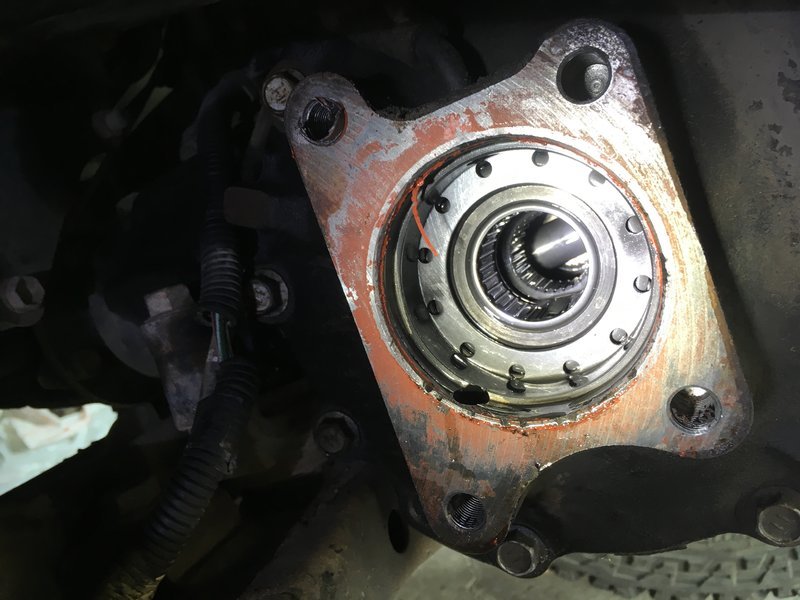

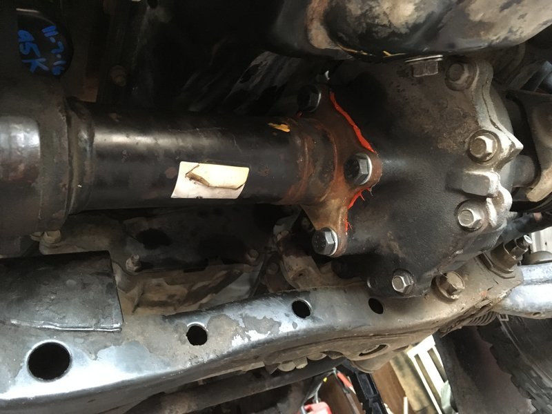

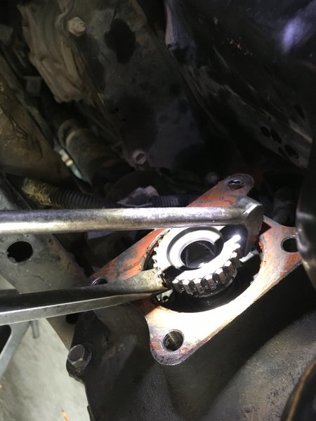

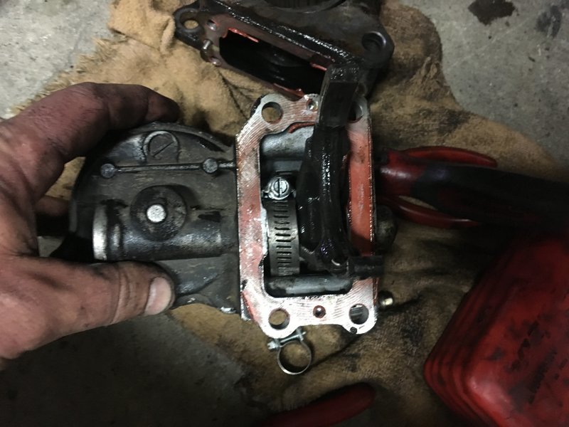

    Quick helpful hint for next time you convert a first gen to a manual hub set up: you can actually modify the add diff easily to make it work with manual hubs. On the add actuator, just put a hose clamp on the sliding fork, to keep it fully locked. Then, cap off the vaccuum lines. Boom, manual diff.
  9. Dec 17, 2016 at 9:05 AM
    #69
    DJB1
    DJB1 [OP] Well-Known Member
    Jun 8, 2013
    #105835
    2,222
    Dave
    SLC, UT
    2003 Regular Cab 4X4 5MT
    I'm on to your way of thinkin'
    I did it that way first before I realized this gear-thingy can be popped out of the front diff.
    But my donor parts included a non-ADD axle tube so I felt compelled to use it.

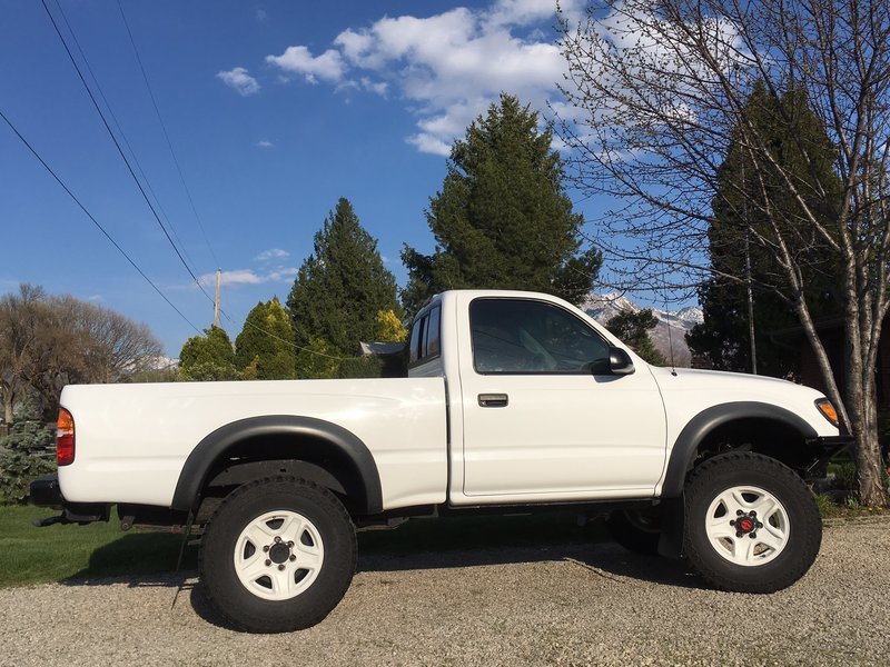

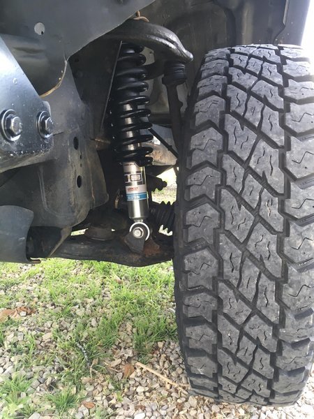

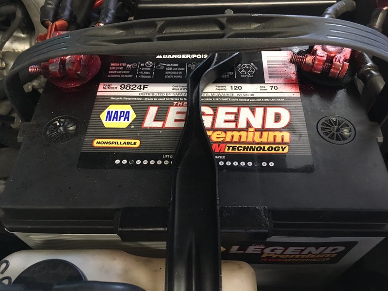

    The battery fairy brought me a new NAPA Legend AGM battery. It was cheaper than an Optima and rated higher by Consumer Reports.

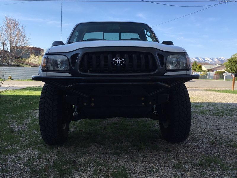

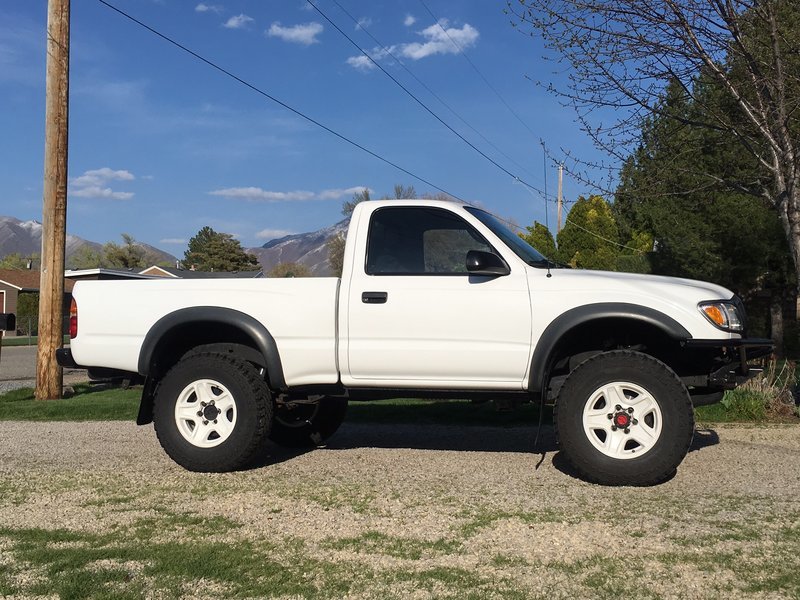

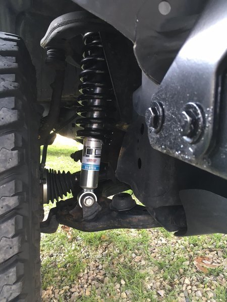

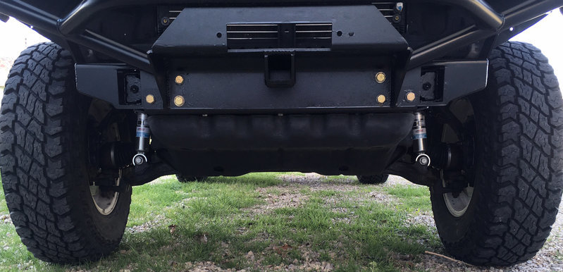

    Whitey had worn-out shocks and a bad case of taco lean so it was time for some OME 880 coils, Bilstein 5100's front & rear, and Toytec adjustable shackles. Thanks, @Wheeler's Off-Road, Inc! Of course, I didn't take before and after measurements because I was only focused on correcting the lean in the short amount of time I had.
    On the front, I have the Bilstein 5100's set at the bottom setting with a 3/4" rubber coil isolator on the driver's side to compensate for the lean. I did it that way so if the 880 springs settle too much or if I get a winch, I have multiple ways to adjust the ride height in front.
    CV angles are a moot point because I planned ahead and already have manual hubs. Planning ahead also means the Detroit TrueTrac for my rear diff will be stored in my tool box a while longer while I save up for a front TrueTrac and install them both in one shot.
    I'd eventually like to replace the leaf springs but the stock ones aren't frowny yet so I can postpone that for a while. I installed the adjustable shackles with the driver's side 1/2" higher than the passenger side to help correct the lean. These Toytec shackles are so much beefier than the stock shackles but they arrived in a most obnoxious shade of gold. I painted them flat black before the install and now they look very discreet.
    Yay! No more taco lean.

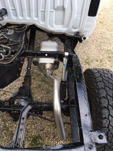

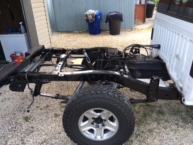

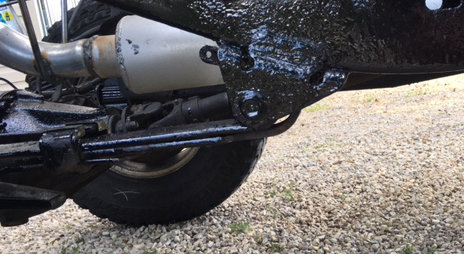

    The last few days have been a maintenance marathon in 100° heat. I cleaned up some surface rust, welded on some @CBI Offroad Fab frame reinforcement plates and slathered on copious amounts of POR15 and Fluid Film. Hopefully that will address the only known weakness of the 1st gen Tacoma, frame rot. I couldn't have done it without the kind assistance of my neighbor & regular cab aficionado @Jiveydude. Thanks again, I owe you a beer and a cheeseburger (I recommend Proper Burger Company).
    The 14 year old OEM muffler was splitting apart, so I got a Flowmaster Delta 50 based on @tooter's 2.7L dyno results. It's got a deep mellow tone like Barry White, without much noise or drone. A nice bonus is that it doesn't hang below the chassis like the stock muffler did.

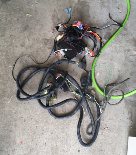

    I exorcised this towing harness and non-working alarm system. In the name of Jesus, demons begone!
    I just hit 100,000 miles so it was time for new lower ball joints. It's a quick, easy job if you use a pitman arm puller instead of beating the shit out of them with a hammer. It took longer to find the correct part numbers and torque specs than it did to replace the parts. So here is the pertinent information:

    Hey Chad, it's 38 1/4" from the the ground to the bottom of the front wheel well. I have the shocks at the lowest setting (least spring preload). It rides darn good, not too firm, not to squishy. I think with the tires aired down a bit it will be dreamy on dirt roads. I'll find out in a few weeks when I go camping. I had to remove the sway bar though. It rode really firm with stock suspension and sway bar. With OME coils and the sway bar on, it was like a damn buckboard wagon. Now I get it; sway bar + lift = no suspension travel.
